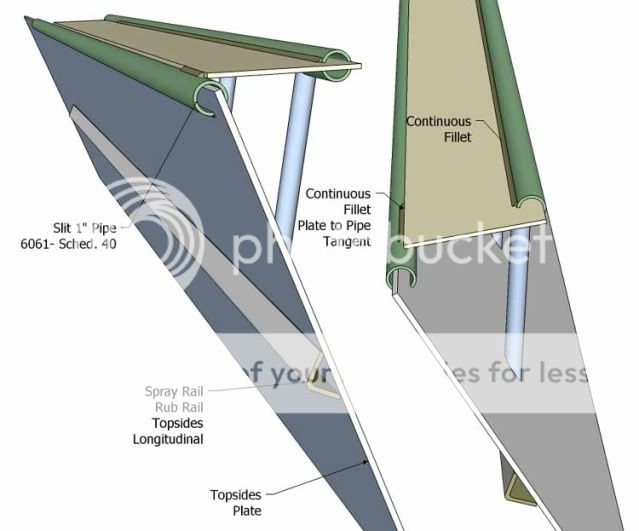

Travis, while drawing I realized I had some sketches already done that will work as an example of a few methods to discuss.
Shown above, this sketch uses 'slit' pipe where a saw is run the length of the pipe to open a slit to push the pipe onto the edge of the topsides. I realize your boat's deck is not as shown, this is to explore slit pipe edges.
Image another sheer lining technique is to use a 1/2 of a pipe extrusion- as mentioned before you buy 2" and larger as finished extrusions saving the labor of splitting the pipe with a saw. However for the smaller diameters splitting the pipe with a saw is the only way to get this 1/2 round hollow shape.
These both provide a rub rail but only the shape above the deck line will provide any kind of toe rail. So, that decision is important to make first- smooth to the edge or something above the deck's line? Then the other decisions can follow.
