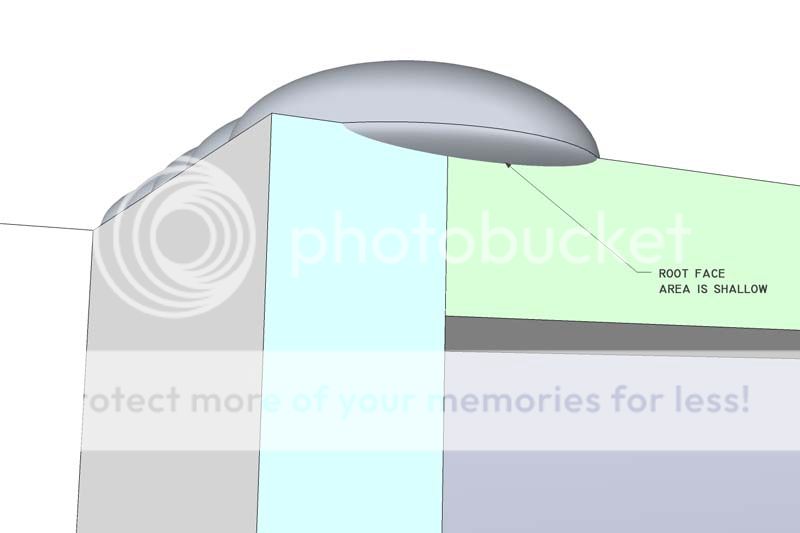

Chris, the TIG weld shown has a few problems that could be remedied by #1 joint prep and #2 weld technique.
Here (above) is the first image of the type of joint that appears in your photo. Square extrusion in my image is butted to another square extrusion and then I cut them in half to show the welds- lack of penetration. I realize your mitered butt joint is not identical but this is as close as I have already illustrated.
I'd call your attention to the bead's profile- it crowns up high and the two edges are not flowing very well into the parent metal, that indicates the weld is somewhat lower amperage than needed to fully fuse the parent metal.
Above is an image zoomed in on the edge of the cut down the middle butt jointed square extrusions, noting the shallow root penetration ; INDICATED by the overly rounded Upward crown and the not fully flowing edges of the weld.

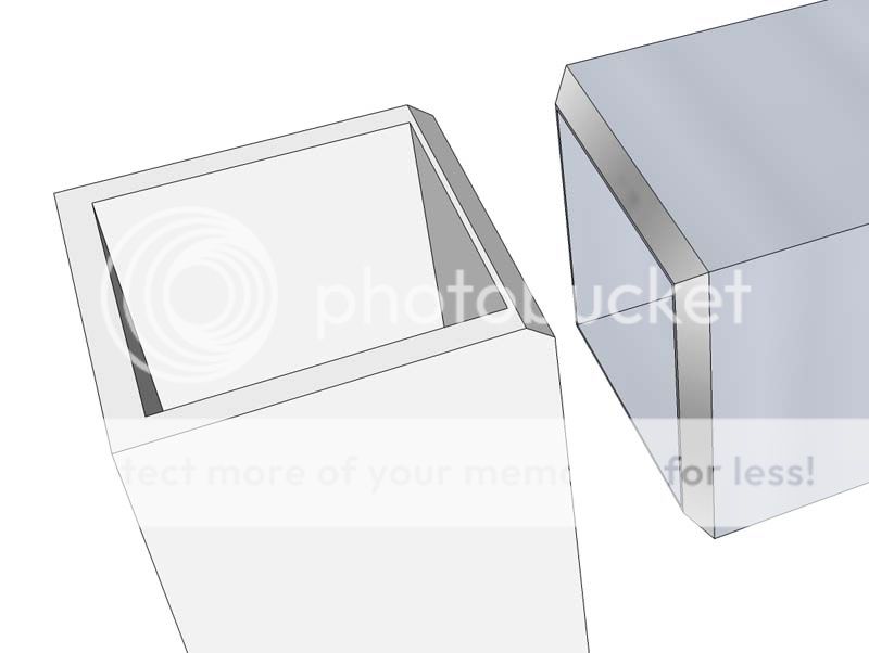

Without any welding, this image shows that a bevel on this type of joint will allow the weld to begin deeper into the parent metal AND the thinner edges of the beveled extrusion are less metal to melt- so the weld can be performed with a lower amperage power supply that may not fully fuse a thicker section of aluminum?

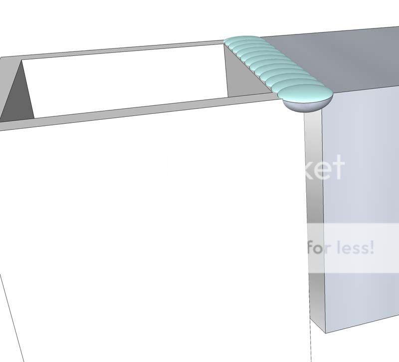

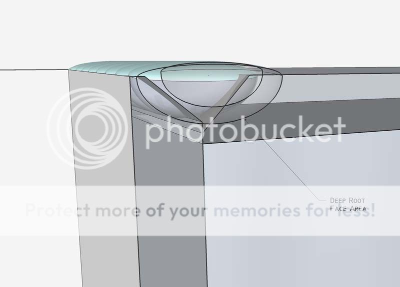

IN this image of a weld added to the joint area prepared with a beveled edge the top of the weld is much less crowned- in fact, the weld could almost be considered upside down, by comparison to the higher crown, less fused welds above on the unprepared joints.
Finally, in this series of images discussing TIG welding extrusions in butt jointed assemblies (even mitered butt joints) I'm showing a pair of beads in cross section. The smaller bead is recessed into a beveled joint preparation, and the large is just a deeper version, both welds have relatively flat crowns, are deeply penetrated into their parent metals and have filled the mechanically cut bevels with weld metal fusing to the sides- no building up on top or highly crowned above the parent metal.
Chris, this bevel method will also give a nice edge along the joints to tract visually while adding these welds helping to give your welds a better line while you're added the filler and moving the torch.

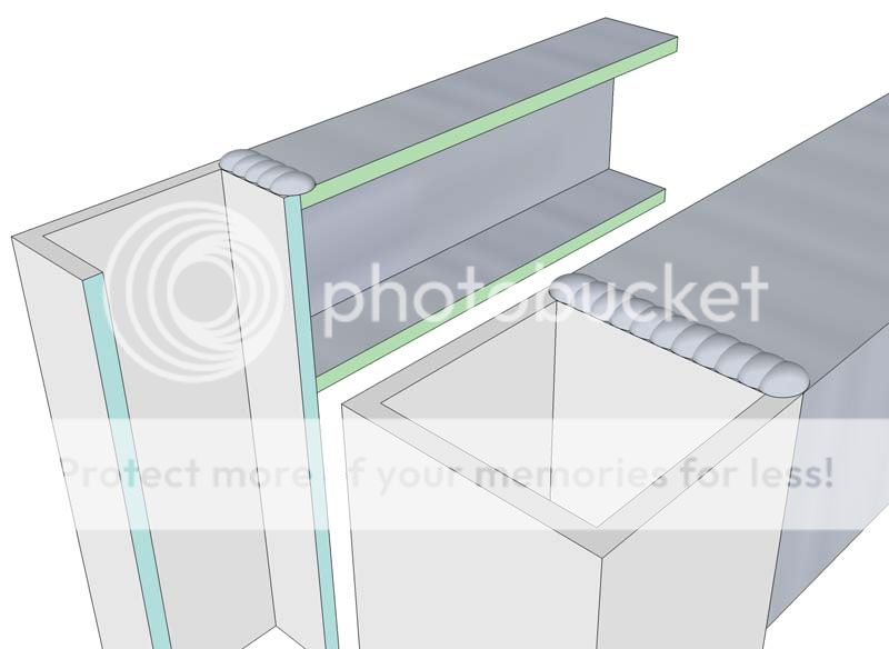

This tank top shows TIG welds where each different weld has room for the weld; a V, or a Lap, or a Gap to Fill allowing the welds to reach down into the parent metal regardless of joint type. This allows the welder to 'see' the top of the puddle and to more uniformly control the appearance of the weld, while following some line, next too the puddle. On the tank top edged to edge, I could follow the plate edges, while on the thickener plates/doublers, I could follow the edge of the plate, and on the pipe couplers I could see the gap between the coupler and the doubler OR... I could follow the top edge of the coupler depending on how that joint was set up.
Practice is a very good thing... and critical to weld improvement but practice stands on the foundation of "joint preparation"- I'd say if there is no good prep (?) there's no reason to weld. I consider correct prep and joint design that critical.
