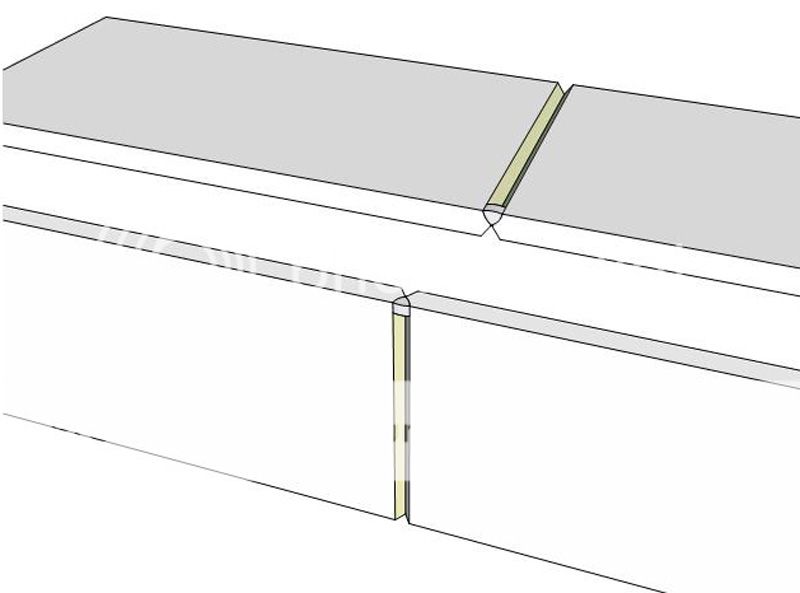

What is it that we want to remove? We need to bevel the edge to make #1 a larger root face for the weld; #2 less metal at the edge of the plate to melt in fusion by the weld; #3 Mechanical penetration by removing parent metal (green or yellow edges) so the weld can reach deeper into the plate/sheet with less amperage.
This sketch (above) shows the two marked areas (by four strokes with the marker held as shown) and the left side shows the edge with the bevel cut.
Above, the two bars in this case, are both beveled for a butt joint double sided weld. (The edges are shown yellow on one side and green on the other to reduce the countless shades of gray of the aluminum bars.)
Typically this type of joint would have clamping, stiffeners, and or other support to help keep the two pieces flat to one another while the two welds were added.

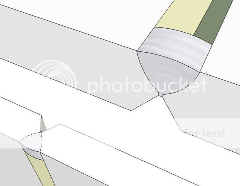

The sketch above shows the weld (beginning or ending) in cross section as one side first. This image includes a very key but small detail seen in the next image below.
Here the weld is zoomed in closer so we can see the main features that you'd need to be sure occurred in your own welds. First the weld in this case on a 1/4" bar is only about 1/8 (plus very low crown/top/bulge above) so each side is a single pass weld. The second item is that the first weld has a bulge or penetration into the unwelded side's V beveled cut out.
This small penetration is key to your understanding of the bevel you cut compared to the amperage and wire speed of the weld (MIG Al weld). If the weld is not penetrating in this rounded bulge line? #1 the weld is too cold or #2 the bevel is to narrow and needs to be 'widened' or the angle of the bevel has to become greater so the beveled 'tip' of the bar is sharper. A sharper cut, greated bevel angle takes less amperage to melt/fuse that thinner piece of metal.
What does this indicate? That bevels cannot all be exactly assigned until the welder's settings, wire size, amperage and travel are tested on that particular bevel. Once a builder has performed several dozen tests, he will be able to find his correct version of the bevel angle, the bevel 'cut back' (shown above with a marker in green) and that will correlate with the welding settings (keep a notebook or go nutz!) that were used to make successful double sided butt joints.

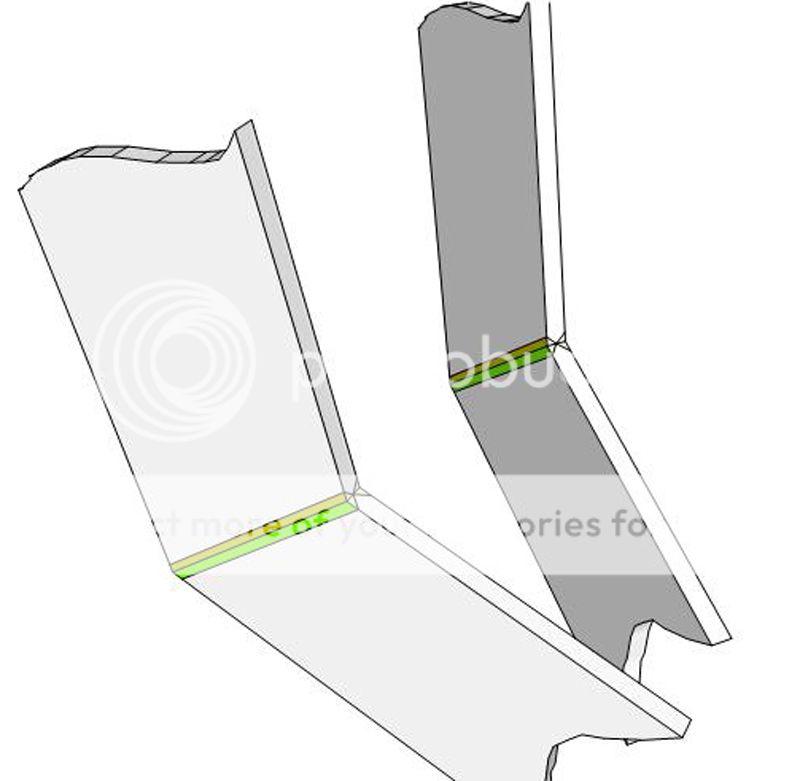

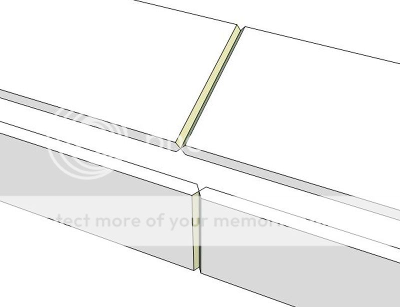

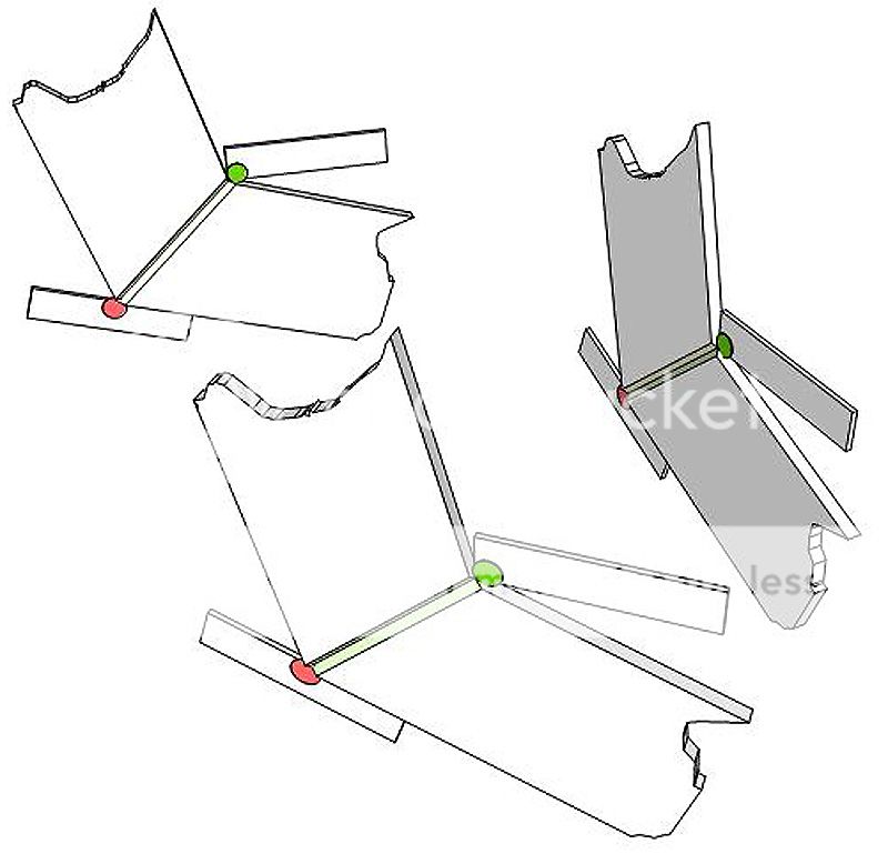

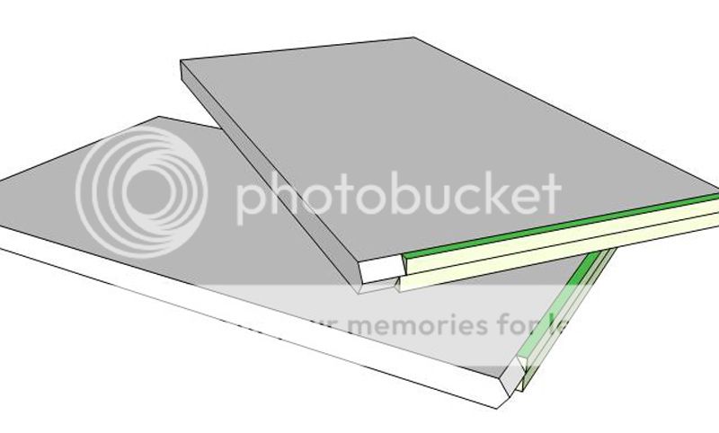

Above are two 1/4" x 4" flat bars like we might see at a chine ( the miter joint is NOT always used!!!!) Let's call the lower right bar section the " bottom frame bar"that lays on the bottom of the hull from the chine to the keel. That makes the tip of the two bars the chine and the left hand bar is the topsides (side frame) element of our hypothetical transverse frame.
The first job is to put the template (if you have one) onto some plywood, or some aluminum and mark the locations of outline of the frame. Now these two bars are called for as the two port side frame pieces, the keel would be to the right out of sight in our sketch. The sheer up the topsides is out of frame to the upper left and we've just cut the two bars so the joint between them allows both bars to lay on the work template so each frame piece fits the outline of that frame.
But the weld is not ready to put in- because we don't usually do surface welds with WAB welds.
recalling the first few sketches above, we can see how to mark the metal that needs to be removed from the miter cut ends of these bars- the areas here in green and yellow. We'd use the marker technique above but.. a combo square and marker will work as well, it just takes longer and the marker's ink can 'run' under the blade of the combination square and have to acetone wiped off and remarked.
Above are three views of the joint with a cut bevel and two extra bars. These bars are 'run on' and 'run off' bars so the MIG weld can begin and end off the final joint's weld zone.
A the weld tacks are not shown, but one tack would be at each end of the weld bevel, the tacks would be dressed down to the minimum remaining metal to hold the two bars for final welding. The rotary carbide burr or the meat axe are tools that could be used to 'dress the tacks' and reduce them to avoid cold spots or excessive contamination in the final weld's root near the tacks (not shown.)
At the green circle (start) the weld is initiated OFF the main bars and then welded to the Red (stop) OFF the main bars. Both the start and stop are performed off the main part to welded. The Run Off Run On bars are simple snapped off the part when the weld's cool, the welds are done both sides one after the other as soon as the part can be turned, while it is hot from the first weld.
The best way to 'finish' the broken weld bead on the two edges if with a TIG torch but it is not needed, the welds will remain full strength without TIG floating but it looks nicer to TIG float.
The outside corner of our hypothetical frame's will eventually be cut to a 'mouse hole' or a small radius cut out so the frame's bars do not block the chine weld when the two panels are joined in the hull welding sequence.

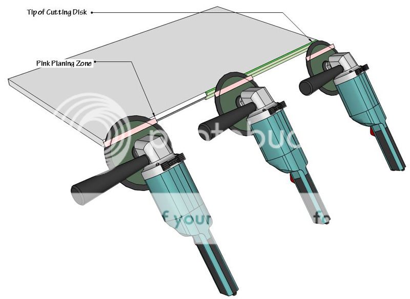

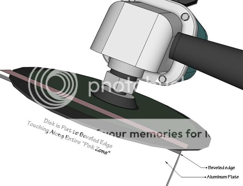

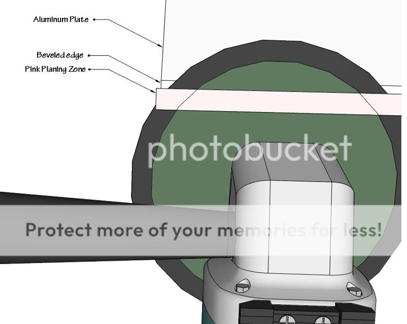

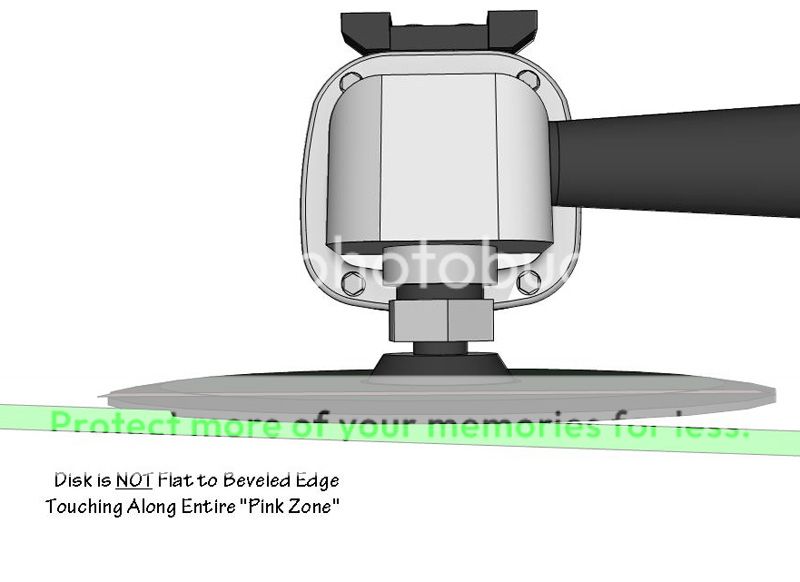

The first sketch (above) shows the same grinder motor with a large size (7") wheel mounted. That wheel could be either a hard wheel, or a sander type. We expect most sander disks to be more flexible than a rigid hard wheel but that flexibility is relative, these sanding disks are made of different thicknesses and hardness so their flexibility differs.
In this image the three tools are positioned to bevel the edge and all three have a "Pink Zone" shown on the back as a reference to our discussion.
Zooming in on the first or left most grinder's pad from the top of the motor, the Pink Zone is shown laying against the sheet edge and cutting a bevel. Its important to decide if the tool should be used as a plane or a chisel, in this first case we're using the tool as plane to take off an even angle, even lined, and even amount of the edge- to prepare an even bevel.
This sketch from the front looking back to the operator, who is not shown, confirms the key technique to master with this tool as a plane. The disk, has to be kept flat to the edge or the bevel will "wave"- if the bevel is not uniform then any weld will have to vary in width, and contraction, and appearance... well- you can see the dominoes falling of a poor tool technique- misuse this tool on a weld bevel and the mess begins. On the other hand, if used correctly, this method of joint prep is reasonably fast and accurate- it all depends on this technique being used.
However, above is a technique that needs to be discussed right along the use of the power disk as a plane; that is the use of the same tool as a chisel, or maybe a block plane. IN this image (above) the disk's edge is being used to cut the bevel , marked in green from previous posts, and the primary technique here is the need to pull all cutting strokes!
If you push and pull back and forth along a plate edge, that will almost always make the edge less even, more wavy or irregular. This technique of pulling the chisel mode for a bevel works because the tool is not going to dig in if pulled but it will try to dig in when pushed. Try it, work on technique, especially good to work with grinder edge techniques while practicing bench welding prior to the build -developing your tool skills and weld skill along side one another is great time savings in the full calendar of the project.

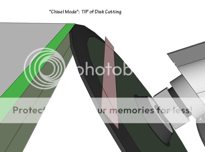

The sketch above shows the last of the three 'modes' of use of the hard wheel or sanding tool mounted to a grinder motor. This is the pushed chisel mode where the tool's outer edge is used exclusively to gouge, trim or dig out for weld preparation OR for tack dressing instead of the carbide tools shown in previous posts.
The tip edge use will come in handy as long as you're aware of the need to see this as a third method and not to confuse it with the two previous methods shown? This takes practice too, otherwise too wide cuts and gouges end up leaving a poorly prepared joint- and as I'm harping in all these posts: poor prep will lead to poor welds, and that leads to all sorts of quality reductions in your boat.

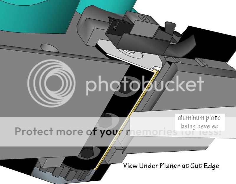

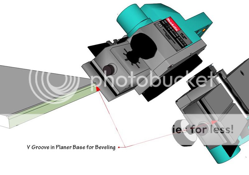

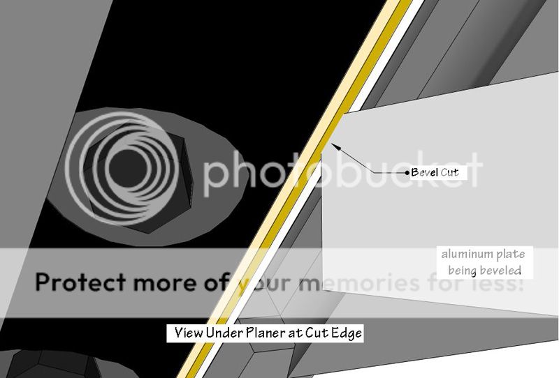

In this sketch above we're looking at two power planes, one inverted to see the groove in the base plate that the upright (left side tool image) have fitted to the square edge of aluminum plate/sheet. The groove is present in different sizes and numbers on different brands of tools; but all of them can be used to cut nice quick bevels on aluminum.
Above, the power plane's base groove is moved all the way along the plate to be beveled and the edge of the rotary cutter is lined up with the corner of metal to be beveled off the parent metal.
This sketch, of the zoomed-in cutting area, shows a detail of the bevel that will be taken off this aluminum plate, bar or sheet. The depth of cut is set by the same controls as the full width cuts, but they have to be adjusted (perhaps to the minimum depth?) for different tools being used on different thickness sheets. Testing cuts is the only way to be sure what will result, and using pan spray on the rotary cutter in the plane helps the chips to release from the edge and prolong the life of the cutter and end up with a cleaner cut. I recommend using the shop vac on these tools whenever possible- they almost all have vacuum hose attachment- and there's a good reason for those connections!.

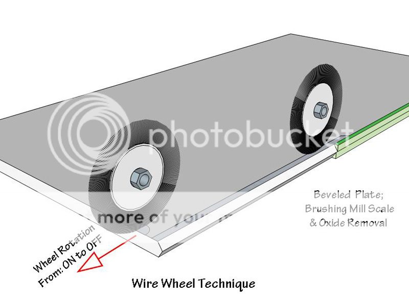

Earlier in this post we discussed power wire wheels mounted to a "grinder motor". Below I will show a link to a recommended TYPE of SS wire brush but here I'm trying to make the two primary uses clear. The correct type of brush cost is high, and they can be destroyed in a few seconds by improper use, so I'm providing a Rule of Thumb for preserving the life of an expensive power tool 'bit' and to reduce the work area hazards inherent in this type of tool.
The two wheels shown are symbols, drawing a fully pictorial model of the brushes in the link below was too much time when we can all look at a picture- so my wire wheels here may give a misunderstanding. The wire wheels in these images are place holders, not realistic images. The wires shown all radiate uniformly from the hub but the recommended type are twisted in bundles.
However the image above does show the wheels' direction of rotation is #1 to consider. The wheel used along an edge should stay on the edge fully and rotate so the tool is pulled away from the operator, the motor is not shown in either wheel above. Next, and most important for longer life of this sort of fragile wire wheel is to rotate OFF any metal edges when you're cleaning at 90 degrees to that edge.
This sketch is the same as immediately above but zoomed to show the edge of the plate material and the cleaned areas wheels. In this close up, the wheel is running so the wires land on the surface and then bend and scrape OFF the plate. If they were run 180 deg's the edge of the sheet or bar or plate would act like a knife edge and cut the wires, and then entire wheel could be stripped of the flexible wires in seconds.
http://www.weilercorp.com/standard-twis ... wire-13113 the photo in this link shows much heavier wires than the listing below in the spec.s! the size is 0.014" wires and this shows the heavier wire- probably due to the cost to make each photo of every product? However this is the wheel type that does a good job of cleaning mill scale and oxide from aluminum WITHout gouging, cutting and smearing the surfaces while you work. But the wheel is somewhat fragile compared to the longer life of the thicker wires- but those wheels will make a mess of your weld prep.

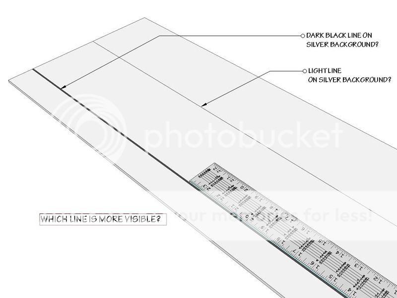

This post concentrates on marking aluminum for exact cuts and next we'll look at the actual cutting techniques I’ve found helpful too. The premise is: If the marking system is poor, the visibility to guide that cut will be less than a more exact system of marking with higher contrast to enhance visibility. More exact marking comes from a few basics of tool use including what to avoid when marking cut lines.
Contrasting colors provide our eyes better definition of a line than low contrast colors and that is the basic idea behind this work method. If you can provide a highly contrasting color scheme for your cut lines, and good line of site to the tools’ cutting edges, regardless of type, then the more accurate lines, can be followed by more consistently guided cutting tools; the result will be lines and curves cut to a smaller level or error. With fewer irregularities in straight cuts, and less fairing along curved cuts in aluminum work, overall labor to prepare to weld is reduced. Weld quality will be enhanced since the edges or materials placed edge to edge will have less varied gap, bevel, fillets to fill so more uniform welds will result.
The sketches in this section are very frustrated by the lack of photographic quality of the images. ( know I could stage some images in the shop, but... I'm trying to get to some fine details , well beyond my photographic skill set!) Generally, I’m drawing to express an idea, pictures being worth thousands of words(?) and in this case that applies with the one objection of not being able to show ‘shiny’ or chrome-like light reflection. I’ll mention this several times in the text, but still encourage you to try this method of work to prove to yourself how effective it can be. The images won't do quite the justice to the topic I'd like.
When we get to cutting entire 3,000$ sheets of metal, these techniques are needed to retain your investment but they apply to most cut lines so there will be lots of ways to practice, for example while you're practicing your welding making coupons.

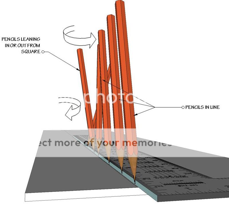

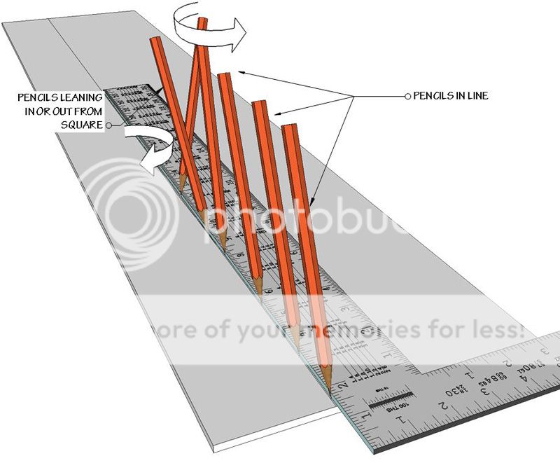

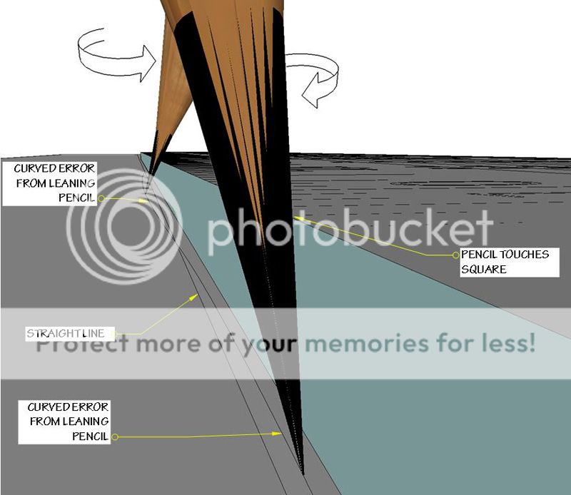

This first image (above) has a piece of aluminum being marked with a carpenter's square to a straight line and one pencil is shown in several positions along the line. The first few positions the pencil was kept evenly vertical, but as the line was drawn the pencil wavered back and forth in reference to the original position.
Moving our point of view down, more inline with the square's edge on the aluminum; the pencil's top ends are more clearly leaning instead of staying in a line.

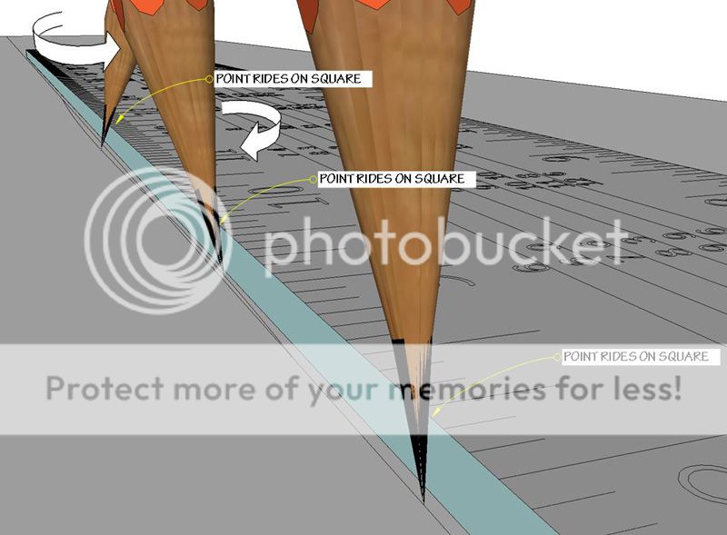

I hope this very close in zoom of the pencils' tips on the aluminum (above) is clear to the reader? ONe good reason we didn't try this with a camera! The side of the cone of the tip of the pencil rides on the square in this image and that creates a lever that can result in marking error! It may seem a tiny error but as we'll see this small lack of technique can become a welding headache or lead to extra work fairing the cut edge.
Above, the zoom level increases to show the waving line drawn by the pencil tip when the top of the pencil is leaned toward and then away from the square, this results in a line that is not square so the guide for your cut is not straight. There's plenty of variation in a normal saw cut in metal - we sure don't need to add to that error by marking a wavy line.

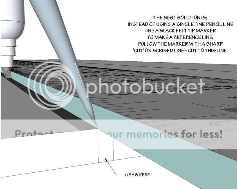

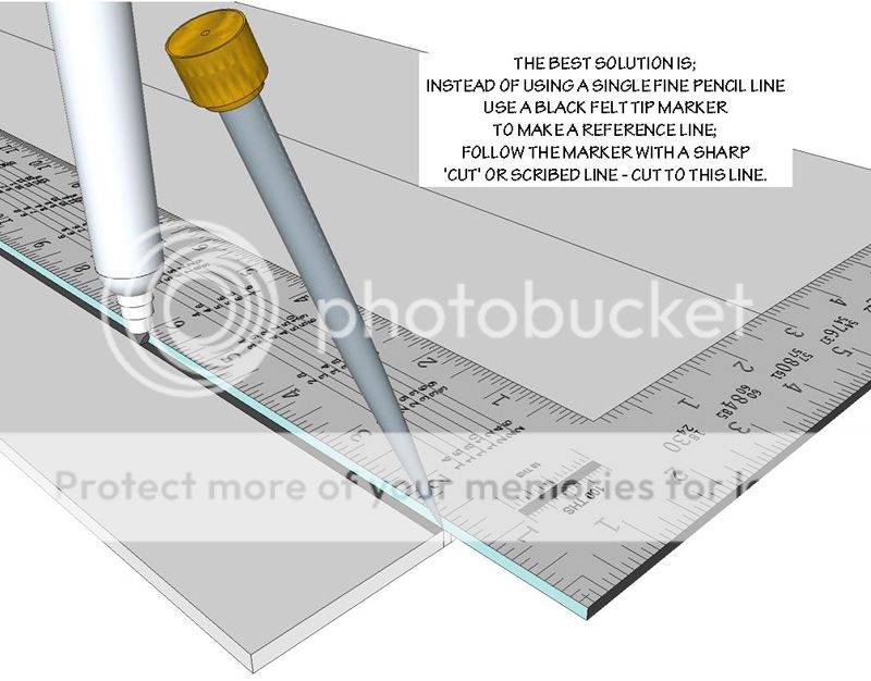

Next image (above) introduces the need to have high visibility and that relies partially on contrast. A pencil line, a fine marker line, or ball point pen line (the ball point won't always draw on aluminum) are all narrow and not high color contrast to the metal's surface color regardless of the surface treatment. So, I recommend a wide, black marker line.
The pair or 'Sharpie' markers here recall the potential problem with using any marking device with a straight edge, or batten when marking the refercence lines for the next step. Be careful to hold ink marker so the line drawn is next to the straight edge not waving like the previous images illustrate.

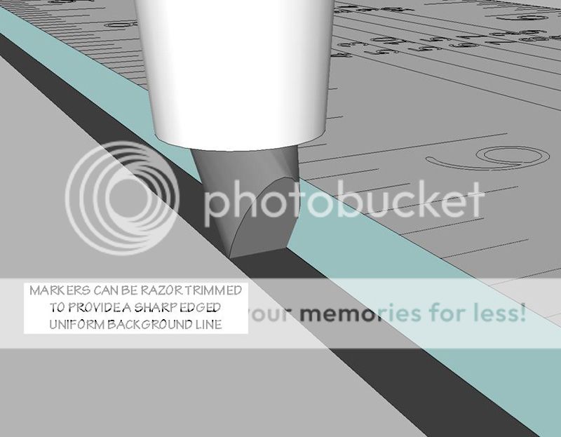

Above is a close up of the wider marker tip that has been sliced with a razor to sharpen the edges so the background reference line in this marking system produces a fine edged ink strip. New markers may not need to be trimmed, but older ones tend to get softer, rounded and fuzzy and a little trimming with a razor will return them to service for a while longer.
Almost done! Here is the key to high quality marking of aluminum for power tool cutting; using a black reference line to the side of a scribe cut line in the metal's surface. The cut line, or scribed line will reflect a high intensity work light back to your eyes while the cut proceeds. The scribe is a very fine line but the background reference line allows high contrast for the eye to track the main line of the cut while still focussing to this tiny line to guide the saw's blade edge (kerf edge). Note the scribe's angle to the straight edge is leaned back enough so the tip is at the junction of square/straight edge and the metal to be marked? That stops the scribe from cutting a wandering line.
Last image in this series, zooms in to show the tools positions for the best results, and underneath the square on the edge of aluminum to be cut is the outline of the saw blades' kerf or material removed in the cut.
Summary:
If a line, curved or straight is not marked uniformly with a uniform tool position- most marking tools will draw a wavy line because of the lever formed by the tip and the layout tools' edge. Decent lines, fundamental to good metal boat work, can be drawn easily by paying close attention to how the marking tools are held and moved along the marking area.
The most visible line is one with a black ink background and a scribed or 'cut line' next to the ink's edge. The cut line, reflected in the work light offers the best guide for hand held power tool cutting aluminum as the shiny reflected cut's sides will illuminate the line best of any marking method.

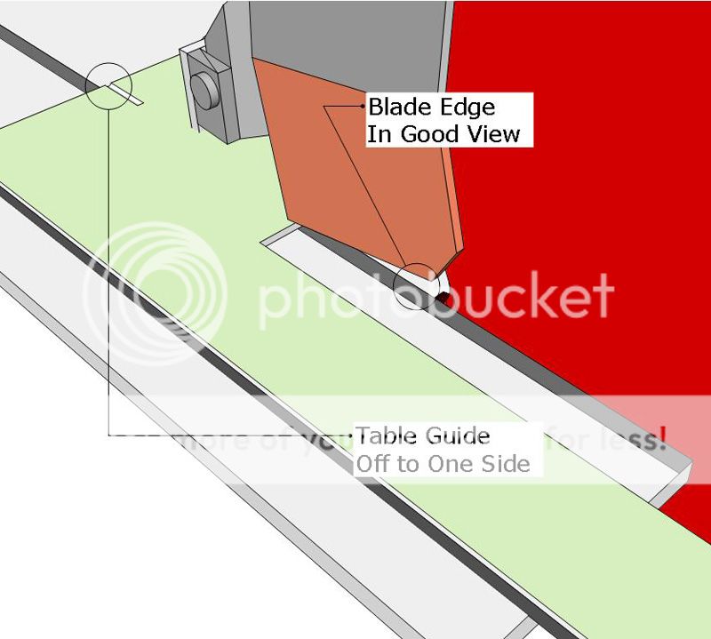

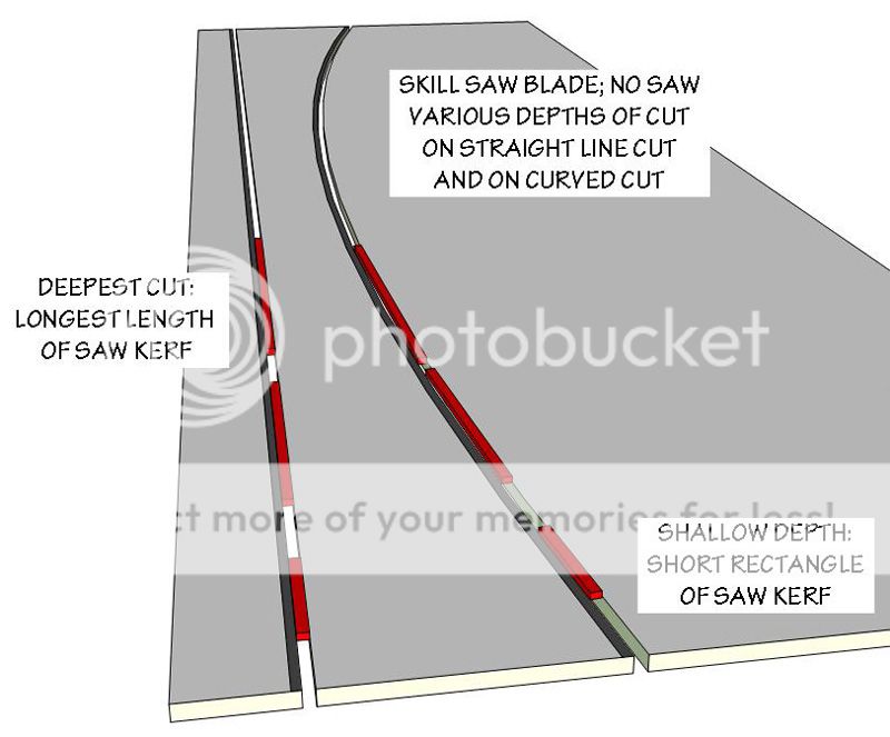

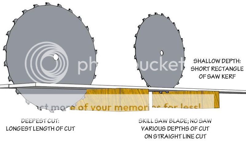

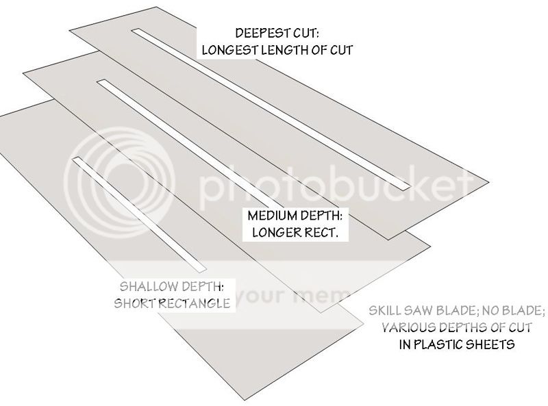

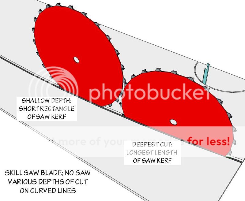

IF you can’t see the cut line mark; if you can’t see the element of the cutting tool that is making a cut- the blade of whatever form; you can’t cut well enough to control the quality of the build.
If you can’t see the line and the blade while it progresses along the cut to make corrections, you’d best figure out how to have the parts cut by computer (numerically controlled “NC” cuts) because you’ll have corrupted the basic builders block: the fair line edges of all parts to your welded boat. IF the parts’ edges are not fair, sweet, accurately matched to the next part, then welding contraction, distortion from gapped fits will leave you with an extremely expensive pile of "used metal”!!

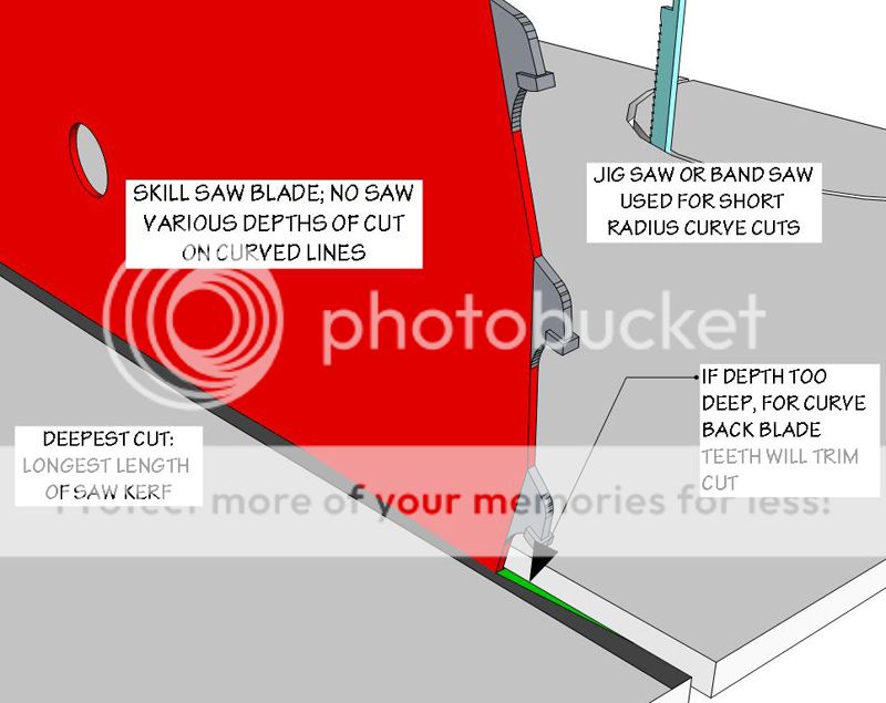

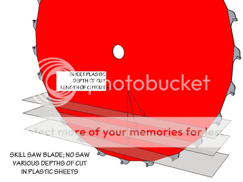

I show a 'worm gear skill saw' (term not brand) in these images and I show a red blade but wood cutting teeth... the previous links to suggested brands and models are not changed by providing these simplified images.
The purpose of this image (above) is to discuss the two-hands-on-the-factory-handles problems with worm gear saws used in metal. The view is where neither the blade edge/teeth or the table guide is really helping make a 1/32" accurate cut. The blade's teeth are hidden by the blade cover and the table thickness and crude blade guide marker are not accurate from this point of view.

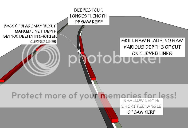

Note: on some saws I've removed some or all of the orange shaded areas to get better visibility- that is an extreme step but... if I was cutting several thousand dollars of metal- I wanted to see well enough to have the value or more when I was done!

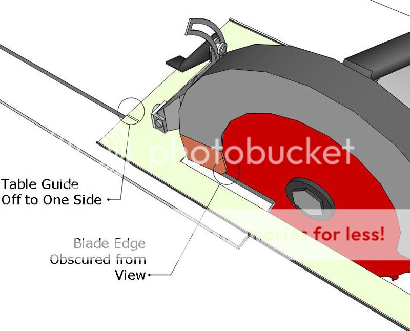

Not that you can easily see this view (above from the front of the tool down low to the metal being cut) of the saw when holding the handles for a cut (!) this image above shows what information a good saw requires of the sawyer. Clear vision of the blade and maybe a clear reference to the guide on the table's lead edge.
Moving our point of view down toward the plate being saw but moving back behind the blade's leading edge... we can see the blade teeth as their lead inside edge comes up through the metal. This is a "Leave the Black" cut not a "Take the Black" cut; where the scribed line (not well illustrated above) is along the right side of the black reference mark, and the blade teeth exactly cut the right edge of the scribed line.

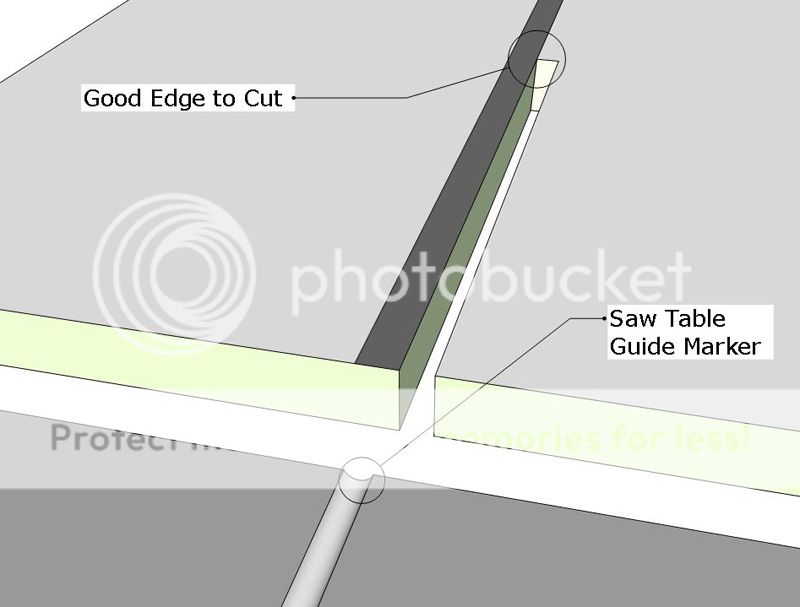

Above is the common sense test for cut quality, when the saw is removed; is the scribed line at the edge of the cut? Is there a 'clean' line? Is there some part of the scribed line removed and some left? Is there some part of the black reference line removed and some left?
I recommend ignoring the table's saw blade guide mark- rely ONLY on the view of the teeth as they come through the metal and control the saw's movements between your hands with the left side "table handle" shown in previous posts.
But like any work technique, just make some cuts, and give your work the test shown in the last image above. If the lines are good, then your technique is working, if not... well that calls for some practice and consideration of another technique to improve your cuts.

In order to see the scribed line shining on the metal background, I use a set of lights like these to stand in front of the work and shine back and down into the saw's cutting area, I use the light ahead of me shining back so I don't shadow the cut line. If you have a helper(?) then dragging these lights along with you as the cut progresses is a fine way to be of critical help as the cut progresses.
http://www.amazon.com/NOVUS-7100-Plasti ... vus+polish

Cutting with power tools involved marking the cut, seeing the tool’s cutting edges and guiding it along the clearly defined mark and using the tool most suited to your comfort, skills (and in this post) the type of line to be cut. We’ve seen weld edge bevels, edge shaping after a outline shape was cut but here, I’ll try to suggest ways to select tools/blades and setting for a group of three basic cuts. The first group of cuts are the straight edge, or lines, the other two are curved cuts; long radius or short radius.
I'm going to focus on the worm gear skill saw cut of longer lines. These would be the keel, chines, sheer, guard deck/sheerclamp or any other long slow sweeping curve of the boat- usually cut into the hull's skin panels or plating, but also cut into bulkheads, sub decks and other curves. The reason for this post, which may seem a little too detailed (?) is the amount of error that comes from not planning your tool use for these long cuts.
First image above of a red blade passing through three sheets of plastic illustrates that the length of the cut is related to the depth of the blade setting on the saw's table.
IN this sketch of the three sheets of plastic used to show the kerf length, the longest is at the top- which was farthest up on the blade- so the deeper the setting the longer the cut length.
Above the set of blades in a straight cut. Here, the deeper cut setting is very beneficial- the longer kerf helps to keep the saw tracking in a line. But that is not the case with all curves and here is where attention is worth paying to this tool adjustment and technique.
Just above is another view of the previous sketch and here for a reason - we need to take a minute to discuss skill saw blades cutting aluminum from another view point (no pun intended). The blocks of wood represent 'cutting boards' just 2x6's laid along the material under the cut area to #1 support the cuts edges while cutting, (OFTEN on large sheets you're crawling on your knees behind the saw depending on the panel shape/size and the original material size) #2 to clean the tips of the skill saw teeth while returning upward to cut metal, #3 to reduce vibration of the blade due to uneven loading while cutting aluminum on one edge and turning free on the other, #4 this also improves blade life by the #2 & #3 reasons, and it keeps the kerf narrow compared to a vibrating blade.
Notice that the blade depth at full reach (left hand blade) would probably cut through the 'cutting boards' so planning how to lay them out is part of using them over and over.
This image above shows a set of three different lengths of red rectangles, like sections of the saw blade. One set on the left are on a straight line cut the others to the right on a curved line cut. Just about any amount of depth setting for straight line cuts will work fairly well, if lubricated regularly with pan spray and the sawyer's eye is kept focused behind good PPE on the exact point where the carbide teeth come up through the metal along the scribed line- highlighted by the reference line of black ink.
This image above, shows the effect of different lengths of the saw blade's dept setting on various curved cuts. If the saw is set too deeply it can create an interference with the previous cut edge (cut by the leading edge guided by your eyes) by 'dragging' the blade's back teeth into the already cut edge- destroying or at least messing up the cut line.
It is very important to notice that this saw is cutting the INSIDE curve not the outside of the curve. To make these terms clear- in this image the curve is hollow to the right side, so the 'inside' is the right most edge as this drawing is shown. That is not always the case! If you marked the curve in this case, from the other 'side' or with the reference and scribe to the right of the kerf shown- and used the saw from the other end, you'd be cutting on the 'outside' of that same curve.
In the case of an outside curve the back of the blade usually takes material off the waste/drop/off-cut material since the teeth reach 'across' the kerf versus curve; instead of the instance shown where the teeth could reach inside the cut line to damage that cut.
This image above of two saw blades starts to summarize the points made in this post. At the left side is a blade with a shallow depth of cut- making a kerf rectangle with a short length that fits inside the cut out material and does not re-cut the trailing edge of the saw blade. Buttttt.. that's not true of all curves for the deeper cut of the right hand blade shown.
Our last image above, shows the detail of the potential error of and INSIDE cut curved line with the blade set TOO DEEP. While that setting can be helpful in straight line cuts, it may be a hindrance to the inside curve cut if the depth of the cut allows the trailing edge of the teeth to re-cut the scribed edge.
I put a little green triangle to show the blades' back teeth area of cut. Now this is probably not going to happen on 80% of a long cut if the curve of a chine, sheer or even a keel is considered. BUT where those three groups of curves get "shorter radius" or become tighter curves, at the bow of almost all planing hull shapes; that is where this can become a critical error in using a skill saw to make curved cuts in aluminum.
Above is a photograph of two pieces of 1/4" plate being cut into the bottom and chine shapes for a 25' skiff. 85-90% of the curves were cut with a skill saw, and the last few feet were cut with a jig saw. The radius of the curves combined with the depth setting of the skill saw allowed very fast and fair cuts, however when the curves tightened up- toward the bow the radius of the curves typically shorten- there the blade on the skill saw was raised to make the kerf a shorter rectangle and to avoid damaging the previous cut edge with the back blade teeth- and when the curves tightened even further (?) another saw with an even narrower kerf was used to finish these curved cuts.
Summarizing: Skill saw are currently the most effective hand held power tool for long cuts of aluminum sheet done by a builder's own hands. Using good care and forethought, this tool can cut almost perfectly smooth curves of an incredibly wide variation in radius if care is given to the setting of the depth and the teeth on both ends of the blade as they approach the metal being cut. When a curve become too short radius to be cut with a skill saw the jig saw is powerful and consistent enough to provide the final cuts without any sacrifice of time or quality of cut.
I can (and have) cut entire skiffs with jig saws, some builders depending on their strength and skills may find the jig saw a preferred tool. Those cuts will be slower than skill saw cuts in most cases, by using a Vixen file, all cut edges can be dressed to clean, sweet curves ready to tack into a fair hull.

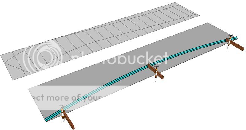

In this image the flexible or adjustable battens (cyan colored here) from the link above is shown, laying flat to the paper being used to draw the Chine in Profile from our previous images in this discussion of basic curve principles.
Rule of Thumb #3: Different cross sections of battens will 'allow' or tolerate (without bending permanently in deformation) different 'families' of curves.
Thicker and wider cross section battens will not bend as tight as thinner and smaller cross section battens; all battens should return to their fully original lengthwise shape- or they are too large in cross section for the curves formed.
Zooming in on the batten and ducks sketch (2nd above), to look at left most two drafting wt.s holding the batten along the reference line- this is the reason the term reference line is used. This particular curve 'originates' from the baseline/reference line- departing at the tangent point and rising to the right out of frame. These two wt.s hold the batten (more may be needed?) to the reference line- the batten is held Straight up to the tangent point.
Notice that the nearest drafting/duck/whale wt. or clamp holding the batten to the baseline.... is just toward the reference end from the tangent?
Rule of Thumb #4: The batten should be clamped 'some distance back' on the reference line.
The distance (referred to above) will change with different battens and curves of various radius and this clamp or drafting wt is often moved as the batten if 'faired' long the curve sought. More on this point in future posts. Very important to note this concept as we move forward and apply these concepts.

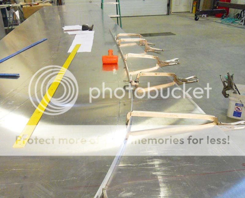

Anyone who's lofted a set of offsets, or lofted from a lines drawing realizes that the scale of the drawing and the line width of on paper (in scale) induces errors that could be quite large- using full sized aluminum battens can reduce those inherent errors to less than 1/64th inch! The method used here will rely totally on this fundamental aspect of the use of aluminum extrusions as battens for may jobs in building welded aluminum boats.
Just above, a photo of a 1" x 1/4" flat bar, on edge, being used to batten (fair out) a set of points laid down on a grid on a sheet. Some of the vise grip clamps are pulling the batten, some pushing and some just holding it down tight to the sheet. Aluminum extrusions used to fair curve offsets, layout points, modeled outlines can reduce the natural drafting errors and create complete fair shapes.
Clean layout, batten faired corrections of design (paper) errors in measurement does result in clean shapes, cut with accurate marks and good tools use means anyone can build a fair hull.
