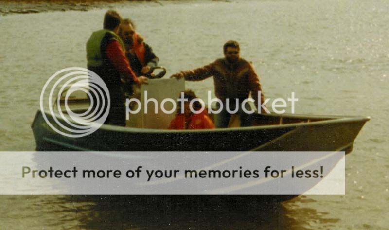

This skiff above, one of mine from the 1980's, has a nearly flat bottom aft. However, you can see that by running the chines all the way to the sheer, the bow is very sharp angle of entry. Her job was to float rivers and plane in shallow water but then to go out in saltwater and run well into a 2-3 sea. She was a bit lightly built to do this well in the salt, but when she finally got enough power to push her with a good load the shape did run well in both conditions. (She is 18' LOA and didn't have seats or hand rails when this test run was made.)
She's shown as an example (perhaps extreme case?) of warping the bottom to preform in two conditions- the bow is sharpened to take a sea head on with minimal impact and the stern is only cambered 4" in 60" to provide a nice flat planing surface. She would plane five adults with a 50 hp 2stroke, but when she ended up with a 70hp four stroke she lifted half dozen people and gear, and ran well even in 4' head sea- but at that height of waves she could not hold speed due to launching off waves. She was very stable at rest due to her almost flat after sections.
I built this boat in a 22' LOA and 72" chines that was used to fish 6 people in 15 miles offshore regularly, but her sides were taller by a foot. The warped hull can provide a runabout performance with more stability at rest, by using a combination of chine flats and deadrise changes.
