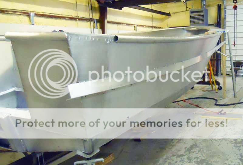

in order to give some exact visual reference to my discussion about TIG tacking versus MIG tacking I've decided to post this image and discuss an aspect of one hull that illustrates my point. This is an external Long- a hull topsides outside unequal leg angle that acts to form the primary panel reduction of the topsides - and a spray rail at the same time.
I tend to lean toward hull framing as almost exclusively longitudinals, as opposed to more wood boat inspired transverse frames- but the results are not much different in 'net' strength- what is different is the methods I use to build.
[FULL DISCLOSURE: I do not sell boat plans, and the images shown are for procedural education of prospective welded aluminum boat builders- only. I'm attempting to make a pretty fine point as an answer to a reasonable exploration by a Glen-L poster about the potential to use a TIG torch to build his hull.]
I'd mentioned above the time duration of a TIG tack versus a MIG tack- I'd hoped to suggest that TIG is a great weld process but... usually involves a longer time interval during which the sheet aluminum (in this case the topsides) would be heated and expand from the heat of the TIG arc. I'd mentioned that the MIG process takes much less time so that MIG tacks are much more functional for field or 'mid-sheet' tacks of longs, frames and bulkheads to mention a few structural elements that are connected in T-Fillet welds.
What is in the picture. The boat is LOA 25' or so, this boat in mounted on a rotisserie fixture to allow me to reach welds in positions I can achieve in high quality at my age (60's) that would be compromised if I had to kneel down and and weld below my knees in the bilge.
The side rail/spray rail/hull topsides long is being tacked on using TIG. The picture is of a clamping tool that (starting at the top) has a bar with cupped interior upper end to hold onto the bar tacked to the inside of the guard deck/sheer clamp/gunwale plate horizontal at the top of the sheer.
This pivoting bar (bolted through the 2" sched. 80 -6061-T6 pipe) allows the lower length of the pipe to swing inward toward the chine when pulled by the ratchet strap winch pulling from the center beam of the rotisserie fixture. Orange strap at the bottom of the image.
The 4x3"x1/4" angle has been cut to 4"x2" and the outer edge or apex has been rounded over using a 3hp router and 3/8" radius roundover bit and lots of generic frying pan spray to lubricate the cut. The result was then dresses length wise with a belt sander and Scothbrite (tm; 3M Corp.) belt to create a smooth surface that includes the rounded outer edge.
This photo shows the process of TIG tacking the 1/4" angle to the 5/32" (0.160") 5086 topsides. The angle has had 60deg. bevels inlet into the two legs' outer edges so the welds will be narrower root face but will have a gouged or cut root face V. This improves the use of TIG for a hull weld (stitched welds as shown by tacks in the image) so the weld can be installed very hot (300 A) but with a narrow face and deep joint -root face penetration.
The weld pattern is 4"- skip 4" -opposite side 4" and skip 4". All the bevels or joints are cut before the angle/extrusion/spray rail are in place for the tacks. All cut, dress, and surfaces are cleaned with Acetone and then wire brushed VERY carefully close to the weld zones only.
[The mill scale has been 100% removed from the topsides prior to this entire operation by running them through a 50" drum sander.]
There is a sliding collar that mounts another pivoting leg allowing the tool to adjust to the various angles between the topsides and gunwale plate/guard deck/sheer clamp- and this feature includes locating the clamp leg below the angle/spray rail so it's held against the side tightly.
The pipe clamp forward of the current tacks lifts the extrusion "the hard way" along the 4" vertical leg.
This is the extent of clamping/planning/fixturing required to use TIG to tack longs in the field. I'm not attempting to suggest this is the only means ? This is just what I came up with to do this job alone; in full control; and with no hurry to get the tacks "tight"
What is not shown is a 2x12" Plank of fir- inside the hull expanding the topsides in to an outward camber in order to further stress the topsides panels and by adding cylindrical or conic 'bulges' I'm attempting to reduce the final weld heat contraction so the topsides come out fair- even when a field tack and weld is required to add this structural element.
This rail followed the sheer downward (near the stern) then swept up with the sheer toward the bow. So tack up control was absolutely critical.
Rigging to get the rail on in a 'clean' manner by myself. Lots of clamping, fine adjustment and holding power if I wanted to use TIG to do the work?
TIGged hull seams are fully possible but they do require more planning and discipline than MIG for the same boat.
She turned out OK, and fair, but.... this was not my in my first 100 skiffs either. Hope to make this point clear: you can do a skiff hull with TIG but MIG is easier. RobP1, happy to help answer any more questions, and to clarify my replies here to the original inquiry? Please let me know how I can help your research- if I can?
