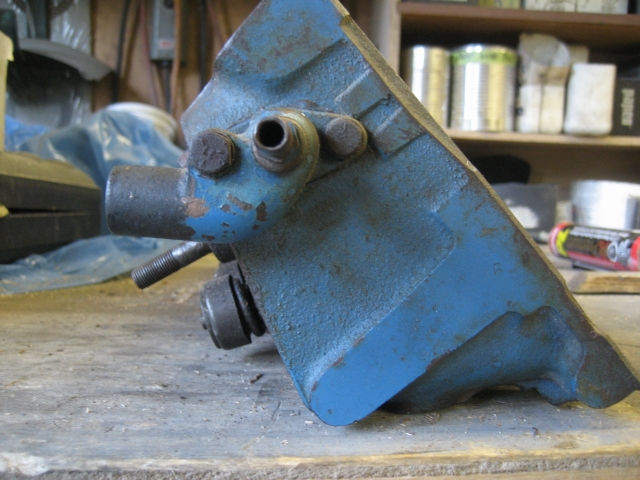

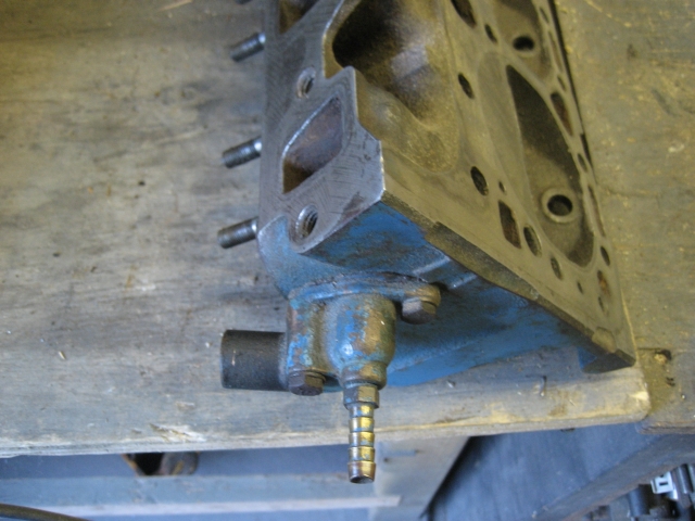

Not familiar with this type of plate. Can you post a photo or two of your installation ??
Hopefully the following photos of Bruce Dow's flywheel forward Chris-Craft 283 might provide a clue as to where to drill the head for water outlets :
Hope this helps !

Engine doesn't have a thermostat ... The water pump has a circuit for each cylinder bank (1 inlet and two outlets).
Photos are from a future WebLetter article on rebuilding Bruce Dow's vintage 283. We'll have to finish up the article and submit it as soon as we get the Hot Rod back on the water !

The only reason I asked was in your first picture the fittings on the heads are two differrnt sizes and then in the close ups it sort of looked like a tstat would fit in the housing. Oh well thanks for the education :)
