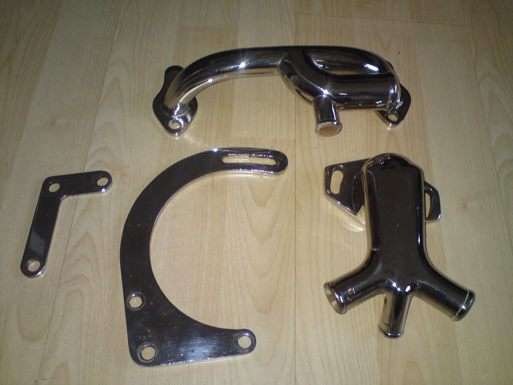

mjleguay wrote:Paul, thankyou for those photos, I appreciate you putting them up cause they're a great help. I've uploaded a photo to show the thermo blank....it just blocks off where the thermo housing/water outlet originally was.
Caber, I'm not sure if I have the crossover...are you able to tell from this photo?
I was going to go with the crossover on mine "this is them on the top and the right of the photo" but in the end I went back to the circulating pump.
As you can see here I am using mercruiser wet exhaust the elbows can be put on facing front or back depending what way round you have the engine. http://www.youtube.com/watch?v=u4fw4e7_ ... ideo_title
