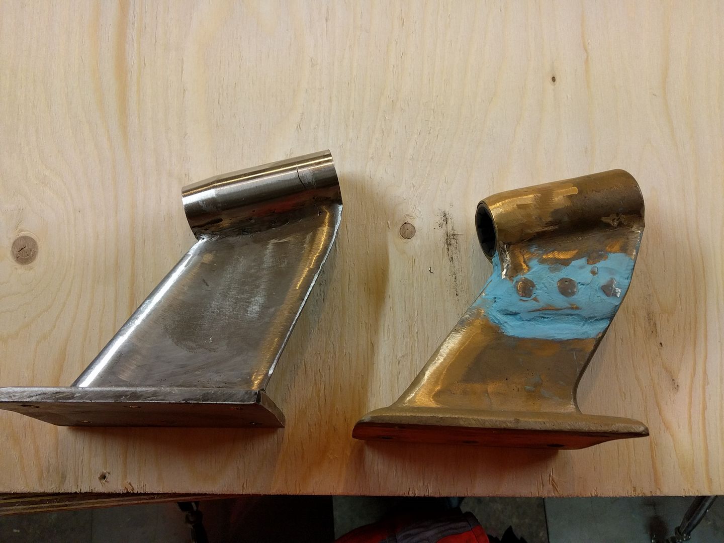

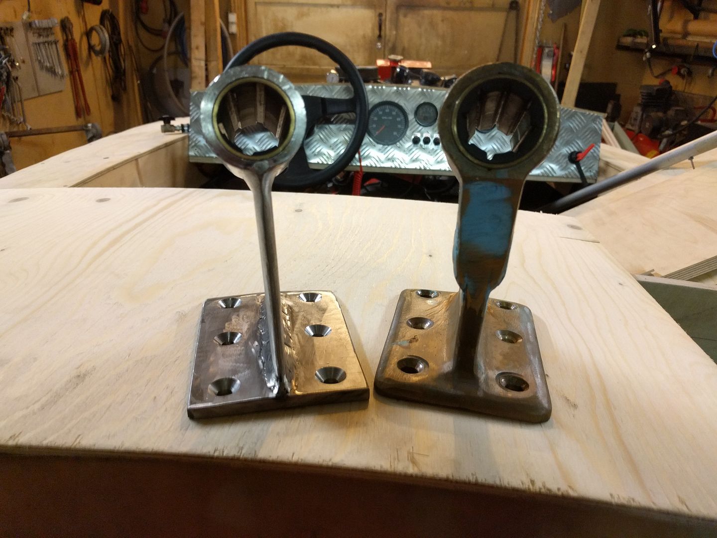

Finally got new strut made, took long enough.
Had litte problems when welded strut, warpped strut housing. First bearing was destryed while installing. Little bit of work and i tought that now it would be good, but not... Second bearin installed, well guess what? too tight :D Well i sanded it a bit and now its ok for testing, just hoping that weather gets bit better.

Very nice fabrication work.

Your new strut looks very nice. good work.
