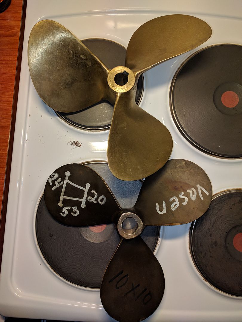

Im sourcing materials for new strut, have not found yet. Well i could make it from steel, i have materials for that, i guess rust wont be an issue with good paint and boat always on trailer. Water around me is brackish i think. I live in an island, in smallest town in Finland :D
Just machined taper of 10x10 prop, its not good, i think someone have messed with it before and messed it up. I think after balancing it will be atleast good enough to test. Next week prop guy is going to look at both props, hoping to learn something usefull.
My engine is sitting quite high, can this affect on performance?
Also i looked both props and those dont seem to have that much of a diffrence in pitch, darker one is 10x10 and brighter is 11x15. Well i dont understand much about props, so i guess prop guy will tell me more :roll:

Tried other prop repitched, so now 10x12. Quite funny really, at 6000rpm prop slip was again 59% :lol:
So yeah, i guess that strut is just that bad. I ordered new rubber bearing, smallest i could find. Little bit machining and welding and ill guess try again :D
