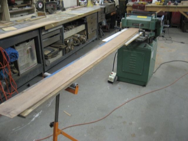

Joined: Tue May 05, 2009 12:18 pm
Posts: 587
Location: Raleigh, North Carolina
For what it's worth I planed my finish deck boards to 3/32" so they were approximately 1/8" thick once 'faired'. They were a PITA to work with and it was a learning experience with a few 'hiccups', but I was trying to minimize the weight I added with the top decking.
