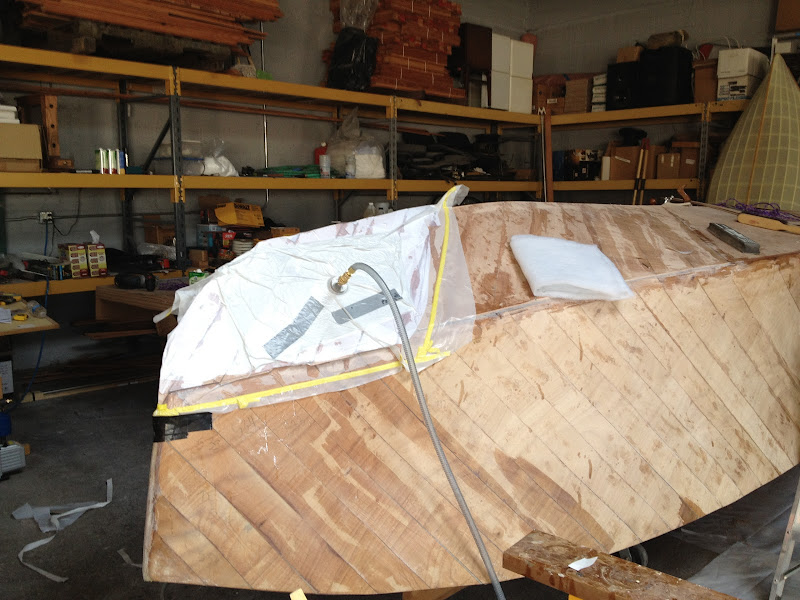

Final layup before Mahogany!

Postby Bob Perkins » Fri Aug 03, 2012 8:15 pm
Looks good !
Keep up the fine work.
