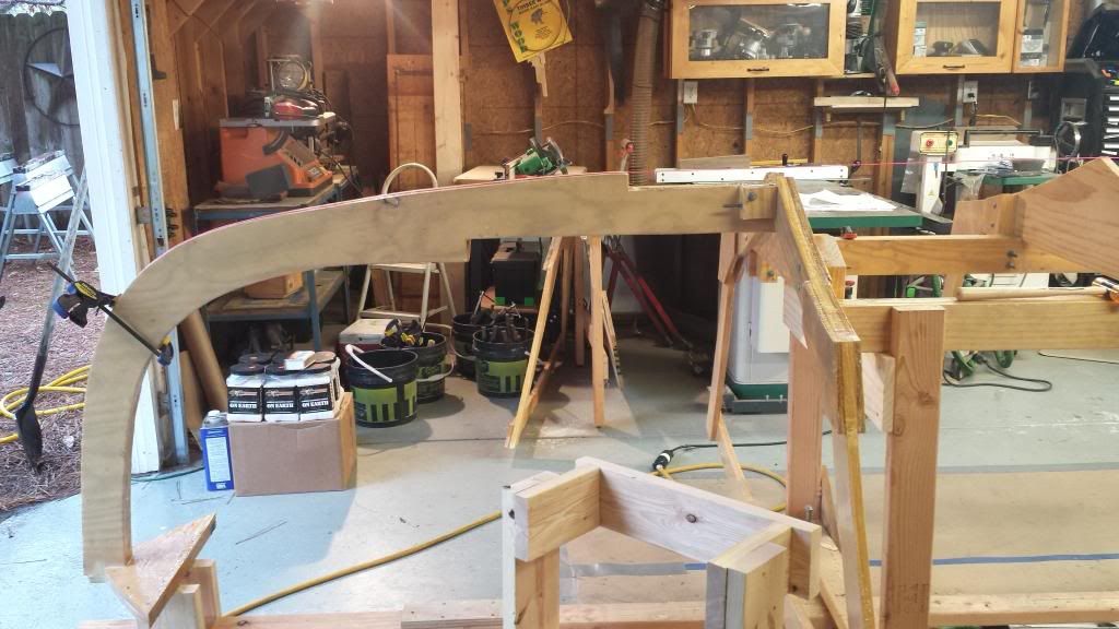

No question is "that dumb John. I assume the general build is similar to mine, so yes, the stringers bolt to the for to give you a backbone of sorts onto which the frames are attached at intervals. Make sure it is all (temporarily) strong to hold it all in place very accurately.

John, If I recall, I used deck screws to attach the stringers to the form. No need to make holes for through-bolting here. Also, make sure you can remove the screws easily after the flip. That was a great question...Keep them coming..Neel

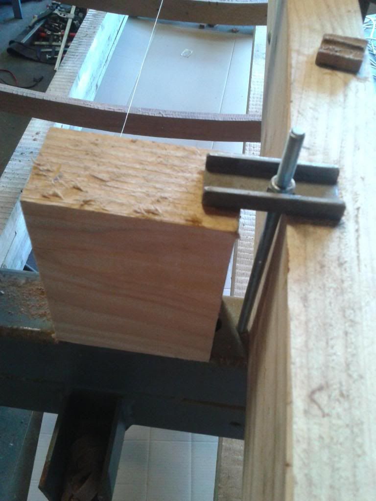

I used frog-plates, not sure what the correct english name for these is but that's what we call them.
The reason i use these is that i build my form from two left-over steel frames and two laminated beams i ripped from a old gym-hall (read; it was for free :wink: )
Also is is very easy to release them, simple loosen the bold and take the supportblock away and it all comes out.

Attaching transom to form today. Not sure, but I assume I use threaded lag screws from form post upright to transom?

I used three silicon bronze 3/8 bolts and nuts each side on mine, as you cannot get at these after the transom is finished.
