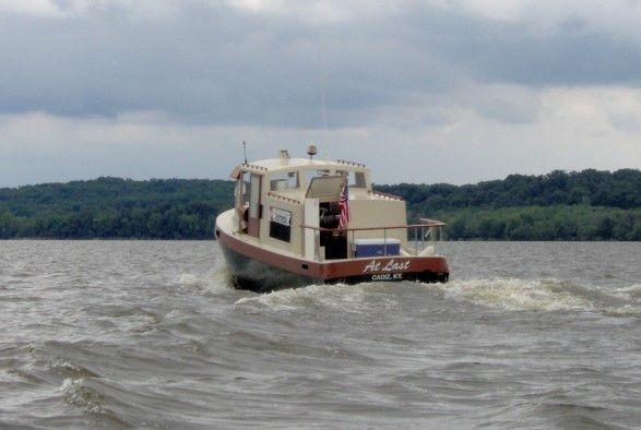

This post is long (I get carried away) and I am assuming you are looking at an I/O. If you are thinking about an I/B I think Kens is right and there probably would not be a lot of adverse performance for a little additional weight. That weight would be carried closer to the C/B and not tend to shift the hull out of trim as much.
Deep Vee designs potentially have more below the waterline volume at the transom which tends to allow them to carry more load. Shallower Vees on the other hand have less volume and are more sensitive to additional aft weight. But Deep Vees are designed to operate most efficiently on plane and do create more drag when going slow. As mentioned one possible solution is to lengthen the hull but with the True Grit/Coastal Cruiser going form 25' to 27' increases the allowable weight by 100# (600# to 700#). But still that is not enough to accommodate the 3.0L I/O and stay in trim.
Can't speak about the Double Eagles but I know there have been several builders that have installed the 3.0L engines in the TG/CC hull and are running them with no problem. BUT your question is will they run efficiently? I am no expert but my guess is it does indeed compromise somewhat the low speed performance. Here is a photo of Gary Stookeys very nice aluminum True Grit with a 3.0L installed The shot is on the trailer but note the waterline stain. (photo from Glen-Ls page on the TG)
As per plan the waterline should actually be parallel to the chine along the aft 2/3s of the hull. On Gary's boat the waterline crosses the chine about were it should but obviously it is squatting and my guess is the transom is setting about 3" deeper than it should. Gary's situation is aggravated by also having the 115# 15 hp kicker mounted back there. I have to believe this configuration is hurting the low speed performance as the lower transom is digging a deeper hole as you move. High speed is probably effected too but not as much as more of the transom is being lifted out of the water. But this was a trade off Gary was aware of and willing to accept. I corresponded with him about it. I was concerned about the foot end of the berth ending up higher that the head end(aft) making it uncomfortable to sleep. Here is what Gary replied about the situation -
The stern is down with the weight. The only weight I could remove would be the outboard and that's 115#. But I had to use it to come home with 5 hours on the main eng. The starter solenoid went out. So its been very useful so far, I use it trolling all the time too. It burns very little fuel and is quiet. I was very impressed with the weight carrying ability. I have had 4 grown ups and a few kids aboard and it will still get up on a plane and run 20 mph. But sucking lots of fuel and making lots of noise. I would rather cruise at 10 mph where its quieter and smoother. It seems so slow to go 6 where its at hull speed and cheap to run. The out board will push it 5mph so you could run real cheap.
I also ran into a Coastal Cruiser (wood) with a 3.0L on Kentucky lake. Again I could see it was squatting. If I remember correctly the owner told me he usually cruised about 10 or 11 mph and was somewhat disappointed he was only getting 2 mpg (about 5 gph). Honestly that doesn't surprise me. His cruise speed is about my 60 hp TG's top speed. And even though I am lighter at the transom than him at 10 mph I really don't think it is planing - still plowing a lot of water. Here is a photo of the CC at cruise -
Note the rolling wake behind. Just don't think it is planing and it is operating in a zone that probably produces the poorest fuel economy. My guess is it will take about 15 to 17 mph to make it plane cleanly. But then again this is a "semi-displacement" hull and honestly I don't think it will ever really plane efficiently. The hull design is a compromise that operates fairly well at slow speeds but CAN be pushed fast enough to plane. It will require more HP to plane (i.e. more fuel) than a planing hull but will operate more more efficiently at low speeds than the planing hull. Obviously it is a trade off.
My thought is the semi-displacement hull is ideal for the people that want to go slow (displacement speeds) the vast majority of the time but would like to have the ability to go faster if the need presented itself - like getting out of the way of an oncoming threat or weather. If you want to run more than 7 mph or so on a regular basis I personally would be looking more at the Double Eagle or similar. It is still a shallow V but a true planing design but will offer reasonable lower speed performance. Still aft loading it with an I/O will hurt the low speed end somewhat - there just isn't anyway around it.
