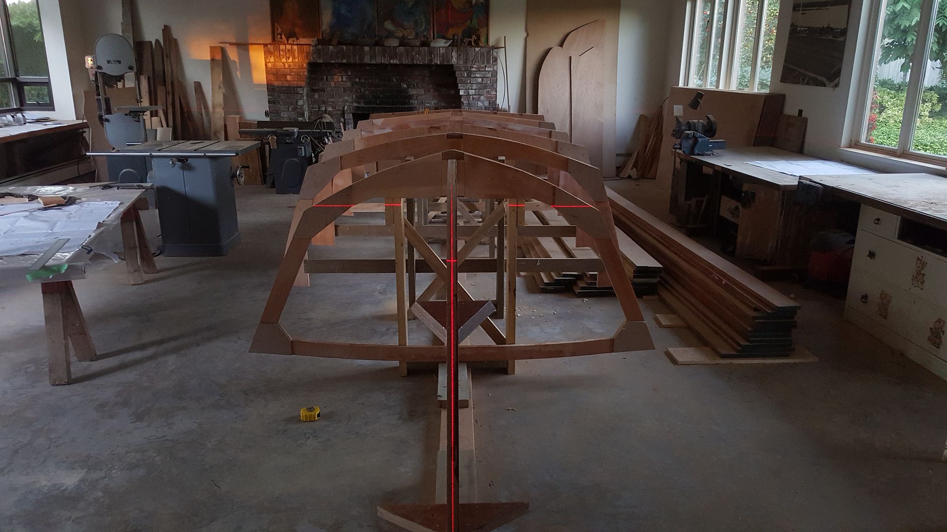

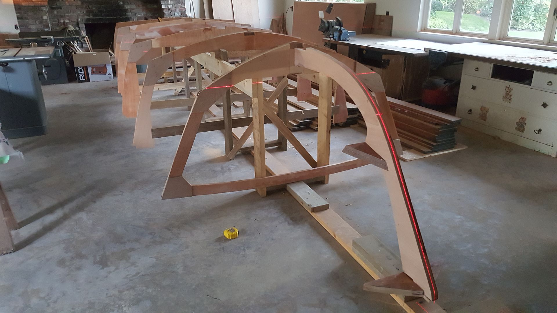

Postby froberts » Mon Oct 03, 2016 11:46 am
Thank you everyone! Yes the shop sure is something special, especially since most everything in it is now getting a second lease on life. I have such a strong appreciation for how great everything still runs! Including the old radio!!! :D With the exception of a few newer items that I own/purchased everything belongs to my grandfather, which he has collected throughout his life.
It's been a very busy week at work and I wasn't able to get much done on the boat :( The last frame was glued which meant it was time to start mounting!
With the help of my laser level I went down the line and fastened them each to the build form with two screws.
:?: QUESTION: what would everyone suggest I use to fasten the tops (currently upside down) of each frame to the form. My second question is, after planking the boat, how do I get under there to unfasten it? Do I pop in before the last of the planking goes on?
Next up is finding some time to build a couple new saw horses for a table saw outfeed.
Fraser
Posts: 1079
Re: My (Sort Of) Sea Knight Build
Postby hoodman » Mon Oct 03, 2016 12:00 pm
None of the tops of my frames are fastened to the building form. I just made sure they were plumb when I was installing the sheers. Nothing wrong with attaching them, however. After planking you'll just have to lay down and shimmy under there to undo them. I've been under my boat a few times since installing the planking. Not fun, even after I swept out under there. If you have a creeper you can probably roll underneath.

hoodman wrote: After planking you'll just have to lay down and shimmy under there to undo them. I've been under my boat a few times since installing the planking.
Of course, a Zip is a considerably smaller boat, but when I flipped the hull, I picked up everything including the build form. Then, when I had it right side up, I just climbed in and undid the build form piece by piece. It was easy.

Hi Froberts, Fantastic work on your frames. When I started my Renegade build I made the set form 6" higher so could get under to unbolt it and left in the boat . When I turned it I had a block and tackle at each end and used the shed rafters to hang them on . Luckily I have 3.3 metre's between floor and rafters , was real easy to turn by myself .Love your shop to build in ,and like you I have an old Scharnberg Strausse valve radio that still works . When I bolted the frames to the stringers I bolted them on the outside of the stringers as the center will be used for storage later. Remember to measure twice and cut once .
