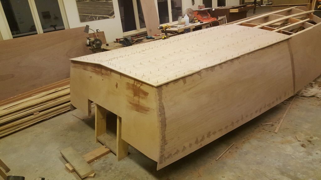

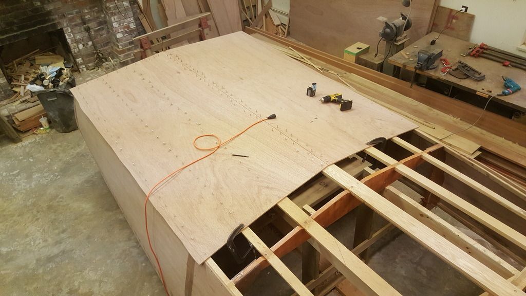

Nice score on the hand planes. Double check the screw locations on the side planking. On my tumble home, the screws were a bit too low and I nicked up my block plane pretty good trimming the sides.
For limbers, I used a "dish" bit in my router. Like Bill said watch for blow out since you're cutting across the grain. I tried clamping a backer board on the frame to minimize it, but the Sapele I'm using blew out on the front side. If you have a sharp bit it should be no big problem.

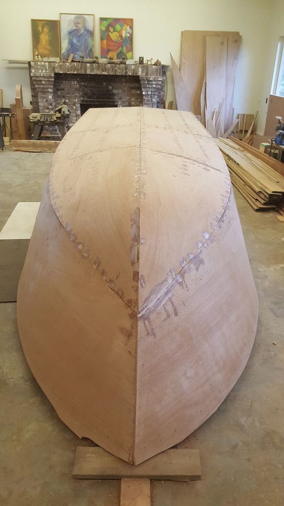

Spray Rails have been cut, fitted, and glued!
Here you can see that one side has been epoxied on and the front angle has been cut....it took a lot of looking at it upside down and thinking before I worked up the courage to cut the angle. But I'm happy with how it turned out. You can also see my skeg dry fitted.
Both sides of the spray rail are epoxied along with the skeg.
Next up I went to work building up the transom edge with epoxy.
With all the epoxy setting up I decided that now was the time to get going on the cradle for the big flip.

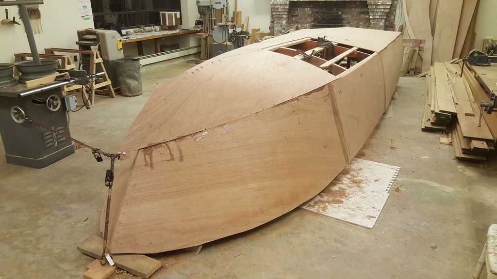

As I've waited for the final coat of epoxy to gas out I've spent quite a bit of time running my hand over the boat looking for any little imperfections (or rather big imperfections...cause there are tons of little ones) that need to be sanded. I've very happy with how the hull looks and can't wait to see it transform once it has some paint on it.

I spent a couple hours this afternoon beginning to prep for paint. Managed to get the bottom all sanded and ready to go, just have to finish the sides.
I did also give the transom another sanding. If there is one part of this hull I'd like to get close to "perfect" it's this. As you can see in the picture its nearly there with a few low spots along each side.
