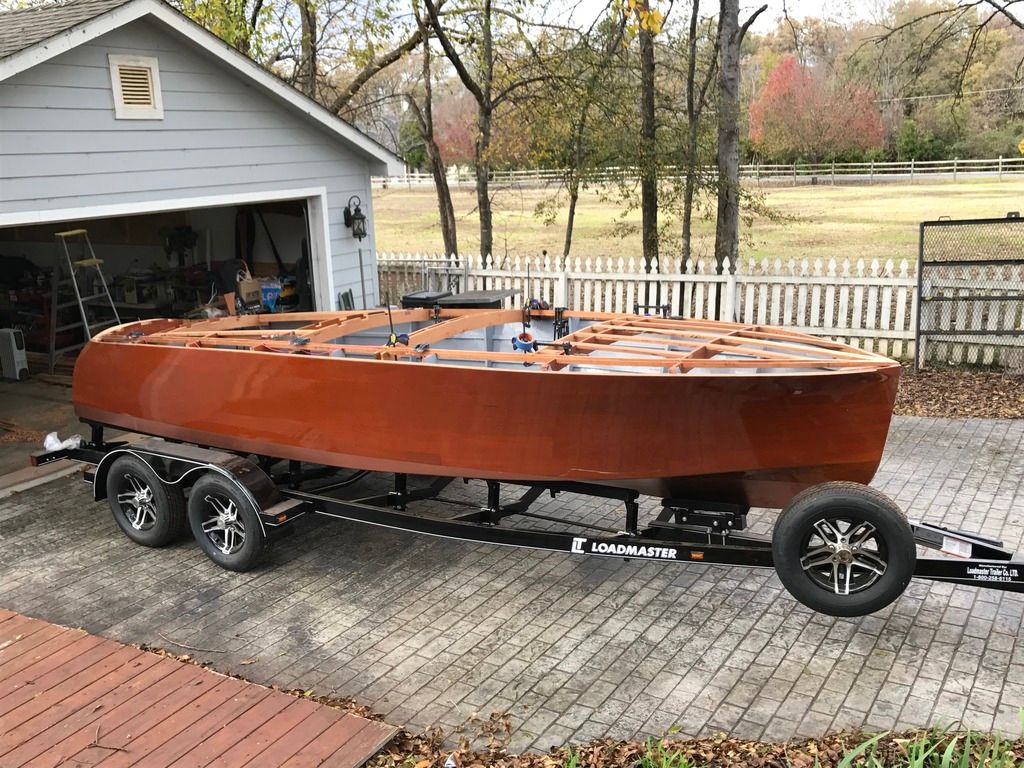

Pulled my baby out of the garage today since the temps were in the mid 60's. Got a little bit of work done and got all the sawdust vacuumed up before putting her back in. . Sure does look different when they are out in the open.
Need to make some more adjustments to the hatch and start working on the sheer filler.
