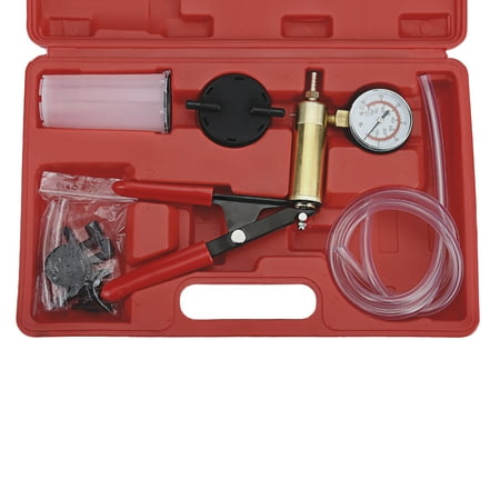

A hand vacuum pump can often be helpful when trying to troubleshoot this kind of problem. You can test the vents and the fuel line for leaks or blockages. Can also be used to bleed brake lines.
