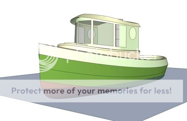

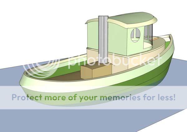

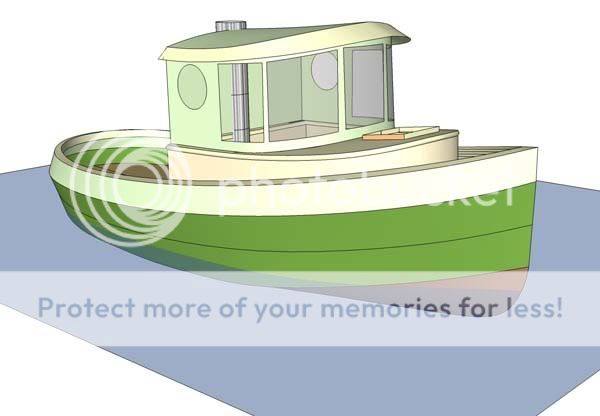

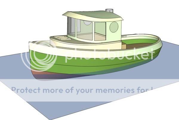

I decided to model this little tug because its lines are much more clean than many small boats in her class. I've included a few views to add to the study plans for the Titan Tug 20 incase anyone is interested in this very clean little vessel. I hope these images will help you visualize her more clearly.
Hull modeling done in Delftship Pro, then exported to SketchUP to clean up and cut windows out. The lines are just an approximation since I don't have plans but she's roughly to scale if the hull is 20' long and about 8' wide.
No details to speak of, just too much work, and no keel or running gear, but everyone can see how cleanly proportional she is, how nicely balanced her hull's sheer, trunk and visor brow? I think she looks nicer in 3D than flat, but I doubt that inexpensive 3D systems were as common when she was drawn?
If any Glen-L'er's are interested in the hull model *.fbm file or the SketchUP model file *.skb please feel free to email at k.morin@kmmail.net and I'll send them to you. There are no costs, but the design IS from the Glen-L book so I would expect anyone receiving these files to respect the ownership and designer's work.
