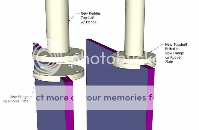

This image shows a welded rudder that was eventually cut to make it removable, the shaft allowance hole is show near the leading edge.
by adding this flange in the center of the rudder the two halves were recovered and in the future it could be removed more easily.

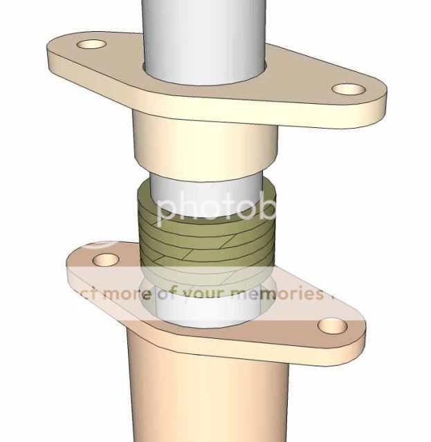

As regards the rudder stuffing box when you use aluminum for shafting. Aluminum will become roughened and begin to abrade more easily than SS so the traditional stuffing box can be modified to allow the less hard alloy to serve. This picture is just a look at the more or less traditional rudder stuffing box.

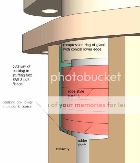

here is a close up cut away of that traditional box/gland/shaft seal and bearing showing the stuffing box 'rope' and how the top and bottom of the chamber will cause the packing to squeeze around the shaft when the top is tightened. That is where the wear on aluminum starts.

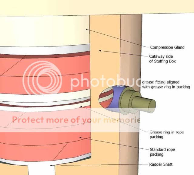

here is one way to avoid premature wear on softer alloy shafts. There is a plastic grease ring in the middle of the rope packing stack that will allow grease from the side mounted fitting to flow all the way around the shaft and into the shaft to packing interface along the shaft's surface inside the stuffing box.
This will allow the grease to be introduced into a very tight space so the 'shear' is much higher and therefore almost no pressure on the packing is needed to give a water tight seal and the shaft wear is reduced dramatically over using aluminum in a convention packing rope sealing application.
