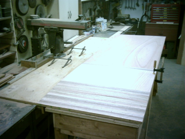

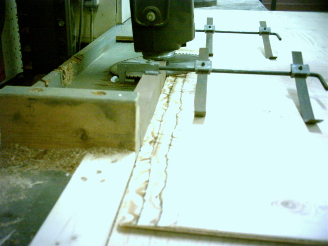

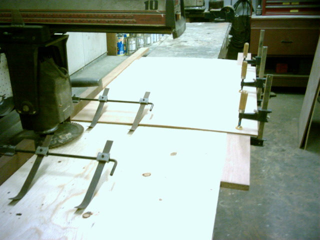

We tried several scarfing jigs but found that the radial arm saw produced very nice scarfs in record time.
To scarf 4'x8' panels on the width, we temporarily fastened a sheet of 3/4" plywood to the saw's apron. A guide strip is clamped to the stock to be scarfed. The strip runs along the leading edge of the temporary apron and keeps the stock aligned to the saw's fence.
Click here to see more photos.
