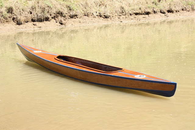

Chillin - Here is how I avoided showing my ugly stitched/uneven seams, very similar paint scheme to what you are suggesting. They were all filled with thickened epoxy, sanded and glassed over to look like smooth nice joints, but they were not. The paint ends right where the taped seams end, so it hides alot.
I think it looks great and people love it... I think I am going to build a kidyak for my kid next, but I have some time. He's only 4months old...
