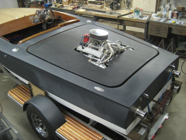

You may get some ideas from Mr Hot Rod's site where he has built at "tonneau" for his Hot Rod.
http://www.boats.chelseacoachworks.com
Bruce.

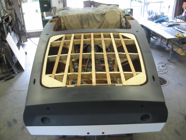

The gaps on our tonneau cover were left rather large because we'll be casting a frameless fiberglass part from the plug. We also left room for a finish veneer and trim around the cockpit coaming. The original idea was to build a tonneau cover to protect the engine bay from the elements while trailering. If we decide to run it full time, we'll have to add a bilge blower and some ducting to provide ventilation.
