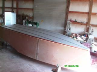

Still working on laying up a backing reinforcement before cutting the door. I do feel better about it now that I've sought some advice. You know of all my build pics my favorite is the only one that seems to show the relative size of the boat, and there is really not much to see in that pic in the way of the final product.
File comment: Favorite Build Pic so Far
