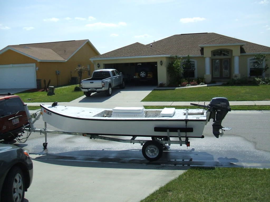

I had considered a SS rub rail, but I'm going to have a pretty decent curve and bow flair. Plus I will be painting the boat and really won't have any wood exposed unless I decide to do some accent parts out of wood, like the poling platform and grab bar, so I think a black rubber rail might match a bit better, but I'm not sure. It will be a flats fishing boat, but I occasionally tie up to older docks and bridges. The oysters and barnicles slice easily which is why I'm looking for an alternative. To give you an idea of what I'm building heres some pics of my last boat before it was wrecked.

Nice looking package there for gunkholing and fishing the narrows too,,, It looks really stable. Get a piece of pvc piece the grey type and slide it over the tiller handle part and this will also allow you to stand up foward and look around as you poke your way into some of the creeks.
Thats really not an issue with bending the rails foward. I do it all the time. I am without my computer with all the "propaganda" shots of boats on it. But if you google simmons sea skiffs you will also find that the foward sheer are is pretty extreme. We start foward and work our way back putting fasteners to hold it in place with another person holding the longer piece section. It does want to twist back flat. I did a popular florida boat plan a Phantom 16 flats boat too with simular rails attached to a painted strip for the rubrails keeping the boat sides way away from obstructions. While many folks here use the plastic rails and black rubber, personally I do not like the hidden and voided area behind especially the rope type rubber rails which dampness also finds a way to hang around. If not for rot, black crude always seems to work its way down from behind them after the boat ages a bit.
