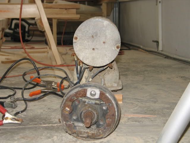

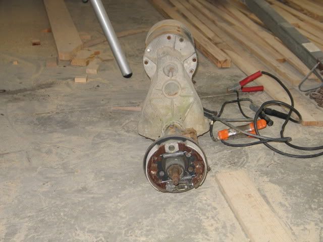

Post by Grand Chillin » Fri Jan 22, 2010 12:41 pm
Oyster,
It looks like your gears are turning now. :lol: Thought it might be helpful if I posted some more pictures. The rear of the differential looks just like the front and here is my current thinking. Remove the brake assembly from the end of one of the axles and using the coupling I found to connect the prop shaft to the axle.
