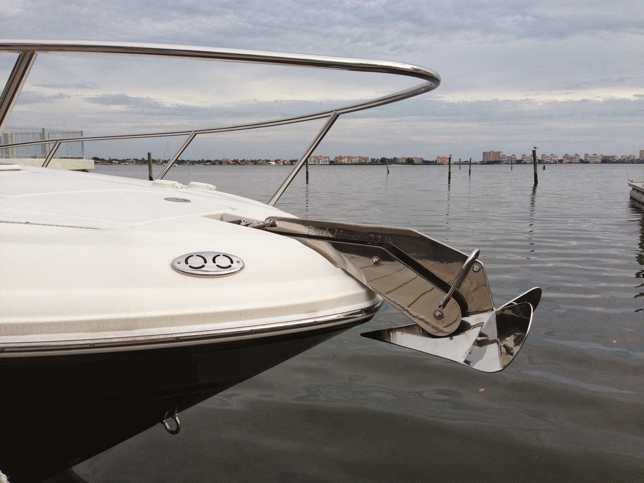

Whenever I've seen something like what I think you're talking about with the roller it also stores the anchor right on the end of the bow like this:
Is that what you were thinking?

Thanks for the responses guys. I'm thinking about what you all have said and still considering options. The picture that Matt posted has especially got me rethinking what might work. Lot's to think about here.
