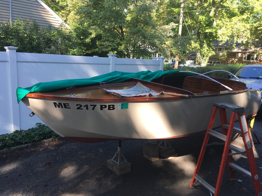

To review, the boat in question is a Glen-L Ski-Tow. Here we are, up on jacks, ready for bottom paint & a few other hull fixes

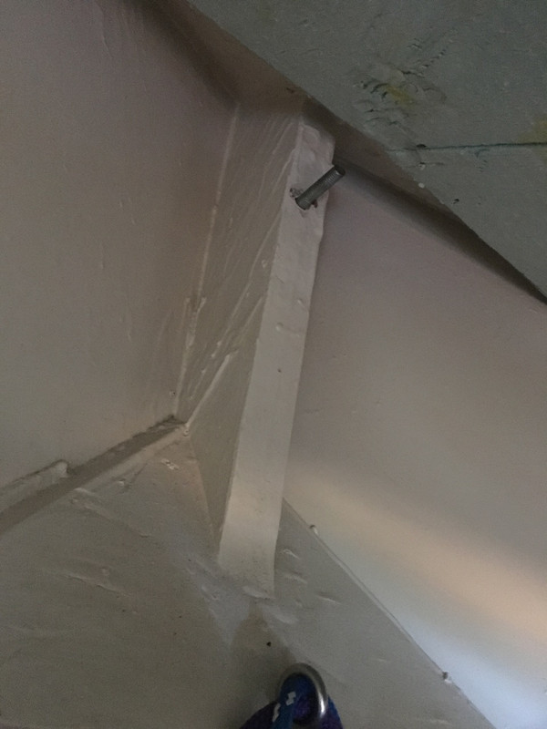

Here's today's issue: the bow eye. For reasons I can only call "born of complete ignorance", I choose a simple Seadog eye from a local marine supply house. Seemed simple enough, and because it threads on to a rod, I could use a longer rod to pass through the stem of the boat (which is much wider than the rod that comes with the bow eye).
This was during construction:

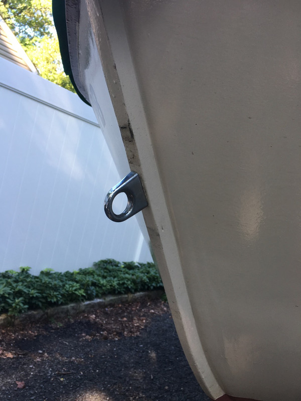

And here we are today:
Over the last 3 years, I've heard tales of horror with these cheap bow eyes. On reflection, they're just crappy zinc die castings, and they simply can't endure the abuse that they absorb during towing. Proper safe towing requires that the bow eye is used to pull the boat into the winch AND is also used to strap down to the trailer frame. Every bump you hit translate incredible energy into the bow eye, and the result is stress cracking in the eye. Sure enough, a very close inspection of mine reveals just that: two almost-imperceptible cracks. Boat owners have entertained me with stories of boats "missing" from moorings because of bow eye failures with these zinc die casts.

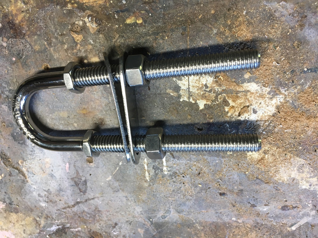

I've heard enough, and I'm changing mine to one of these:
Here's the issue: When I put in the bow eye, the guy at the marina told me to be sure to seal the hole in the bow where the rod penetrates to avoid water coming in. Makes sense, right? He handed me a tube of 3M 4300. [EDIT: OOPS! meant 4200] I I smeared it on the threaded rod, squirted some in the hole through the stem, shoved the rod in, wiped off the excess that came into the hull, tightened the nuts....DONE!
This morning, I removed the nuts and gave the rod a whack with a hammer. Then another. And another.
This rod isn't budging...which I suppose it the reason people love these 3M polyester products. But in my case, I want this out!

I like the idea of using nuts and plates to jack it out. I would have tried that, had I read your reply...but I lost my internet connection shortly after I posted this morning. I'd prefer "force" over "impact" any day... That said, my internet is just now restored (thank you VZ, I guess...), and in the meantime, I got the rod out.
I've taught my kids that if you use a tool in a way other than it's intended to be used, one of three things will happen: 1.) You'll damage the tool, 2.) you'll hurt yourself, or 3.) both. Fresh out of ideas, I decided to "re-purpose" a pipe wrench, and the eye is now out. Happy to report that none of the 3 problems occurred....but I did destroy two stainless shackles.
This rod was held in with 4200 (w/ apologies for my previous misprint), which is a sealant, not a "glue"...so reason tells me that force WILL move it. But I couldn't deliver enough from inside the bow. This needed to be worked from the outside.
Here's goes nothing: hammering on the back of a wrench. Not ideal, but whatchagonnado?
Hey! Is that light coming through a gap? Progress!
I had to wail on the wrench with a 4 pound hammer, but it did the trick, and the structure of the bow is still in tact
Final score: Mark-NJ 1....bow eye 0

Now, the U-bolt that's going in is too short to pass through the stem, but we've got welders at work that make TIG into an art form. I'll get some 3/8" rod, and grind away some material on both the rod and the U bolt to make half-lap joints for a strong, permanent weld, and extend the bolt to fit. Already discussed it with the guys in the weld shop and they "get it". Should be a no-brainer for them.

All I have to do is drill a 2nd hole through the bow, but the holes need to be parallel....how to best insure I don't mess this up?
Step one: The bow eye, as bought, isn't parallel with itself to begin with...take a look:
So the first mission was to bend it until it was. I clamped it in a vice, bent it bit by bit, until my vernier showed it to be aligned to within .010". Next, I took a block of scrap oak and drilled two .375" holes exactly parallel and spaced to match the now-straight bow eye. This will serve as a drill guide:
From there, I made some "clamp wings":
...and added a 3/8" threaded rod...
The rod goes through the existing bow eye hole, and the "clamp wings" sandwich my bow strip. With the 3/8" rod bolted tight, the center block is secured to the bow strip; tightening the 2 smaller bolts through the wings serves to assure centering:
I felt pretty sure that this would yield a straight...and more importantly, a parallel...hole. Time to drill with a new, sharp 3/8" x 12" bit.
Bullseye! Not bad, if I do say so myself!
I still need to have extension rod welded to the new eye, but this looks better and will be a great deal stronger. And it's larger, too...so getting multiple tie-down hooks and chains in it will be simple.
