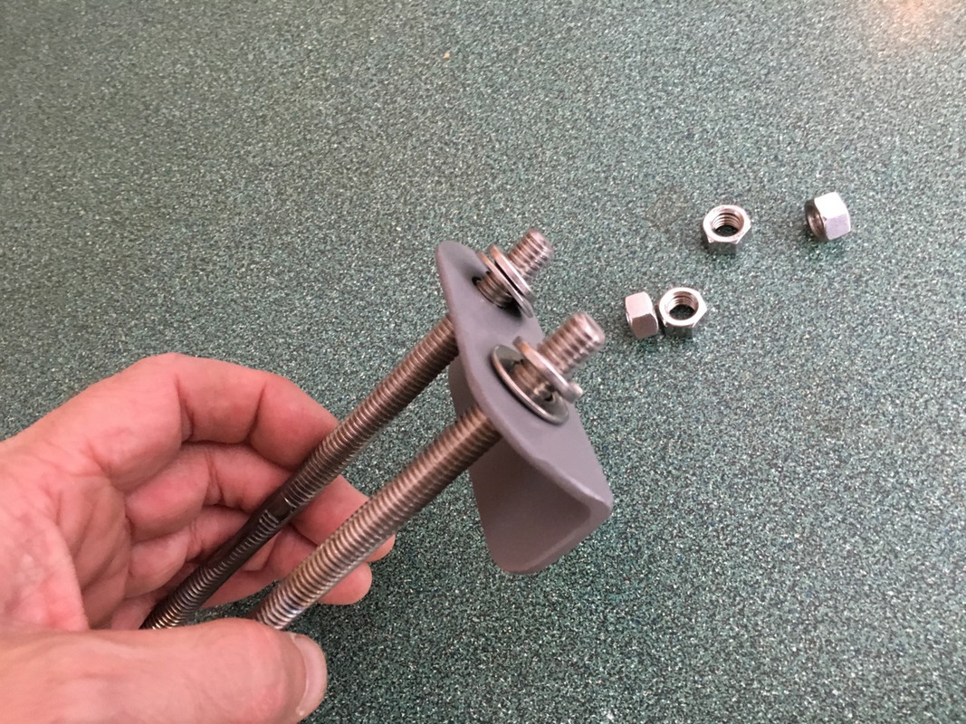

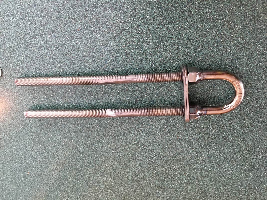

Well, the guys in the weld shop did a good job. They ground away half the material on each piece and made lap joints, so there's a lot of overlap of material. They TIG'd it and got great penetration. I ground & flap-wheeled the finished product clean enough that the assembly would slide into my bow holes. They also TIG'd the front nuts in place so this assembly can't loosen up.

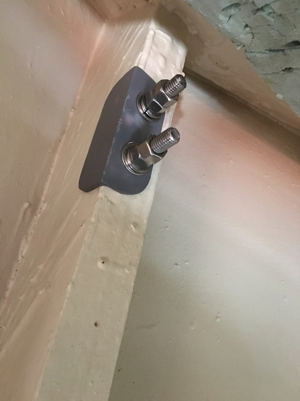

When I took the old bow-eye out, I saw that the washers on the inside of the hull had displaced just a bit into my stem. Not a lot, but you could see the washer's imprint deeper than I liked. Edge-compressing plywood is never a great thing to do, so I decided to make a "displacement bracket" from some scrap angle iron I had laying around:
And here's everything installed. Maybe the bracket isn't necessary, but I'll sleep better at night... :)

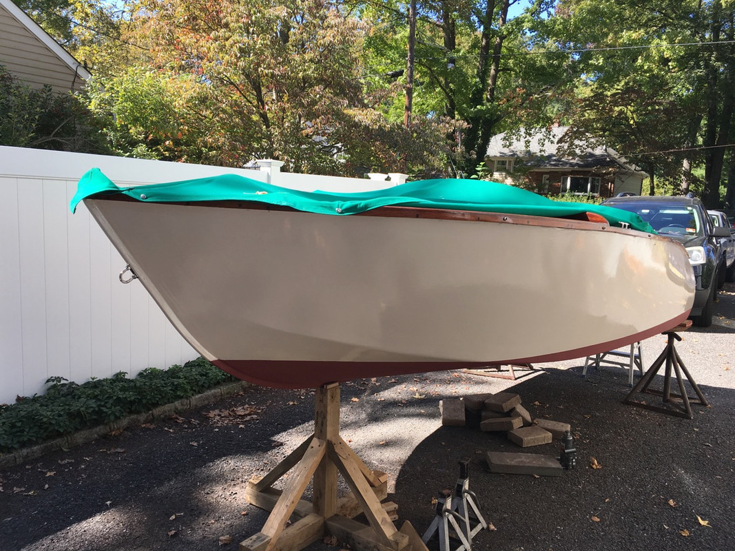

New bow eye installed!! With two new coats of bottom paint & hull paint, everything is looking pretty good!
