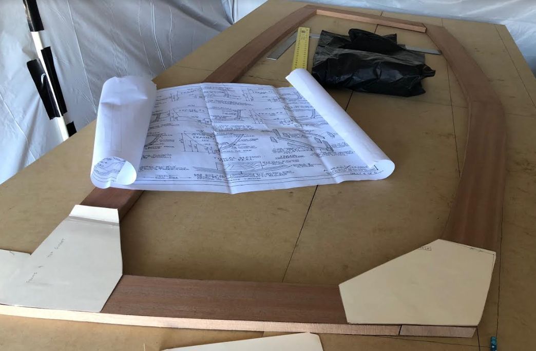

Hello, everyone. I wanted to let you know I have, after 14 months of "research" (including plenty of daydreaming), five months of forum membership, and six weeks of prep work, I have finally started my Mist Miss build. Feels great so far (2 days!) to see actual "boat pieces" on my own workbench, and not everyone else's great builds on the forum.
Some background on prep work to catch everyone up:
  • Received plans from Glen-L in late September
  • Built a "sanding tent" in my garage, using PVC pipe and thick visqueen:
  • Sourced Doug Fir marine-grade plywood for gussets and floor timbers. This included renting a cargo van for the 92-mile round-trip journey to the ONLY supplier in Phoenix that had marine plywood thinner than 1/2". I realize that regular exterior could have been used once encapsulated, but I wanted the "foundation" to be as solid and sturdy as possible. (for Okume or Meranti marine plywood, it'll have to come from Southern California)
  • Built a 4x8 mobile workstation, which is really 2 2x8 sections that can be made into a 2x16 bench, cinched tight with turnbuckles - this was based on someone else's idea on the forum (but unfortunately I can't recall who came up with it)
  • Procured a band saw and table saw, and was gifted a router, router table, and shop vac thanks to a neighbor who was downsizing
  • Picked up 45 board/feet of 4/4 Sapele (on sale!) - enough for 3 or 4 frames, and I'm limited in carrying capacity in my SUV
Finally, this weekend I was able to start the build, which included the plans transfer. I had read quite a few threads on the optimal methods, but the included directions approach actually did me fairly well. I had gotten a 4x8 sheet of carbon paper on Amazon, and even though I winced a bit when cutting the view holes into the plans, the approach worked well. I was able to use one board (roughly 8" wide x 8' in length) for 2 bottom frame members and 2 side frame members without much waste, and then a whole narrower (6") plank for the arched deck beams. I was able to complete frame 4 Saturday and frame 3 Sunday.
I had envisioned completing a full frame (mahogany, gussets, epoxy, fasteners) all at once, and then moving on to the next frame, but logistically that isn't going to work out, mostly due to available workspace. I essentially only have one vehicle spot (plus some spillover into the driveway itself). The next few workdays are going to be "frame member days", with plenty of bandsaw work. Then and only then can I move things around and bring in plywood for "gusset day" (with maybe breasthook and stem), and then maybe a combined "fastner/epoxy" session.
At least I was able to make cardboard templates of the frame 3 and 4 gussets. Also, I have ordered a combination disc/belt sander, which should be here before next weekend. I tried my finishing sanders (orbital and an old palm sander) to remove enough material to get up to my traced lines, but they just aren't able to remove enough material - it would take forever. I'm hoping the belt sander will assist in that.
So now after being a whopping 11.5 hours into the project, I'm really looking forward to it. I'm not sure how much time during the week I'll have, but I'm hoping to have the seven frames, transom, and stem/breasthook fully completed by the Christmas holiday, when I can then start assembly to the stringers. Then it'll start looking like a boat!

Good point, Lee. After a note from both Roberta and Carl (Mr. Intense) on Carl's Vera Cruise thread (viewtopic.php?f=2&t=16739&start=2880#p213817), I've ordered a stationary belt/disc sander (a WEN 6500), which should be here later this week. I am planning on having the garage door open for ventilation.
I did have a question on sanding of the frames: How smooth do the frames have to be? Both in general as well as on the internal edges? The sapele I purchased was S2S, and the bandsaw cut the rougher sides a bit smoother. I believe further sanding to the drawn edges (and then later fairing) will take care of the outer edges of the frame members sufficiently. But with regard to the internal edges of the frames, do they merely need to be sanded/smoothed for appearance and or comfort (no sharp edges)? Should I run them through the router table with a straight bit as a "low-fidelity joiner"?
And Bill, no cooler for the garage. I pop into the kitchen for a refill on a regular basis to let the family know I'm still alive out there. :wink:

Post by mrintense » Wed Nov 13, 2019 2:23 pm
acflynn wrote:
Wed Nov 13, 2019 11:23 am
On my boat, those internal edges will eventually be covered with paneling so I would think simple sanding for splinter reduction would be sufficient. On other boats they are exposed so more dressing work might be desirable. But at least initially, I think a simple sanding will be fine.
Of course if you are going to encapsulate them now , then you might have to go over the edges again, if they are cleaned up further in the future.

Ditto on what Carl said about sanding the frames.
Speaking of belt sanders, I suggest adding some sort of custom shrouding so you can connect the belt sander to a dust collection system. When I built a TNT back in 2010/2011, I didn't have this and my belt sander was the biggest offender in regards to creating dust. This picture shows what I did to my belt sander before I started my Monaco build and it basically creates no dust. It would take more custom shroud work on a WEN 6500 but you might want to consider it.
Yup. Tom

During my lunch hour I managed to trace out both bottom members of Frames 1 and 2 on a single 4/4 x 11" wide board. I was pretty happy with that savings - each of the frames max out at 5.25", so I can definitely get both out of one plank even while leaving it proud.
I also unpacked the WEN Belt/Disc sander and got that assembled and ready to use. Unfortunately, Lee was right. There really isn't any sawdust exhaust port on this thing, unlike the other power devices(band saw, table saw, router table). I was going to wheel it outside to test, but we had a front blow through today, with a 20 degree drop in temperatures and steady rain for the past 10 hours or so. Phoenix really needed it - hasn't rained since September!
