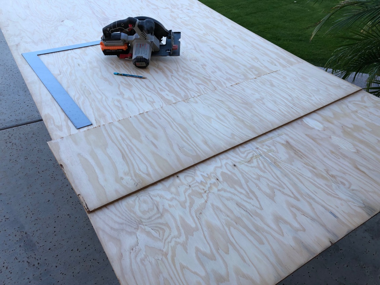

Well, good news, campers - I was finally, after several weeks, able to put together a Plywood Day!
This involved shuffling some cars in and out of the garage to access the cache of marine plywood I had bought back in October.

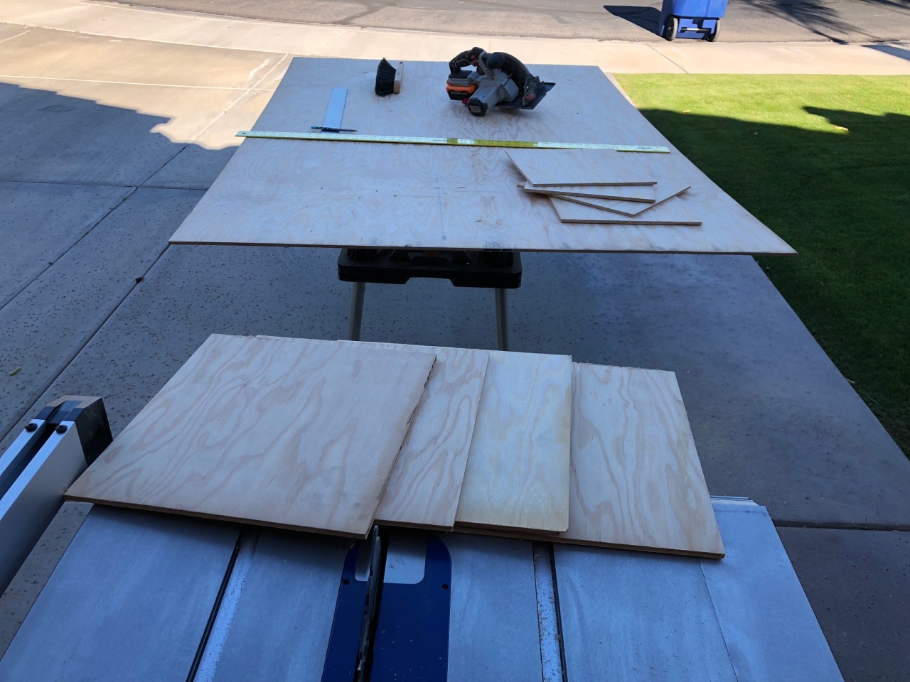

First up was the gussets for frames 1-7. The plans indicate 1/4" ply, and I'm using 1/4" Marine grade Douglas Fir. As you'll recall from earlier in the build thread, I needed to make 52 gussets (7 frames x 4 gussets x 2 sides = 56, and then -4 because Frame 2 doesn't have a top deck beam).
I had already made templates out of card stock, so it was a matter of jigsaw-puzzling them together to maximize plywood usage.

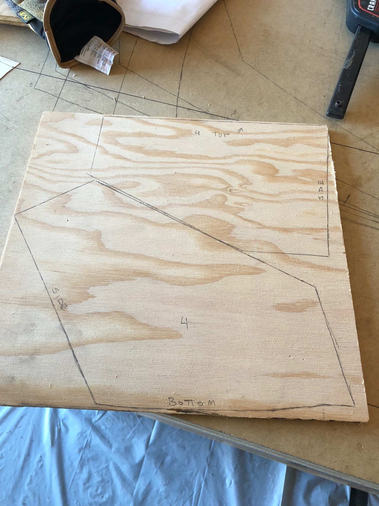

For the most part, if I could keep them in a 12" section (variable width between 12-17"), I could get all of the gussets for an entire frame out of one 4' ripped section, below:
Then I created 4 identical 12" square pieces:
I traced the gusset templates onto one of the pieces:

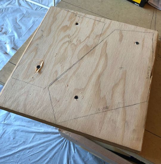

Stacked the four 12"x12" pieces, with the traced one on top. And then using DrBryanJ's recommendation, put in two screws on each to keep from torquing:
And then bandsaw time! The Doug Fir ply was softer and lighter than the Sapele, and I noticed it was "stringier" after cutting. Nothing a sander cant' take care of:

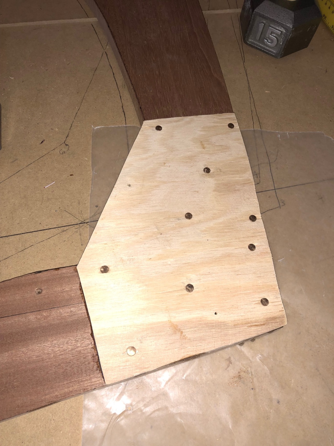

When I last posted just before Christmas, I had manufactured gussets for the entire frame set. But I was hesitant to start "gluin' and screwin'". I started with Frame 2, which is the only frame of the 8 that doesn't have a deck beam, and it has a solid one-piece floor beam, with only 4 gussets. So if I totally screwed up, I'd only be out 3 pieces of mahogany instead of the 5 elsewhere on the boat . . .
Basic observations that I'm sure you all are nodding your head to:
Sanding: I didn't realize how much sanding is needed to get the beams to the exact correct shape. I had left them a little "proud" on the bandsaw, and I'll be re-evaluating that approach in the future. Regarding the dust-collection systems discussed earlier, I'm not sure if it's acceptable by boatbuilder standards, but I took advantage of a breezy day, pulled my work table and belt/disc sander out towards the end of the driveway, and the sawdust dispersed and drifted away. Not much cleanup. I won't be able to take advantage all the time, but I thought that was a bit of good news and hopefully not an environmental hazard.
Silicon Bronze fasteners: It was mentioned in several threads (some from 15 years ago) how malleable the silicon bronze screws were. They couldn't be THAT bad, I thought, so I tested. As long as you pre-drill and countersink, I was able to use my impact driver to sink the screw, unscrew it, drive it back in another hole, and then . . .
That was fun removing. As it stands I'm using the suggestion of driving a same-thread steel wood screw in each hole as a starter, and then only driving the SB hardware post-epoxy. I didn't have many issues with the SB nails. Post-epoxy I quickly set the gusset down and drove a single nail on each member to get it firmed up into position, then waited about 10 minutes (with extra wax paper) to hammer in the rest. The only issue thus far is I'm using 1-1/2" nails, and my 4/4 sapele + 1/4" gusset has them all going through to the workbench underneath. They'll be covered by the opposite gusset, but in case they're not, I'll need to get some slightly shorter nails.
