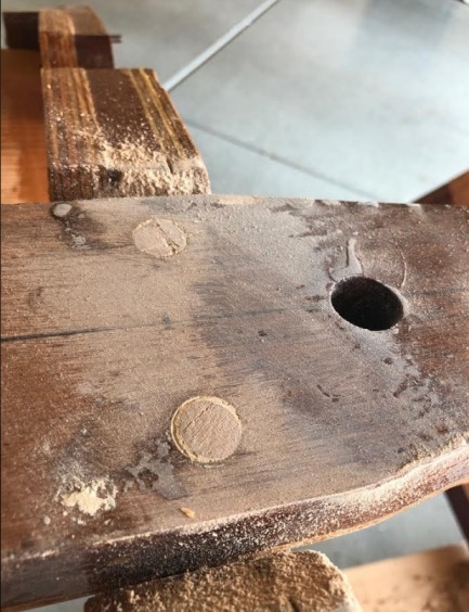

At this point I think bungs might be the way to go, just because of the depth. I used Famowood for covering the screws on the transom and floor timbers on the frames, but those were in-plywood counter-sinks where the #8 screw heads sank themselves (and thus the holes weren't that deep).
With the #14 keel screws (and deeper holes needed due to possible fairing interference), I'll have to go bigger. Fortunately I have plenty of scrap to experiment with.

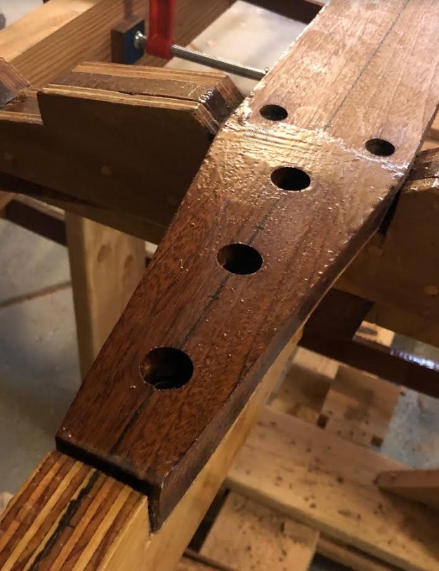

Fairly deep 5/16" carriage bolt holes for the connection between the stem and the keel - the whole head of the keel is slathered in Poxy-Grip, which will be mostly faired off anyway.
Typical of hole for keel-to-frame attachment (two 3" #14 screws). Some wax residue is still visible in there (used the tried-and-true wax toilet ring to provide for strip-free entry of the silicon bronze screws)

I did have some success with the larger bungs for the #14 screws attaching the keel to the frames. They still required a bit of Famowood on the edges. I basically added a dab of Famowood at the bottom of the hole, rolled the bung in it as well to coat the sides, and then hammered in (though I'll have to do a better job of aligning the grain next time). Cutting off and sanding went very smoothly. The remainder of the project doesn't use such large screws (#10's and #8's mostly), so my bung cutter should be able to accommodate and fully fill the holes going forward.

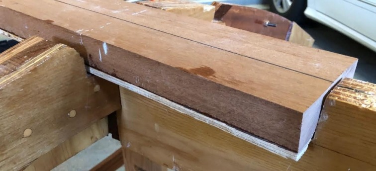

When I last posted, I had just acquired some nice 6/4 Sapele that was milled to 2" widths by 10' lengths, for the most part. Scarfing of these into 20' lengths actually went well (better than the keel, anyway). But re-reading the above post, about the squirrelly lengths, I should have paid more attention to that.

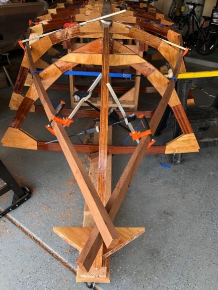

I was able to place the chine logs into the notches I had made in the frames several months ago. Some had to be slightly enlarged (using a rasp file for the most part). Using some come-alongs and almost my entire collection of clamps, I had most of the pieces into position, keeping them looser towards the bow. The chine on the Mist Miss (and probably most designs) has to curve down (up), while curving inward towards the stem, while twisting as well.

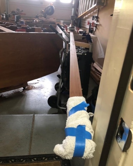

I used the boiling water and hot towel approach, which really seemed to be working. I wasn't going to attach them fully, but I wanted to get them curved in and holding that shape. The next day I would start attaching, and finish the bending, thinking that the chines would "hold" in their new semi-bent position. I was surprised how quickly the boiling water cooled off, but the sapele seemed to be keeping the heat. Seemed simple.

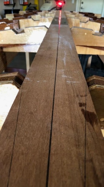

The next morning I went out to check on the chines and prep to do the final alignment. I wanted to do both sides at the same time, alternating to keep everything as square as possible elsewhere on the rig. That's when I discovered this:
This is way back just in front of the scarf joint (which you can see slightly aft of the crack). I never heard the tell-tale "CRACK" at any point. It seems the sapele itself gave up overnight. The orange bar clamp is there just to hold the scarf together (and the white lines are some leftover wax paper scraps), but that joint itself didn't fail, but the wood did leading up to the scarf.
I'm thrilled beyond belief - can't you tell?
Looking closer, it seems that the weird squirrelly and non-straight grain in that area of the plank was to blame. The other side that survived (starboard) had pretty much straight grain from both pieces at the scarf joint, with the odd grained area well aft (and likely to be trimmed off beyond the transom). But it was me not paying attention to the grain when I assembled the scarf a week earlier that caused the issue.

In the meantime, I'm set up to mimic the "Tips from a Shipwright" approach to steaming in place, found on YouTube here: https://www.youtube.com/watch?v=--iPQIwSEJM
I also like Matt B's (Hercdrvr) comment in FL-John's Florida Barrelback thread: "Steam and anger gets the job done."

Hindsight on my chines, I should have laminated. Bending white oak that thick was not an easy feat. The sheer was so easy because that thickness x’s 2 bent so much better. Rita of passage is the proper statement. Looking good.
On the holes you filled with the bungs, I simply used epoxy only slightly thickened. Kinda runny. All the carriage bolt holes. A little thicker on the transom countersinks so it wouldn’t run out. I had no problems of dimples. Your keel will be covered anyway. Fun when you start fairing and your plane gets into those #14’s or the carriage bolts. Plays havoc with an edge. Steve
