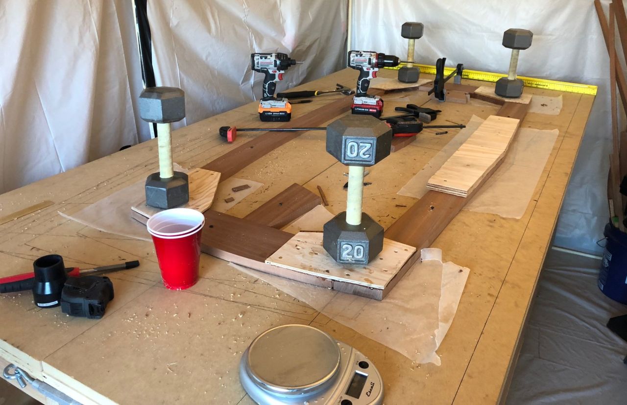

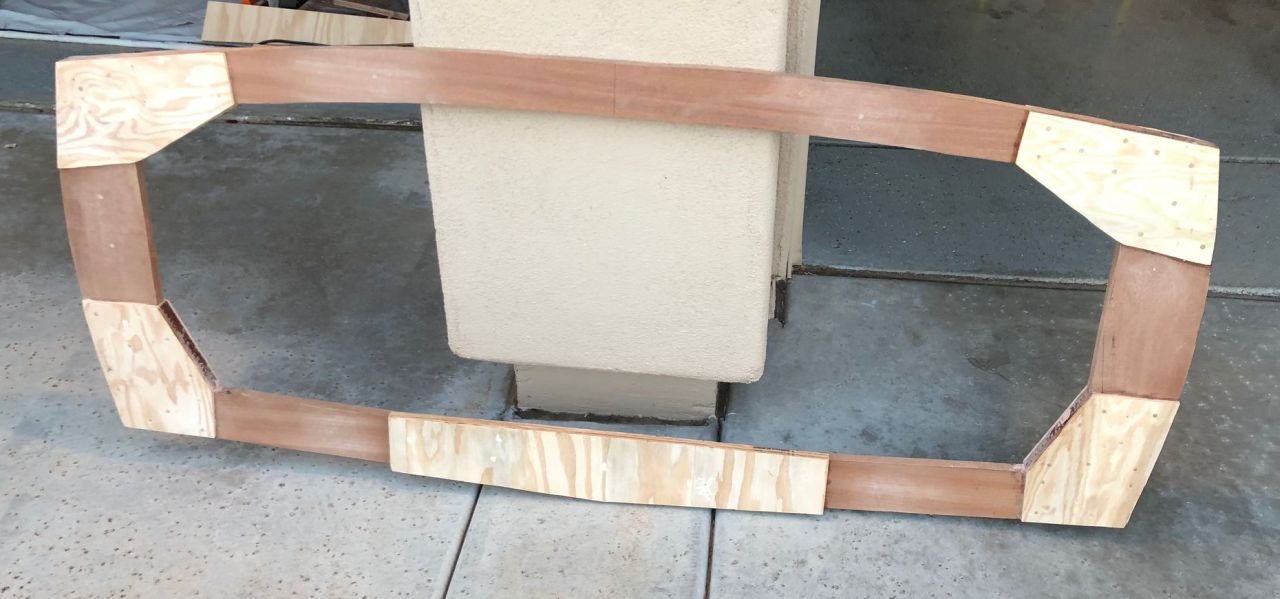

A quick update after a productive weekend. Aside from encapsulation, I've completed the transom (still curing), and Frames 1 and 2. I tackled them in that order, as they are the three frames that are solid across the bottom. Frame 3-7 all have a two-piece bottom member joined with the plywood floor gusset.
Carl suggested putting weights on while curing - I don't think it can hurt!

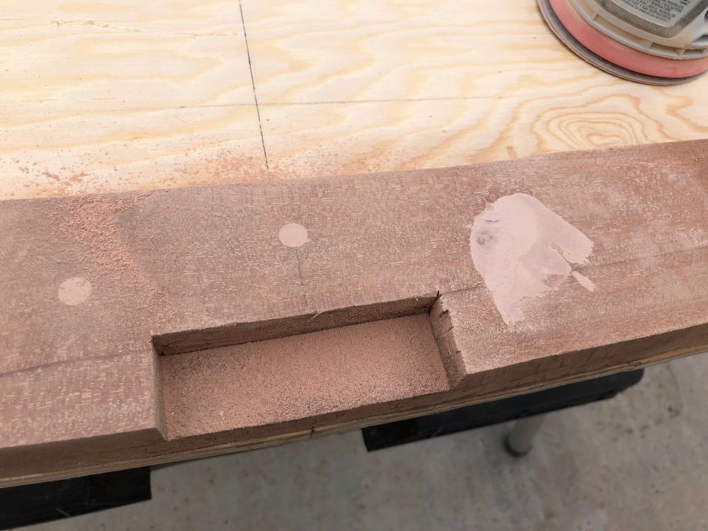

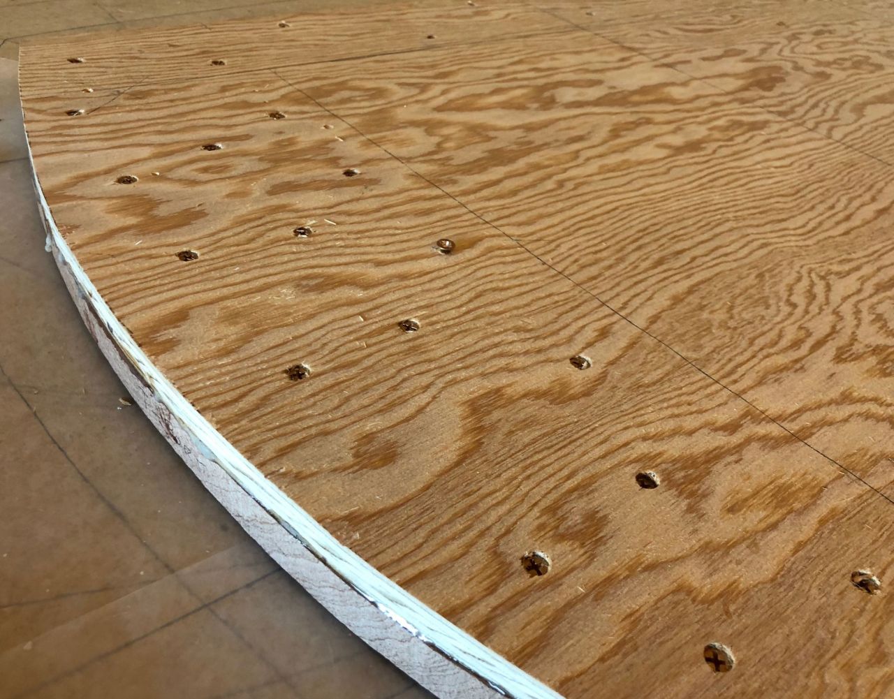

Frame 1 - There's some ground-in sawdust from filling holes used screwing the frame to the layout board I need to remove prior to encapsulation.
I had to break out both the textbook and the instructions to determine that the keel and battens don't go through the second bottom member on this design.

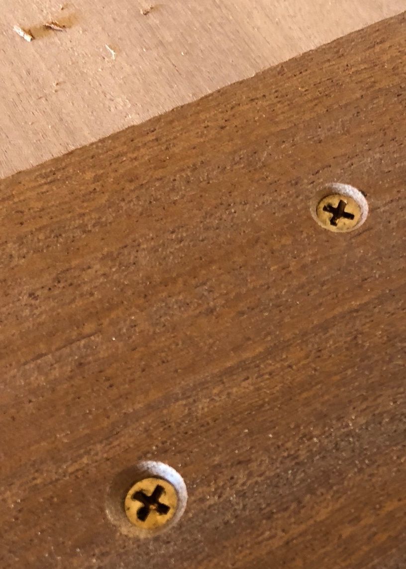

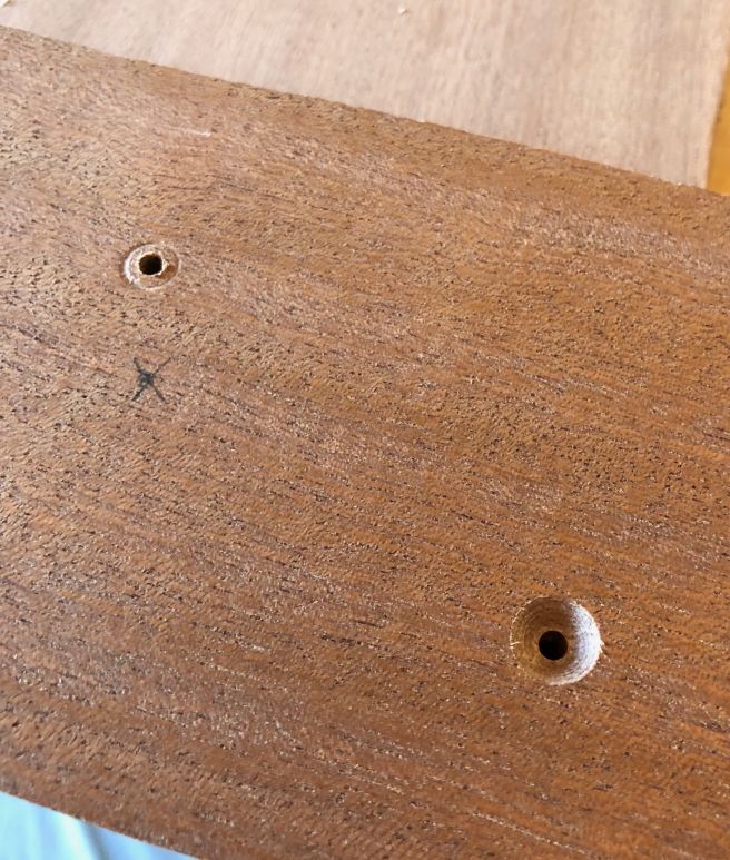

First pre-drill (upper left - the circle is from the chuck, which is also my depth gauge), then countersink (lower right).
You can see that the Silicon-Bronze screw heads show a little warpage from the Frearson driver, but are sunk really well.
I'm pretty pleased with the following:
- The Japanese Gyokucho flush-cutting pull saw was great at cutting out the keel, chine, and batten notches, with the oscillating multi-tool finishing off the backside of each batten cut.
- Famowood. The mahogany color works in tight into the Sapele. I followed some earlier advice on moving quickly and keeping the lid on as it dries out rapidly (I think that was from Dave Grason way back in the day). I'm using maple-colored Famowood for the Douglas Fir plywood, and that usually takes two passes to be completely filled.

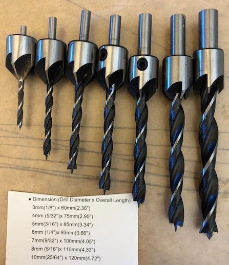

- The cheap-o countersinking set I got on Amazon - $8 for 8 bits, and the results are great. Not sure if it'll last over the course of the entire build, but at that price it's still a deal.
- The 1/4" forstner bit to countersink the nail heads on the gussets. Very satisfied with that approach - thanks to Neel Thompson for that advice.

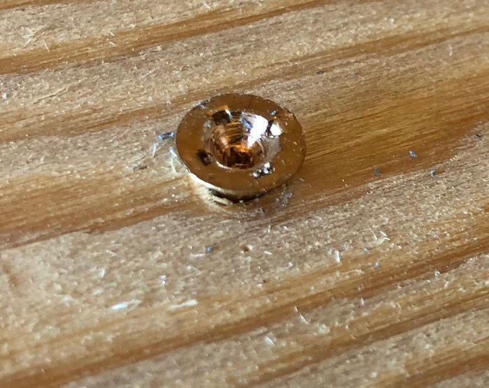

- Silicon Bronze screws. I've learned already that if the threads slip while screwing in (I use an impact driver) even slightly, I've got to back it out immediately and toss it in the waste pile. It's just not worth the risk. My process is to pre-drill, and then countersink if it's in mahogany, but I attempted a few pre-drills with a stainless screw ahead of time (to set the thread). That was a bit too much, as I had two stainless screw heads get stripped, and then it's a whole process to get the non-silicon bronze pieces out of the frame. So now I exert seemingly far too much downward pressure while driving the screws, but it's been successful. Out of the last 60 or so driven, only 6 have slipped. And they may have been fine, but I didn't want to risk stripping the head before it was down all the way, and then potentially not being able to get it back out again. It's working so far, however, and will be worth it long-term as I become more skilled
Two out of sixty ended up with stripped heads
Fortunately they're also soft enough to use the oscillating multi-tool and shear them off flush

We have all had the same problem with the silicone bronze screw heads stripping out. I have sort of learned how to deal with the problem somewhat, but I am going to order and try a Frearson driver bit that Glen-L sells. It is supposed to be the bit of choice for these screws. Maybe others who have used this will chime in here... Neel

Stripped screw heads - get some steel screws for the prep and only put the SB screws in once at the end. Get bits that match the head size and shape and then give the driver a tap to be sure it is seated. Switch to square drive, they don't strip out...the screw head twists off instead.
For big screws, stick with the Frearson heads.

Get a fearson driver like Neal said. Drive a drywall screw first, remove, and then drive the silicon bronze screw. Drywall screws don't strip. When driving the silicon bronze screw, make sure you are squarely on the screw and use lots of downward force on the driver.

Get a toilet bowl wax gasket. Use it to lubricate the screws. You can put the days worth of screws in it at one time.
Re: Mist Miss - Desert Build
In my view, Bill is on the money. I have a graveyard of stripped screws, despite having a frearson bit for my driver...and driving the majority of screws in my build, by hand!
About a month ago, I bought a little block of beeswax. I use a work glove or a scrap of wood to roll the threads across the wax...and can now use my driver with confidence...provided I go slooooow until the screw head is below the top of the counter sink. I still occasionally strip one, especially when I'm not careful to get the driver bit straight, but the wax has been a life...er, screw saver.

Wax definitely helps with driving screws. Toilet ring is a good answer. I use bees wax, but only because my hives provide it for free
A Frearson bit is a must if you have frearson head screws.

I use this countersinking but for drilling the countersink and pilot hole at the same time. I haven't had too much trouble as long as an adequate pilot hold is drilled. This uses an 1/8 inch pilot hole. This works well for #8 (1.25 inch and 1.5 inch) and #10 (2 inch) screws. The #10 2 inch screws need a deeper pilot hole than my countersinking bit will drill so I drill this with another 1/8 inch drill bit after using my countersinking bit. I also drill the hole a little larger (equal to the screw shank diameter) than 1/8 inch on the piece that is being attached (i.e. the piece with the countersink hole).

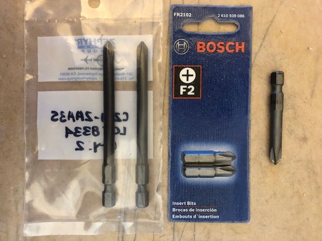

@neel thompson - I noted the Glen-L Frearson bit in the post above. At right is the Glen-L Frearson bit (just right), then the Bosch bits in the middle (too small), and then the 3-1/2" long bits from an outfit called "Zephyr" on the left (maybe too big?). At the time the Bosch set was around $6, while the Zephyr two-pack was maybe $2.50.

@denbrlr - Lee, here's the set I got on Amazon. The smallest one in the set is for #8 screws, and has worked well thus far. I may only be using that and the next size up. I basically use the same process you mention.

Fuller bits work better. They match the taper of the SB screw. Here's an example. https://www.jamestowndistributors.com/u ... lar+Length
