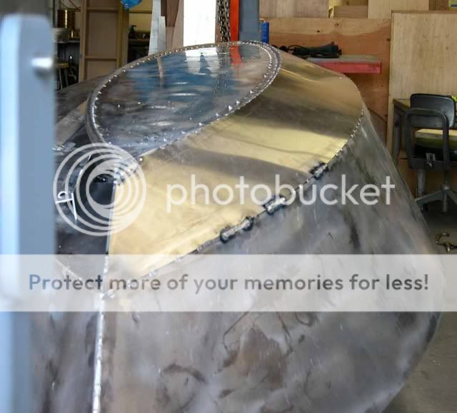

In this photo above she's rigged with fixed seats of nylon truck straps wound on pipe frame thwarts screwed to the side rail angles inside the hull. The deck is 3" deep and runs the length inside of the bow and stern seats. She was an experiment in working in 0.100" thick metal to do welded boats.
The photo above shows; a custom extrusion used at the gunwale allowed a nice flotation chamber if the dory swamped- and a nice smooth shape once welded and dressed off. Shown on a Davis Jig rotisserie fixture for the build.

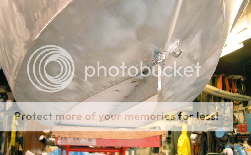

Above, a pic "under her skirts" of the stern and a skeg, the bottom's test port /drain port shop plug and the UHMW 'recessed skid plate' used in the original bottom design. Since changed a bit. She would drag by hand with one man pulling on her painter, so the drag plate does work well.

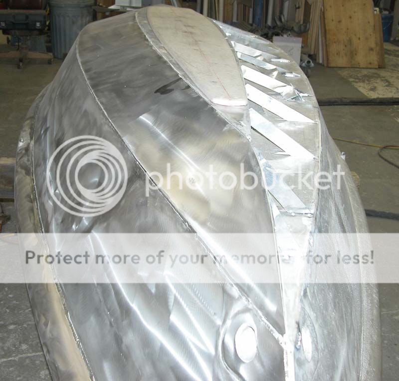

Here is the rebuilt bottom, the recessed plate of plastic for dragging became surface mounted with rounded edges instead of recessed into a pipe 'chine' design that was not as effective as I'd hoped. The entire dory strake was replaced on both sides and the dory shoe was left, but trimmed in Plan View so the dory strake was refit; new.
Photo of the original build with the dory shoe holding a pipe chine - the purpose of this design was to #1 round the bottom seam; #2 create a recess for the UHMW 1/2" drag plate- (aluminum does not drag well on rocks or sand) #3 to fair the dory shoe's edges while fitting the dory strake's lower edge as tangent to this pipe. The pipe was later removed, a new 2nd strake fit and the dory shoe (bottom plate) was then trimmed in making the bottom narrower by nearly 2" and increasing the angle of the 2nd (garboard) plank. Hollow bottom is shown as the deck is the surface 'below' (boat is upside down) the dory shoe.
