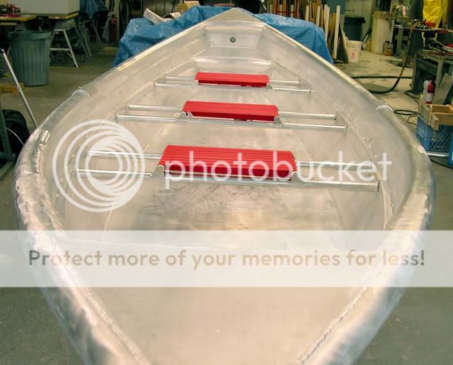

I have been looking for a project to develop my welding skills with my Lincoln Electric 140HD (Home Depot) welder. When it arrives from the East Coast by Yak caravan book rate postage I will read Stephan Pollard's "Boat Building with Aluminum" recommended on this site. My welder supports a spool gun but after reading the thread on this board I do not want one, looks like a lot of trouble. I also do not want to weld in my garage I do not like the fire hazard. Welding outdoors the Argon shielding gas would blow away so I am kicking the aluminum can down the road if I do it at all.
A Harbor Freight birthday coupon was burning a hole in my pocket so I bought the pneumatic nibbler and the flange-punch tools.
I was intrigued to find this thread https://www.boatdesign.net/threads/my-o ... EWuPJ7cJmM and I am just finishing up my Glen-L stitch and glue plywood RowMe so I think my pandemic fall winter project with be a tape and tack 16 gauge steel RowMe using inner shield flux core wire in my Lincoln Electric 140. Attached are some pictures of some recent welding projects the largest and most accurate to date being my router sled for live edge table tops.
I welcome your steel boat building, welding knowledge, advice and experience. Thank you, Leland

I see that the person in your link did make a boat, rather surprisingly. You will be challenged using 16 ga. material. The only thing I can ad is keep gaps as small as possible.

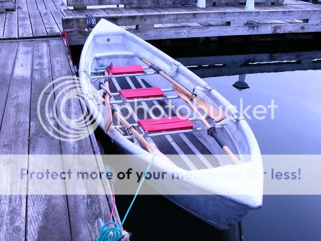

I've made boats similar to the one you're showing in different images and vaguely similar to the link of the small rowing skiff (semi-dory?) and so I have some remarks based on experience. I have also built in welded aluminum for many years and have done boats from 42' to 30" with a pretty wide variety of scantlings; from 0.040" up to 1/4", 3/8" and 1/2" plate.
17'-2" LOA, Chamberlain gunning dory (copy from J.Gardner's Dory Book) of 0.080", 0.100" and thicker extrusion at the gunwale, 5052, 5086 and 6061 extrusions. Double bottom and air chambers in the ends and gunwales- all welds air tested to 2.4 psig. ready to row, still weighs 168 lbs ! so even making a boat of thin material- welded aluminum can add up pretty quickly. This was not my first welded boat it was #'ed somewhere over 100. Level of difficulty was pretty high and would not recommend a new builder try this material thicknesses for a first project.
Here, are a couple of rules of thumb that I think are relevant to your learning as regards welded aluminum boats.
First, welding 5000 and 6000 series (considered "marine" aluminum) thinner than 1/8" becomes more (and more) difficult to do successfully (clean, uniform welds, with minimal hull distortion) for every 0.025" thickness you reduce the materials.
This translates to 0.125" (1/8") being 'simple' to learn to weld - still requires hours of practice and a hull design where joints are mostly 75 to 90 degrees not 5-15 degrees between hull panels along the main lengthwise seams. However: at 0.100" or 0.080" the skills required go up by 2x for each thinner section parent metal.
Next Rule of Thumb: Smaller boats, rowing boats, prams, punts and other light wt. less than 15' LOA usually have a wt limit to be practical. That implies hull and framing materials that are proportional to the overall finished boat. This again implies the materials generally be less than 1/8" thickness.
For example a 15' row boat built of 1/8" 5086 material would probably weigh 120lb for hull sheeting alone? add some framing and gunwale extrusion and I'd estimate we'd be looking at nearly 200lb for this size and hull type. (complete approximations only!)
In thin plywood, the boat would weigh a fraction of that for this size class. However once you begin to thin the scantlings down to reduce weight, the welding becomes many times more critical and complex. Not saying it can't be done... but I'm implying the level of difficulty has gone up quite a bit.
Last Rule of Thumb for consideration: welding two thin sheets of aluminum (even 0.040" thickness) at 90 degrees to one another is 5 to 20 times easier than welding the same two pc with a 25 degree angle between the two pieces.
This goes to hull design or boat shape, and looks at the Body Section to help guide the designer/builder/welder by examining the Stations' hull panel angles to one another. You show as round bilge hull form (like the default in D'Ship) that you perhaps added hard chines too? Then a similar rowing shape was shown in the link- laid out and tacked up? in Body Section, the chines or 'creases' between hull panels are the edges of developed plates and will be the hull's weld seams.
If these seams are left as shown in the screen dumps and the linked images; there is little way to MIG weld these seems without having many 100's of hours of weld time. Further, even then, the seams as shown very likely didn't come off with a smooth hull. And further yet; the quality of those seams, fitted as shown and welded with wire larger than 0.23" dia. is almost assured to turn that tacked up boat into a "pretzel".
If you're going to give a welded boat a try? which I'd encourage you to do, as they are nice when the work is done. I'd encourage you to build in the 18' to 20' range our of materials that are 1/8" and thicker as the odds for success are greater due to the issues of MIG welding "scale" or proportionality.
And last, I'd suggest you consider a 'hard chined' power boat, even if it's low powered so the hull welds are mostly 70-90 degrees. There are several nice looking boats in the Glen-L catalog in this class- Chinook is a good beginner boat, for example. Some of the smaller and flat bottom designs in wood could be converted to welded aluminum but then you may be designing your own boat too?
Hope this attempt at explaining my experience with welded aluminum boats is helpful in your exploration of the subject. I've read Mr. P's book and would refer to it as an overview of the subject and his remarks would have to be taken in the context of the boats he's describing- not a thin skinned row boat!! And especially appreciate that he takes welding for granted!

Yofish, thank you for your guidance I have been thinking about how I could fold along the chine and make a lap weld the length of the keel but not sure how a backyard builder could make that bend on the chine.
Kevin, thank you for your well thought out reply and guidance. The Chinook looks a little big for what I want to build and I think welding aluminum is difficult and has to be done indoors so I may build a little steel row boat out of 16 gauge. More planning, reading and studying ahead for me and maybe some researching on Dutch steel prams and work boats. I may get some 16 gauge mill finish steel and make some buckets and see if they will hold water with a flange and lap weld for the bottom. By the way the flat pattern picture above is from the FreeShip manual not from my RowMe model I am still working with the model to figure out how I can make 1/2 the bottom and 1 side as 1 piece with a bend lengthwise along the chines so I can lap weld along the keel. After I figure that out I will add a transom face and move the faces to layers and develop the plates. Leland
