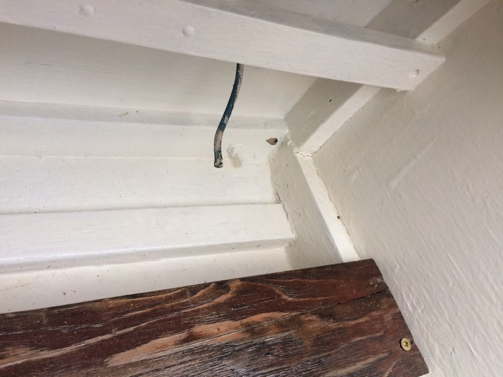

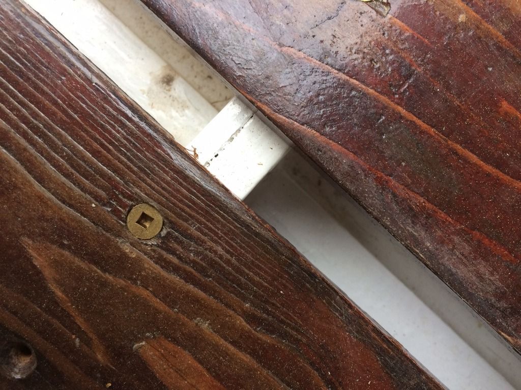

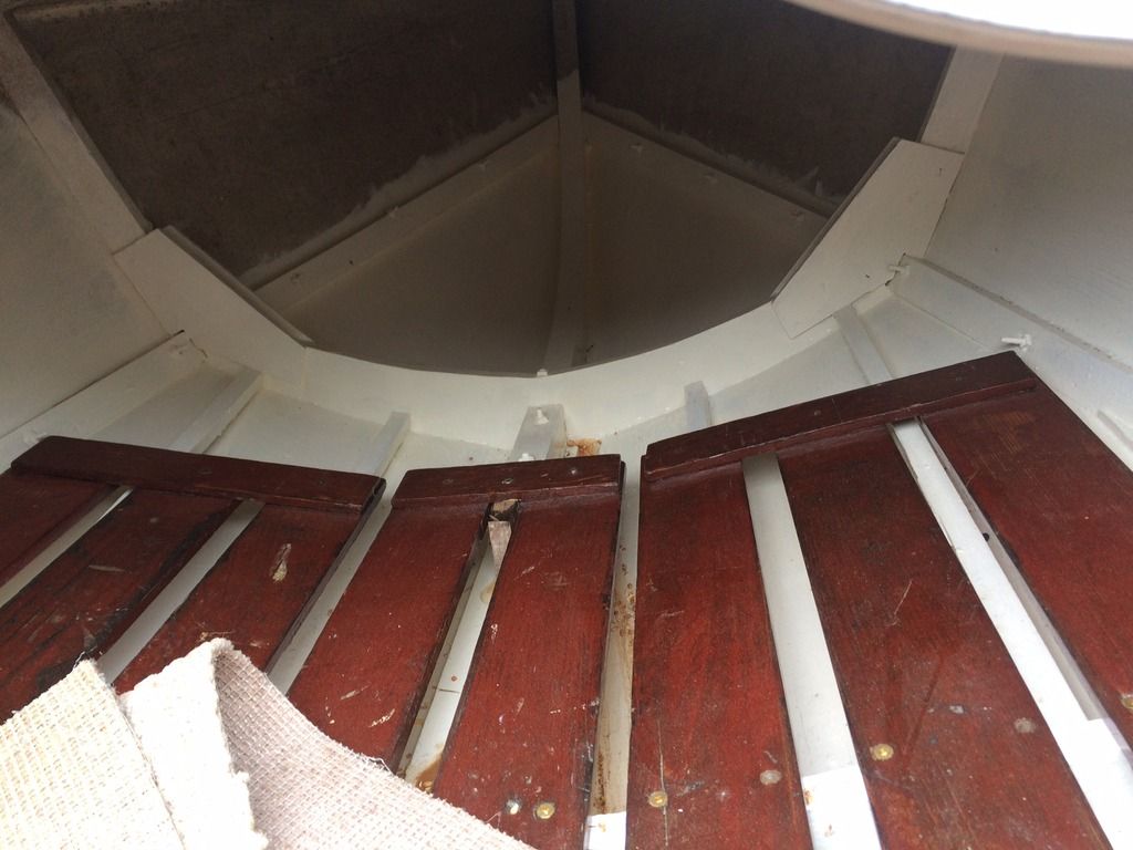

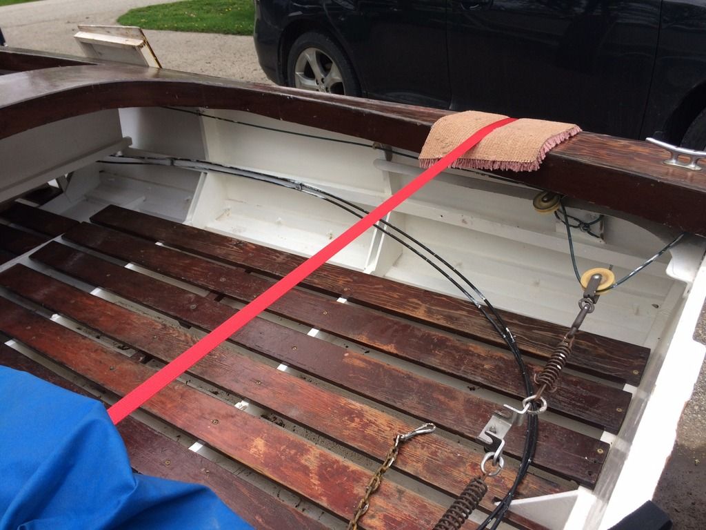

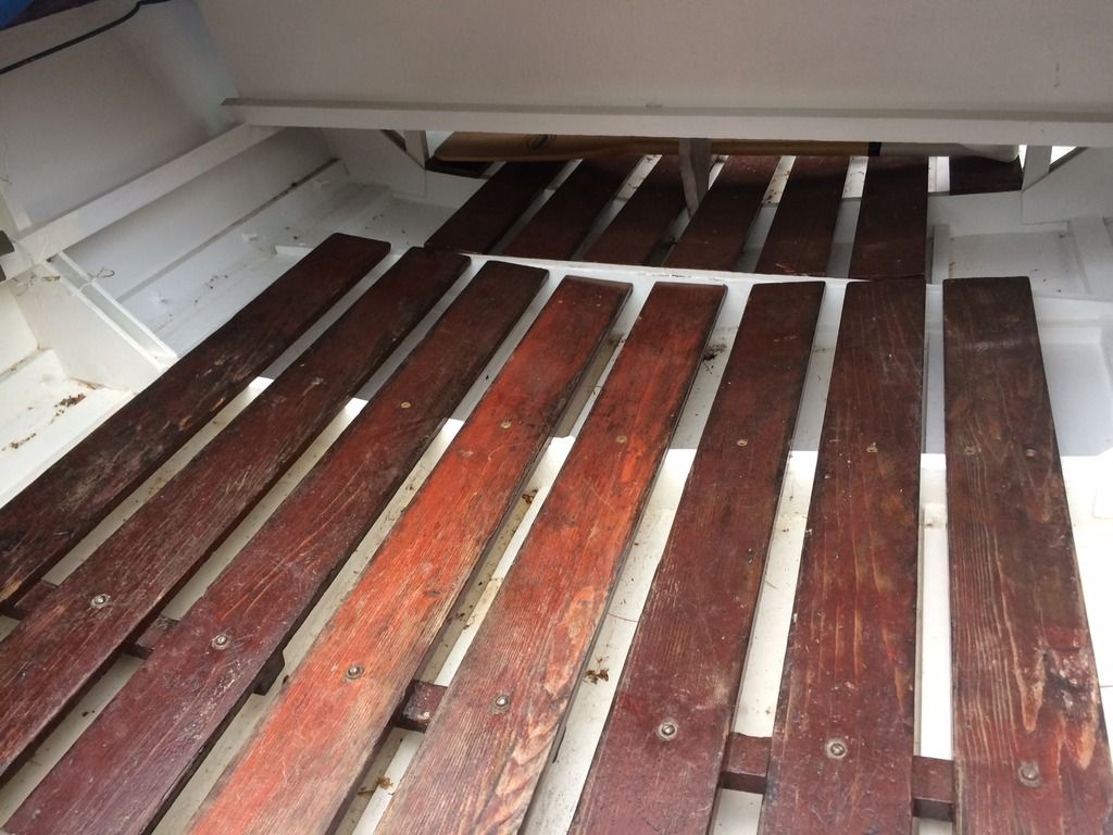

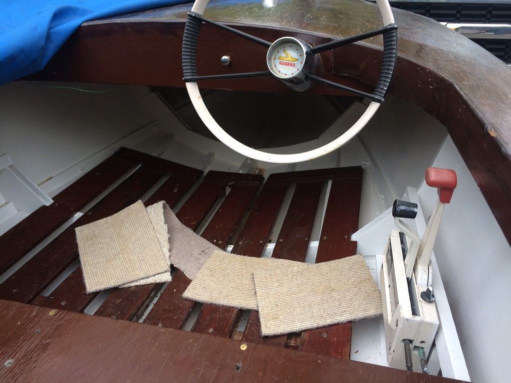

More photos...would love to hear any information about this boat. The PO said the steering wheel indicated it was a kit, so I'm wondering if it came with all the materials cut to size, or if it was hardware and a set of plans. I'd be interested to know if this was one of the earliest kits for this boat.

Not a fan of these splits in the frames from fastening the floorboards. I'd like them to lift out, however I am wondering if they actually help stiffen the boat.
Someone mentioned battens...They are smaller than the ones shown in the photo example. Probably 3/4 x 3/4 or 3/4 x 1 at most, but yes they are there in the same locations as the example photos

Post by Andy Garrett » Thu May 25, 2017 8:01 am
I'm not sure that's a Zip.
Andy Garrett
Perhaps the slowest Zip build in Glen-L history...
Posts: 6404
Re: New to me Glen L Zip - what size motor to use?
Post by Roberta » Thu May 25, 2017 8:13 am
I have to agree with Andy. The construction greatly differs from the Zip's of today. I somehow don't think they changed that much.
Andy Garrett
Posts: 1328
Joined: Tue Aug 31, 2010 11:44 pm
Location: Nampa, Idaho
Post by Andy Garrett » Thu May 25, 2017 8:19 am
Yea..., I'm pretty sure that is a different design.
A Zip has 4 frames including the transom. Your boat looks to have 6.
The first frame up under the deck is visibly different in contour profile than that of a Zip.
The batten design is very different as well.
I'm not sure if the double gusset upgrade was published for the Zip in the 50s either, but maybe--and the builder could have come up with that on their own I guess.
This would all explain the differences at the transom I mentioned before.
If this is in fact a Glen-L design, it might be a Nimrod or Ski Tow (just guessing based on size and hull shape).
If you could provide accurate measurements of your hull's length and beam (width at the widest point) maybe we can properly identify it.
