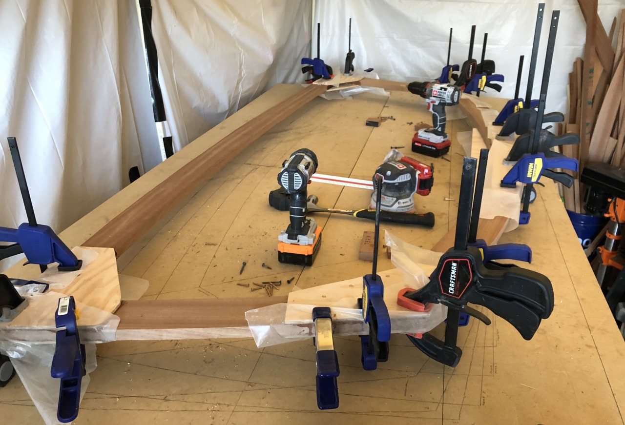

Quick update after some work in the shop today. Frame 3 is completed on one side. I have to come up with a better strategy for aligning the 3/4" plywood floor gusset with the two (port/starboard) floor frames - they join together under/over the gusset on the centerline. I did it a bit blind, and I'll have to trim off the excess plywood overage, but it's on there centered and correct.
+1 for the toilet ring wax mentioned earlier. Good solution for $2.39. I let the clamps set up with the epoxy, and as the epoxy was starting to come up the pre-drilled holes, sank the SB screws with the wax. So both wax and (still liquid) epoxy. Hopefully that covers it.

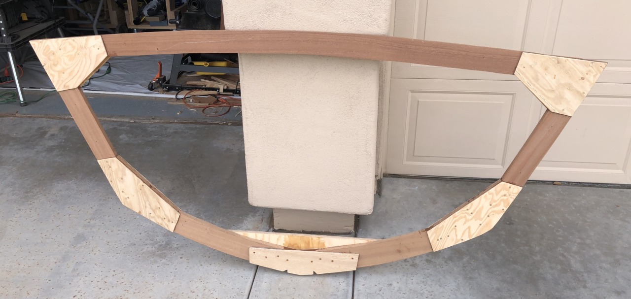

Frame 7 Completed!

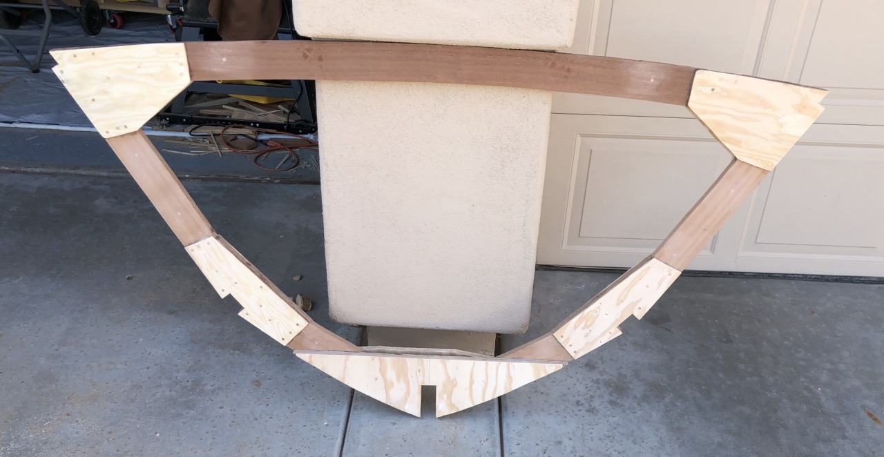

Frame 6 - since completed (needed batten, sheer, chine, keel notches when taken)

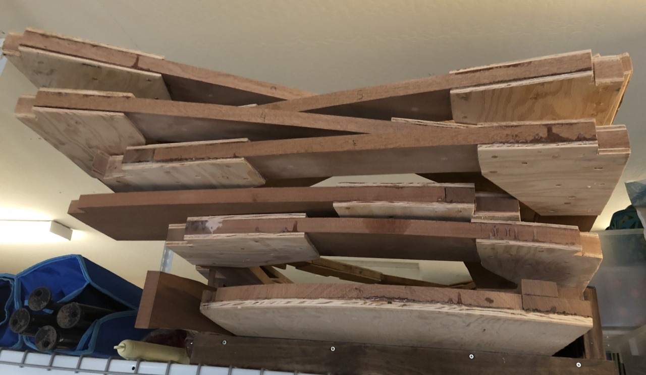

A stack of 7 frames and a transom in my overhead storage rack, awaiting encapsulation and setup
Some of my new clamp acquisitions

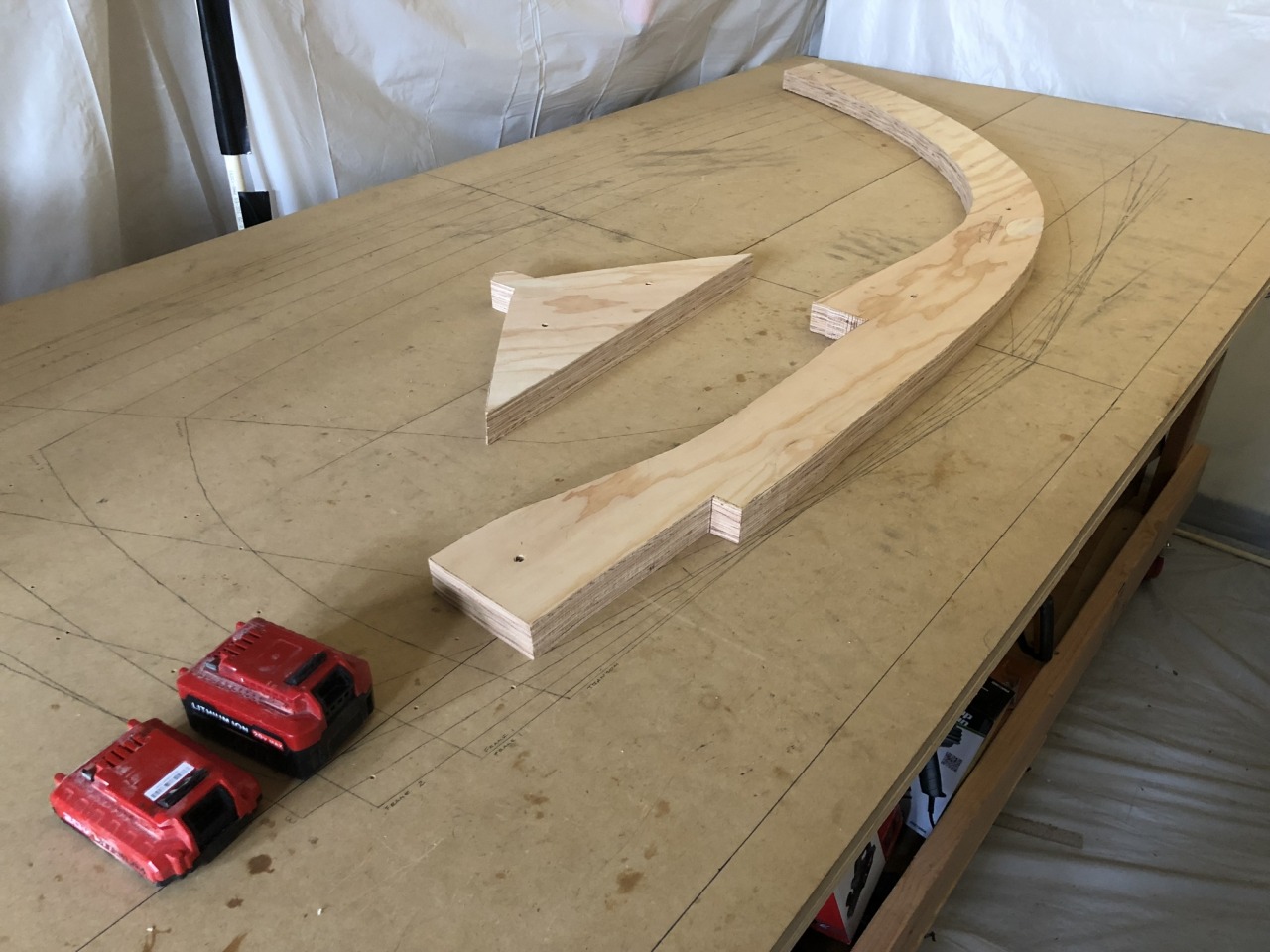

Now working on the stem and breasthook. The breasthook should be fairly straightforward, not that large.
However I did have a few questions on the stem:
Any strategies for epoxying the two sheets of plywood together? This will be the most Poxy-Grip I've used in one session. I wasn't sure if there was a preferred approach in terms of starting points, clamping, etc.
Secondly - is it acceptable to have all of my screws go in from the same side (say the starboard side)? Or should I place them on both sides? I'm guessing the additional weight of the screw heads being on the port or starboard would be offset by a can of soda, so I don't think the boat will list in one direction, and it seems like it would be a hassle to flip to screw in on the backside during the epoxying proces. I don't really need to juggle that as well, do I?

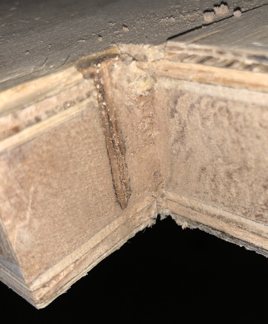

Whoops! It seems that mistakes just don't seem to be entirely avoidable. Planning to keep the impact of them to a minimum is the key. This is what's left of a 1" SB RS Nail too close to where the chine notch is. Fortunately, there's 11 more on that side of the gusset.
Frame 7 Completed!

Good job getting the frames done. They look good. As far as the stem and which side you screw from, you definitely don't need to worry about the weight of the screw heads. The Monaco plans call for ring shank nails for the stem and that is what I used but screws will work fine. I would put them in on the same side to simplify assembly and clamping. I pounded the nails in on mine and then clamped but remember, you don't want to over clamp and squeeze too much epoxy out. I would do something to help ensure the stem stays straight. Thicker plywood does a good job at staying straight but still something to watch. This is how I clamped mine. The table helped keep it straight. I used a three inch disposable putty knife to spread the epoxy. It really is fairly easy to spread on the stem pieces. Good luck.

Keep your fasteners away from the leading edge of the stem so you hit them during fairing.
PoxyGrip would be great for joining the stem halves. And as far as fastening, Screws, nails, or just epoxy only....that stem ain’t coming apart.

If you can determine where the bow eye will be now, drill the hole while the front edge of the stem is still square.

Bill Edmundson wrote: ↑Tue Mar 10, 2020 6:55 pmIf you can determine where the bow eye will be now, drill the hole while the front edge of the stem is still square.
I agree with this as it is more difficult to do later. I would add however that be sure you have the one you want first. I bought one of those single threaded rod bow eyes initially and drill the stem for that. Later I had to go back (after the boat was skinned) and plug the hole and redrill for a two threaded rod bow eye after I realized the single thread wasn't going to be strong enough.

Lee, I'll go ahead and do the one side, and keeping the stem straight is a good point as well. Looks like I'll need more wax paper.
Matt, great point on the fasteners - I think the above image of the nail is enough to remind me of that. Was planning on PoxyGrip + the screws recommended in the plan.
