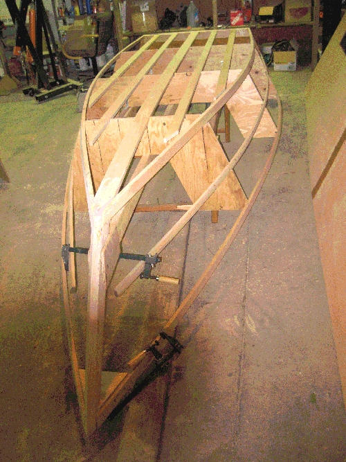

On reading your #12 newsletter, I had to smile. I too had a “holy cow” moment when I was looking over my new set of boat plans. Then I thought there were too many drawings and not enough dimensions to go around, and I was even more confused. Fortunately, I had picked the Power-Row Skiff so I had one flat surface to use as a reference. After much head-scratching, I cut out the forms and the transom. Then I built the space-frame and mounted the forms, transom and the stem where the drawing said to put them.
Still scratching my head, I attached the keel, which tied the stem to the transom across all the forms. At this point I was taking it all on faith, hoping the written instructions were going to work.
After that point, I sat down and looked at it for awhile. I read Payson’s book on Instant Boats, and he finds a ‘thinking chair’ to be an essential part of the shop. Now I know what he meant. After some time in the chair looking from the plans to the barely attached pieces on the shop floor in front of me, the light clicked and I could see how the rest had to fit together.
Michael's Power-Row Skiff
The rest of the inverted construction phase went pretty well. The part I most feared, getting the side planking to meet on the bow, came together just fine. The gap at the plywood’s end ranged from zero to 1/8″. The plywood screwed down to the stem itself tight with no odd bends or twists at all.
I just put the fiberglass on the bottom this morning. I have no doubt I will be able to finish this project in good order. My next boat is going to be a Minuet. No straight lines anywhere, which is what prompted me to try something simpler–and I wanted a fishing boat anyway.
