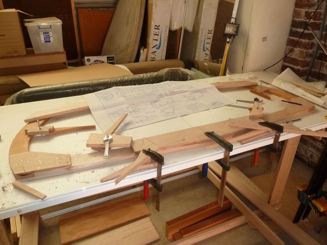

The general arrangement of frame building is shown here. The great thing about a scavenged piece of wood for the layout table is the ability to drill many holes without issue. This allows a good rigid clamping system to be used to hold everything stable during gluing and nailing/screwing. Rather than tracing out the full lines of the frame on the table, only 5 key control points were marked out - indicating the center of the keel, the chines and the sheer. These were carefully checked to ensure a square and symmetrical frame.By the end of May 2012, a pile of frames had emerged from the construction process and were proudly hung up to admire. Once you get into the swing of the process, they do appear quite quickly.

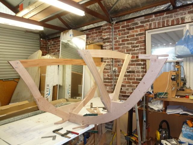

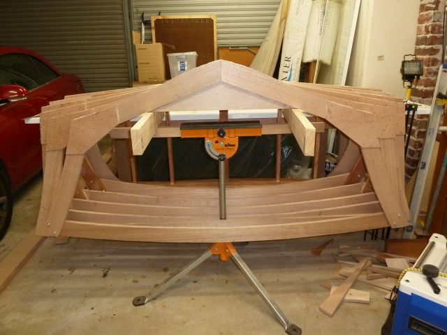

The final pieces of the frame - the bow section components - were straightforward pieces to handle with bandsaw and jigsaw. They were then pieced together (left) in order to admire the emerging size of the thing!
The transom (right), on the other hand, is quite a complex piece. Thanks to Mark Bronkalla's excellent web-site on his Riviera build (www.bronkalla.com) which really is a must for any newbie, I was forewarned about this aspect so at least knew to expect pain.
