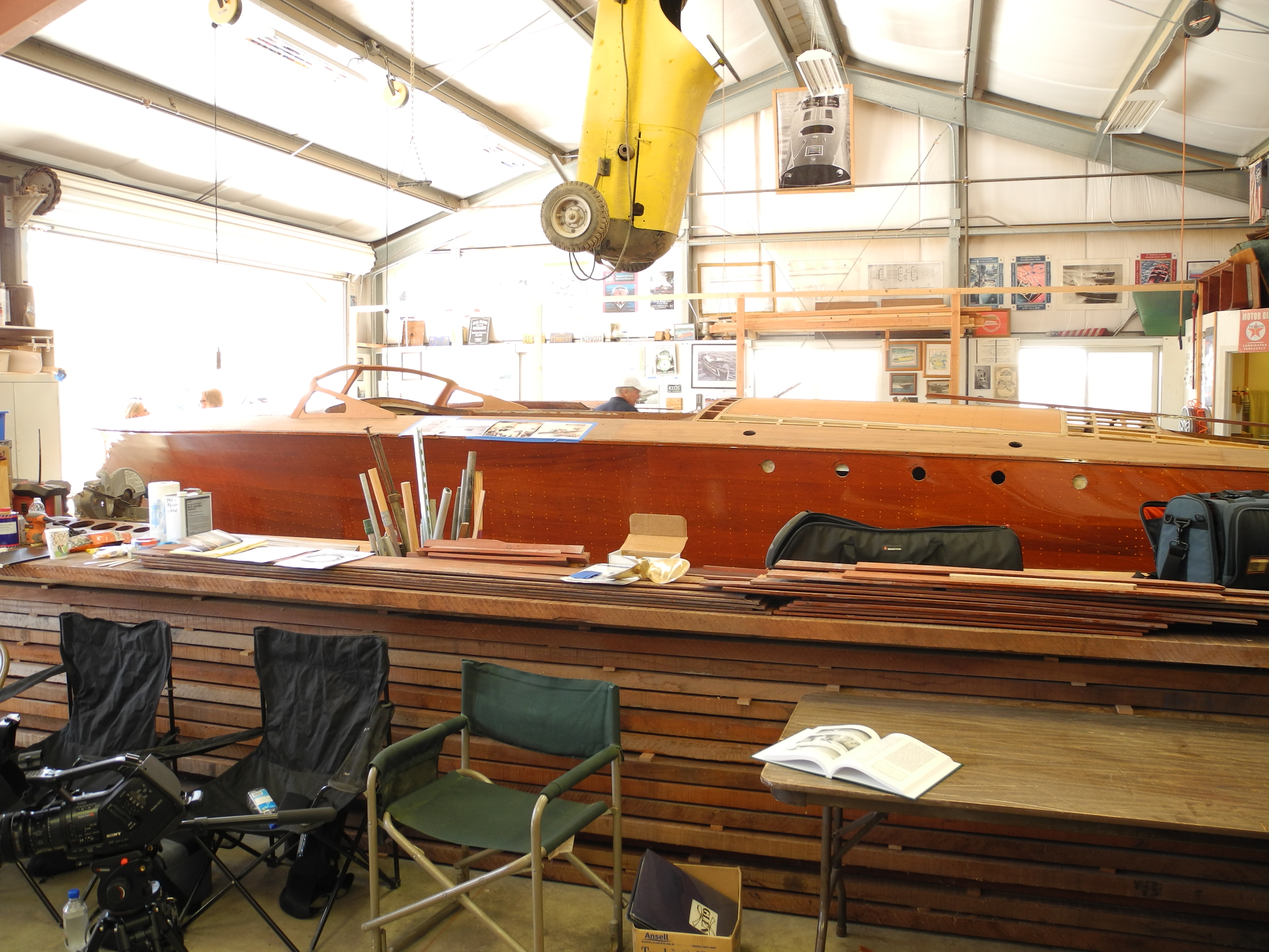

- In classic boats, the stems are made of solid wood and Robinson Restoration has invested in a big stack of mahogany that's about 2" thick and pretty wide for this purpose. That size material is very difficult to come by any more, so that's another benefit of building a new boat as you can use laminated plywood for the stem to get the required thickness.
