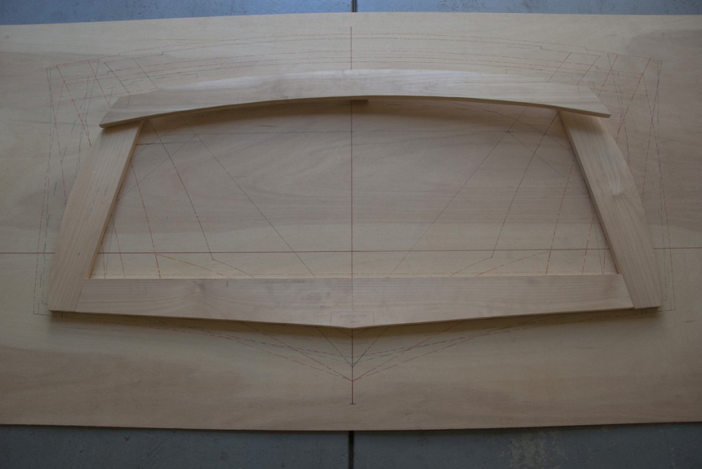

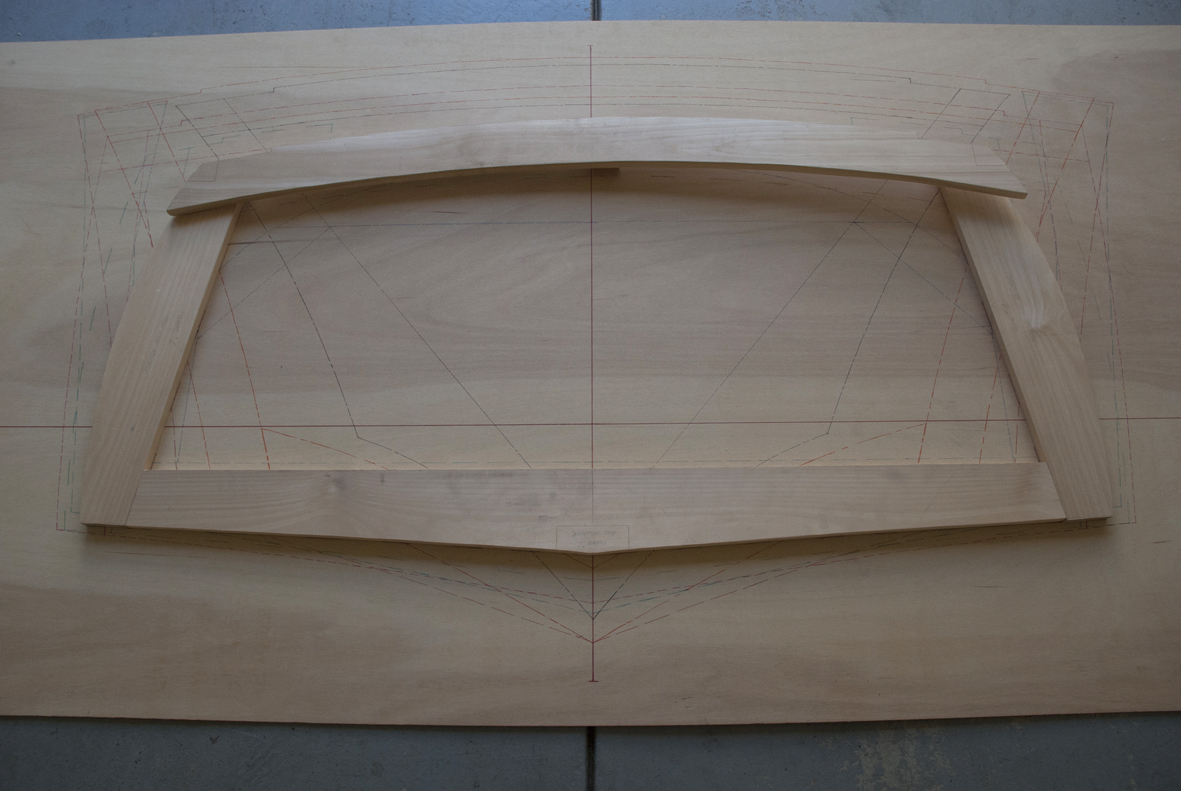

Transferred all frame outlines to set up board in individual colours for each of the frames plus the transom.
February 2012

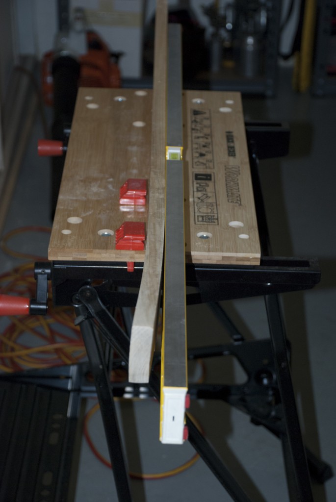

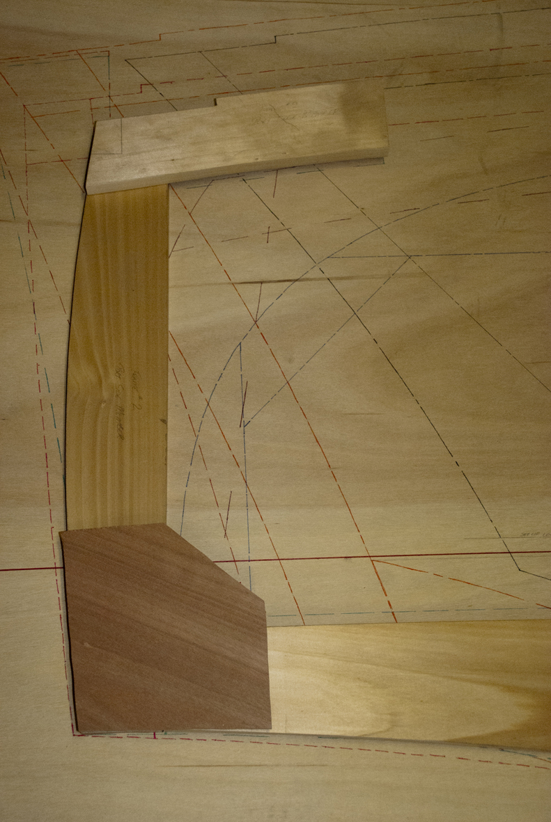

Collected timber from the supplier. Lengths to be used in the setting out of frames #1, #2 and partial members for frames #3 and #4. Transferred full sized frame member patterns to timber sections. Commenced cutting out frames with jigsaw, finer shaping to be done with hand planes. The first two frames completed.
One section has bowed significantly after being cut, but I’m hoping steaming will straighten it out.

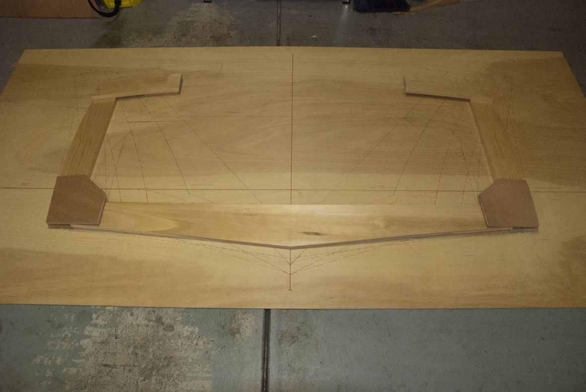

Collected 12mm marine grade plywood. Two half sheets. Made up gusset templates for all 6 frames, and laid out full set for each frame. Total of 24 gusset pieces altogether. Cut out each of the 24 gussets individually, and hand planed the straight edges ready for glue up and assembly. Outer edges will be faired to match after glue up is completed. Made up patterns for floor timbers, frames #6 & #7.
