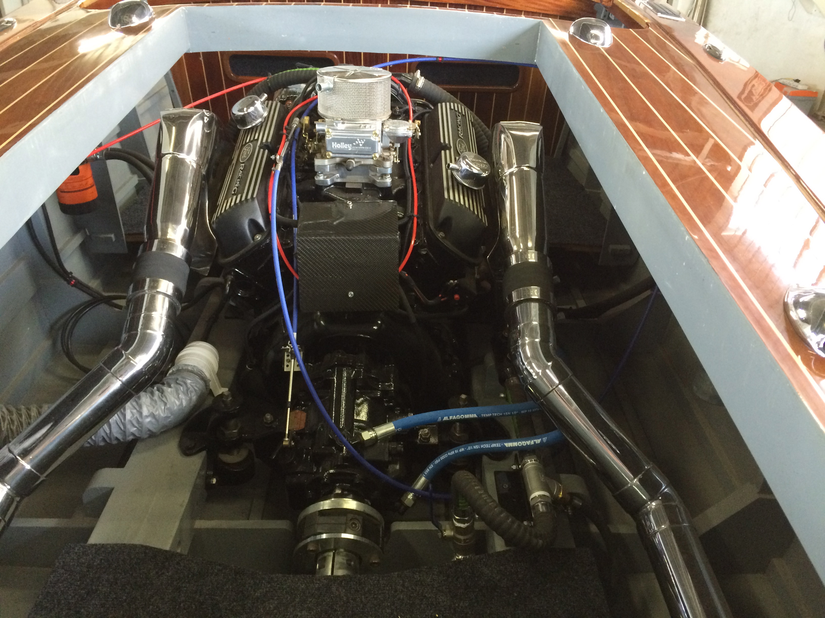

Just a few pics of my Barrelback which I completed in October 2015 using Glen L plans. The boat runs a Ford pcm 351W engine which I built from the ground up.The steering is hydraulic which in retrospect was overkill but nice to have.I also fitted a hydraulic engine hatch lifter which makes small adjustments a breeze

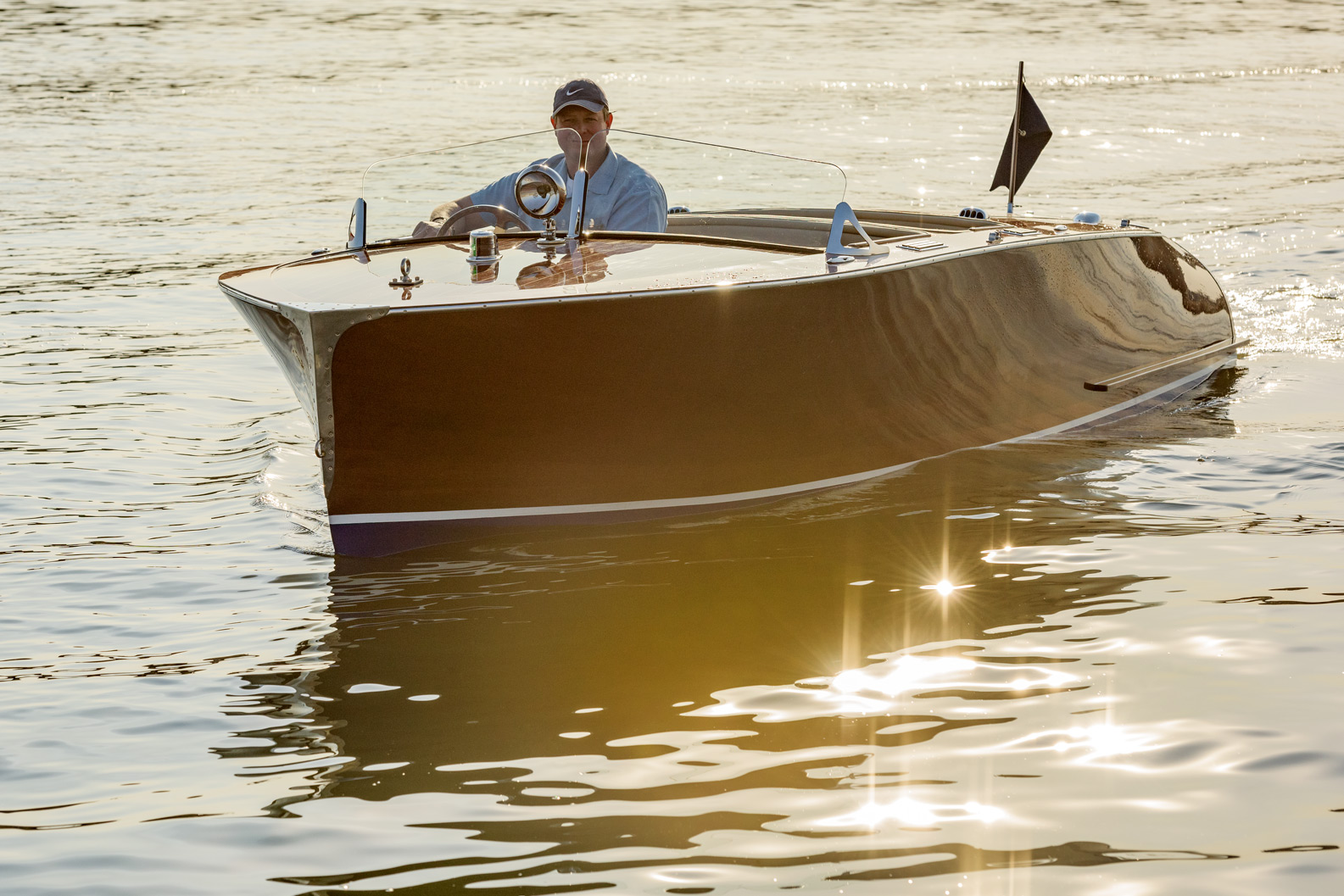

She was a little heavy but still performs well
The headers were from Hitek Marine Australia as this is the only chap who gives a five year warranty in salt water.

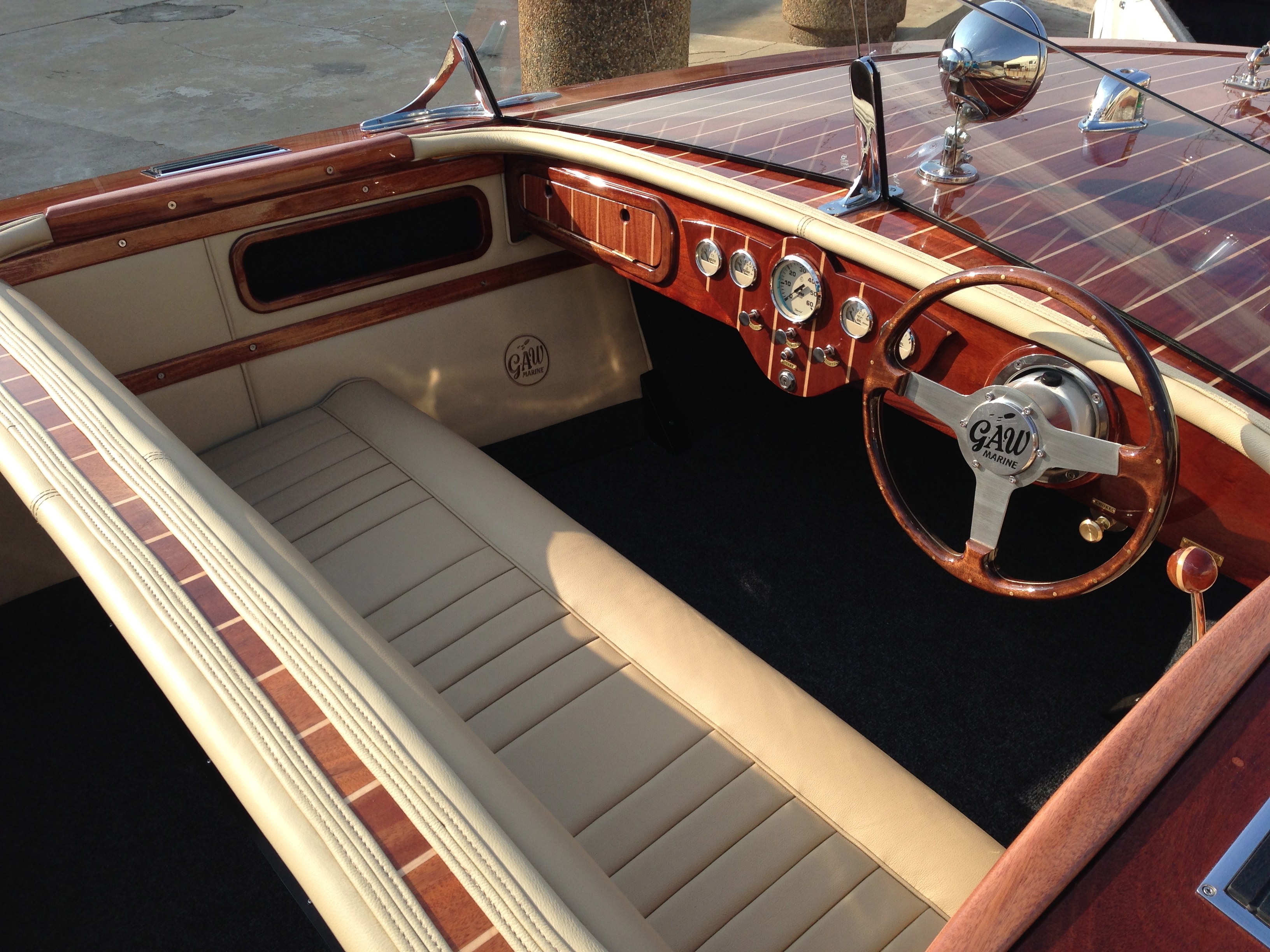

The seats and side panels were done in leather and the clock cluster is removable to access the wiring which is all silicone.

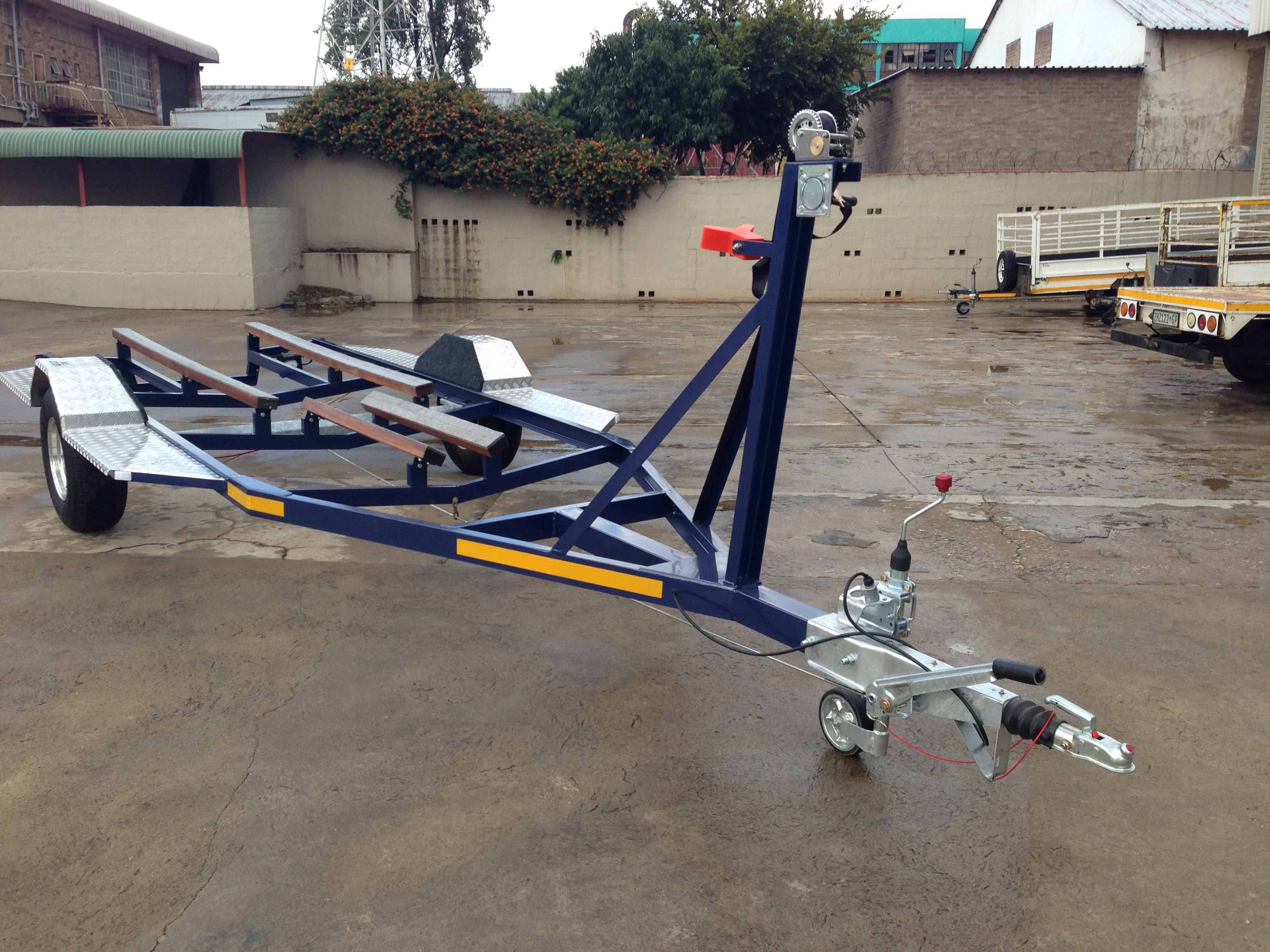

The trailer is also Glen L plans which worked out well with a few minor modifications.
