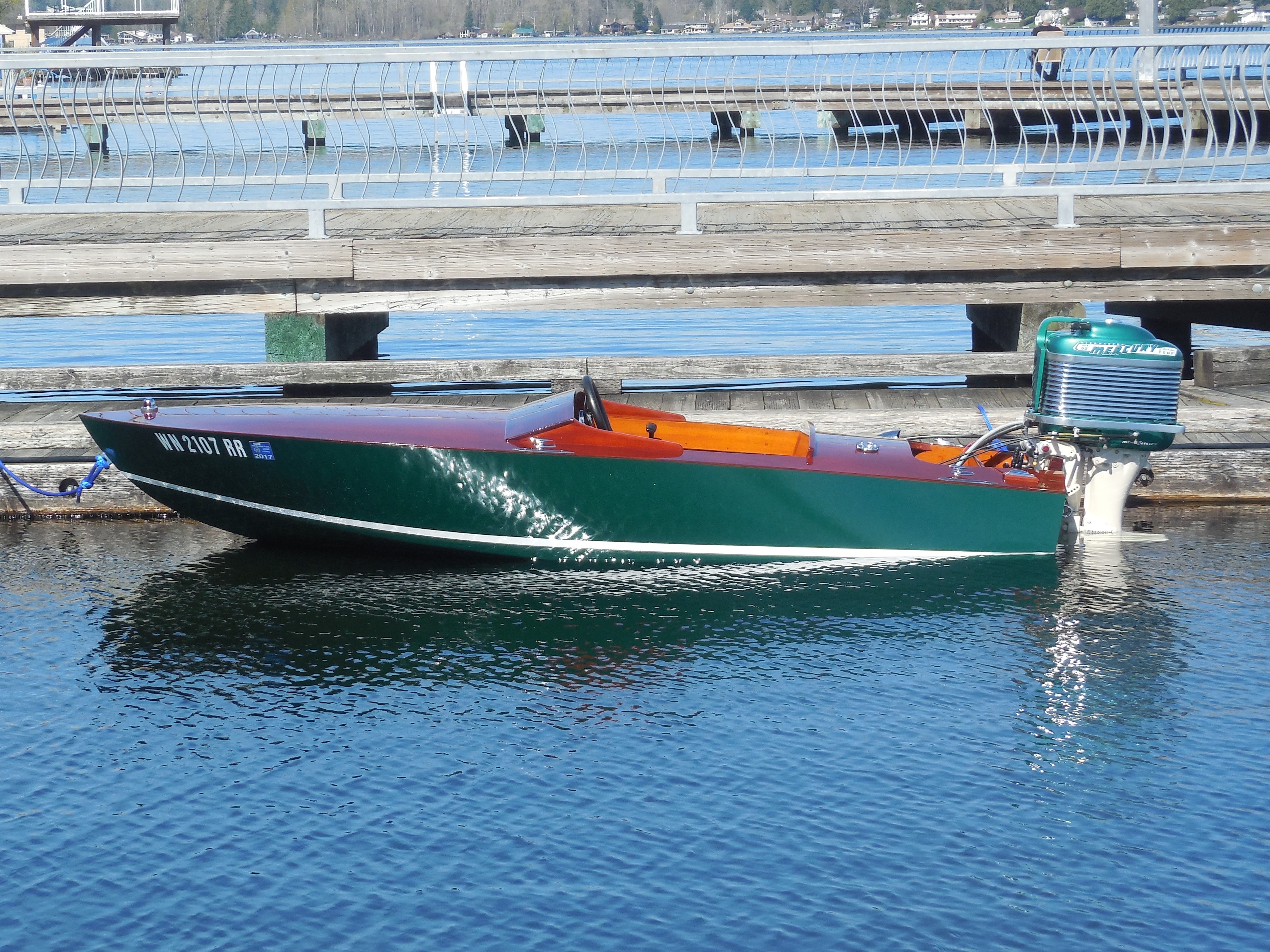

The Squirt was stretched 15 inches by means of adding 5 inches to each frame bay. The stem was lengthened 5 inches where it bolts to the keel. At the time we didn't know that Glen-L does not recommend this, so as they say, ignorance is bliss. But it seemed to work out okay. The frames then looked a bit far apart, so we beefed up the keel, battens, chines and sheer members a little. We opted for the 3/4 inch plywood transom, instead of 1/2 inch and made the top transom frame member one piece side to side. The coamings, as designed, lend a lot of strength to the transom, but even so we added a small upside down transom knee on each side at the sheer, and also a small splash well.
The smallest built-in type gas tank readily available is a Moeller 12 gallon plastic one. It's behind the seat with a filler cap on the deck, and it feeds the engine thru a Racor filter/water separator. Twelve gallons is a bit much (72 pounds) but it doesn't have to be full. The marine starting battery weighs 43 pounds and is mounted at the forward frame with extended cables. Lighter batteries are available, but this one at a forward location helps a lot in preventing porpoising in this tiny boat. It has Teleflex rack and pinion steering with a Glenwood racing wheel. The steering cable cannot make the bend at the dashboard, so the cable is extra long and loops around under the front deck. Teleflex steering cables will not fit the tilt tube of old Mercury outboards, so there is a steering tube attached with brackets to the motors tilt tube.
The motor is shimmed up to a transom height of 16.5 inches per the Mercury handbook. The first tilt pin hole gives a little nose down trim, and the second a little nose up, so neither is parallel to the boat bottom. So far, we have only run it with two adults on board, combined weight of 280 pounds. In smooth water with half fuel, and the first tilt pin hole, it rides very nicely. But it's right on the edge of porpoising. Any small swell or boat wake will start a gentle porpoise, although that improves with fuel burn off. If it begins to porpoise, it can usually be stopped with a little speed change. Top speed is 38 mph now, with a 12-pitch bronze propeller. The Mercury prop slip calculator says we can get a little more speed with higher pitch in the prop. But that's a problem with vintage Mercury motors; it's hard to locate the right propeller. The Squirt takes light chop pretty well when slowed to 20 to 25 mph. As it slows below planning speed, the following wave does not wash over the transom, as I thought it might. And at rest or moving slowly it is much more stable than I would have expected. But it should be confined to fairly protected water. Linda says it is probably a good thing that I was not turned loose in this boat when I was ten years old.
