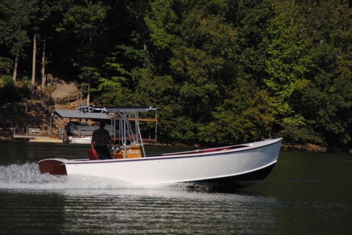

In looking for photos of the author of this article, Ken Schott, I came across a great interview we took of him back in 2011 about his Double Eagle build--great action shots of his boat too: http://boatbuilders.glen-l.com/978/wooden-boat-interview-double-eagle/
Ken Schott's Double Eagle from the 2011 Gathering of Glen-L Boatbuilders in Tennessee.
