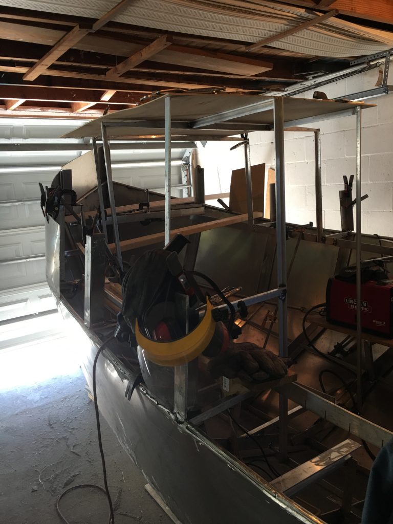

I left off with pics of making a bulkhead for the motor well. I put a full bulkhead across frame one. Then the two side walls to complete the well. Frame one will also serve as the motor mount. I'll need to put wood on both sides to mount the outboard.
Going back a little further... Once the hull was righted, the building support frames are removed and the final cross frames for each frame are installed.
The frames have to be leveled in their new locations. I used a laser light to mark the side frames, clamped the new thwart frame, then welded. After getting a couple of frames in, I moved the welder and gas into the boat for better control.
The rest had to be assembled on the side.
I used the ply to show how the windows will fit. There are two windows on each side.
