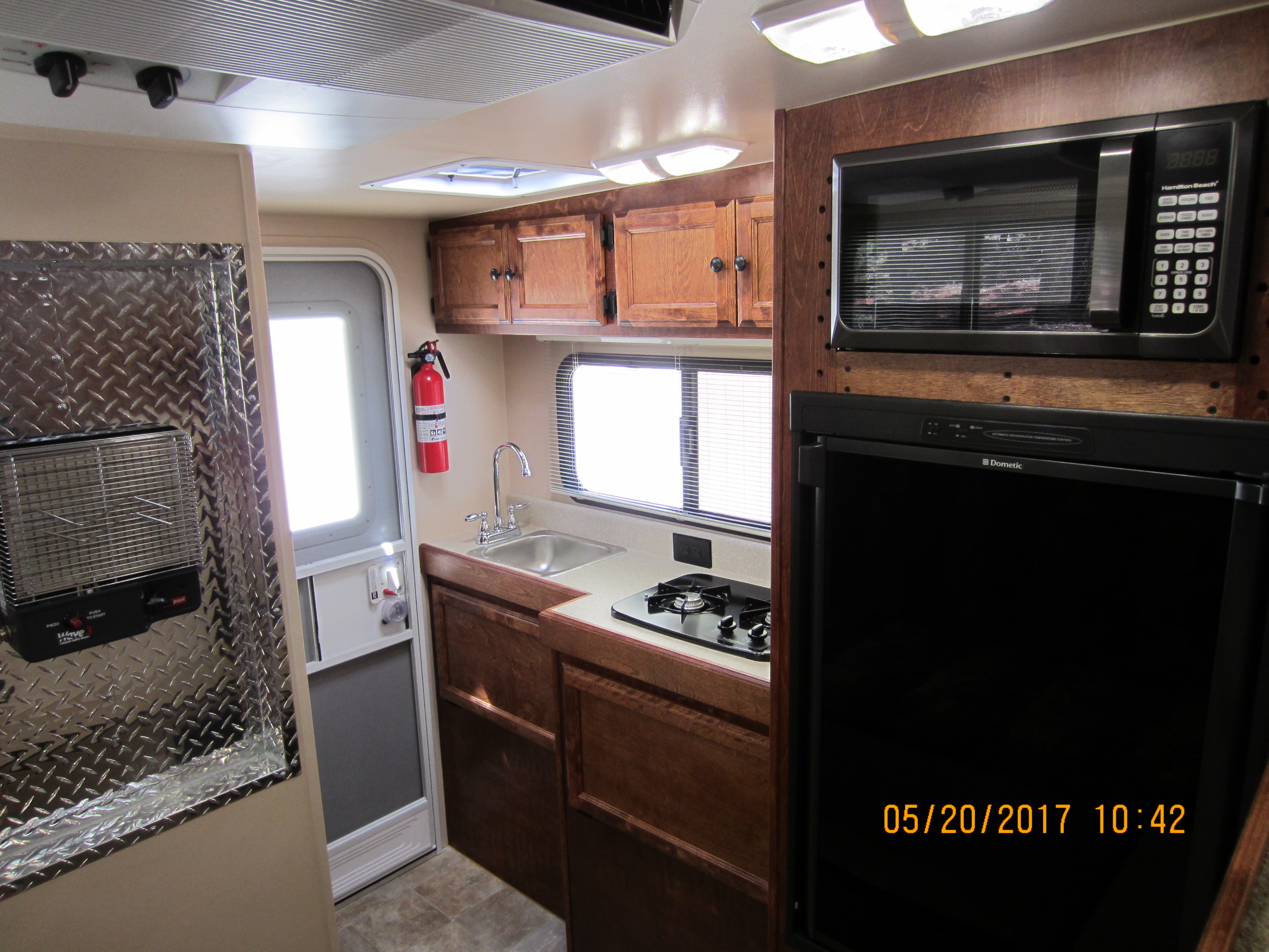

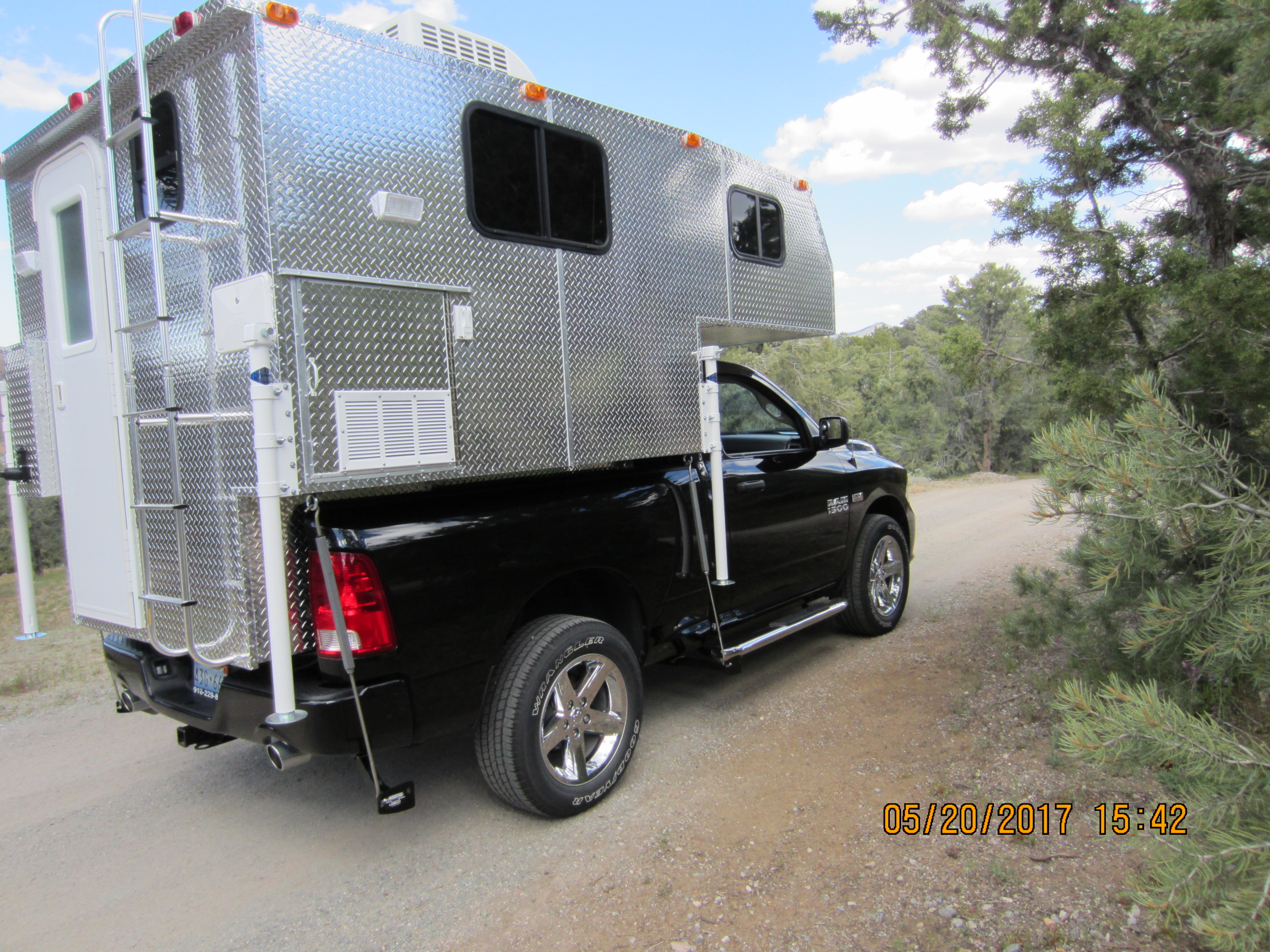

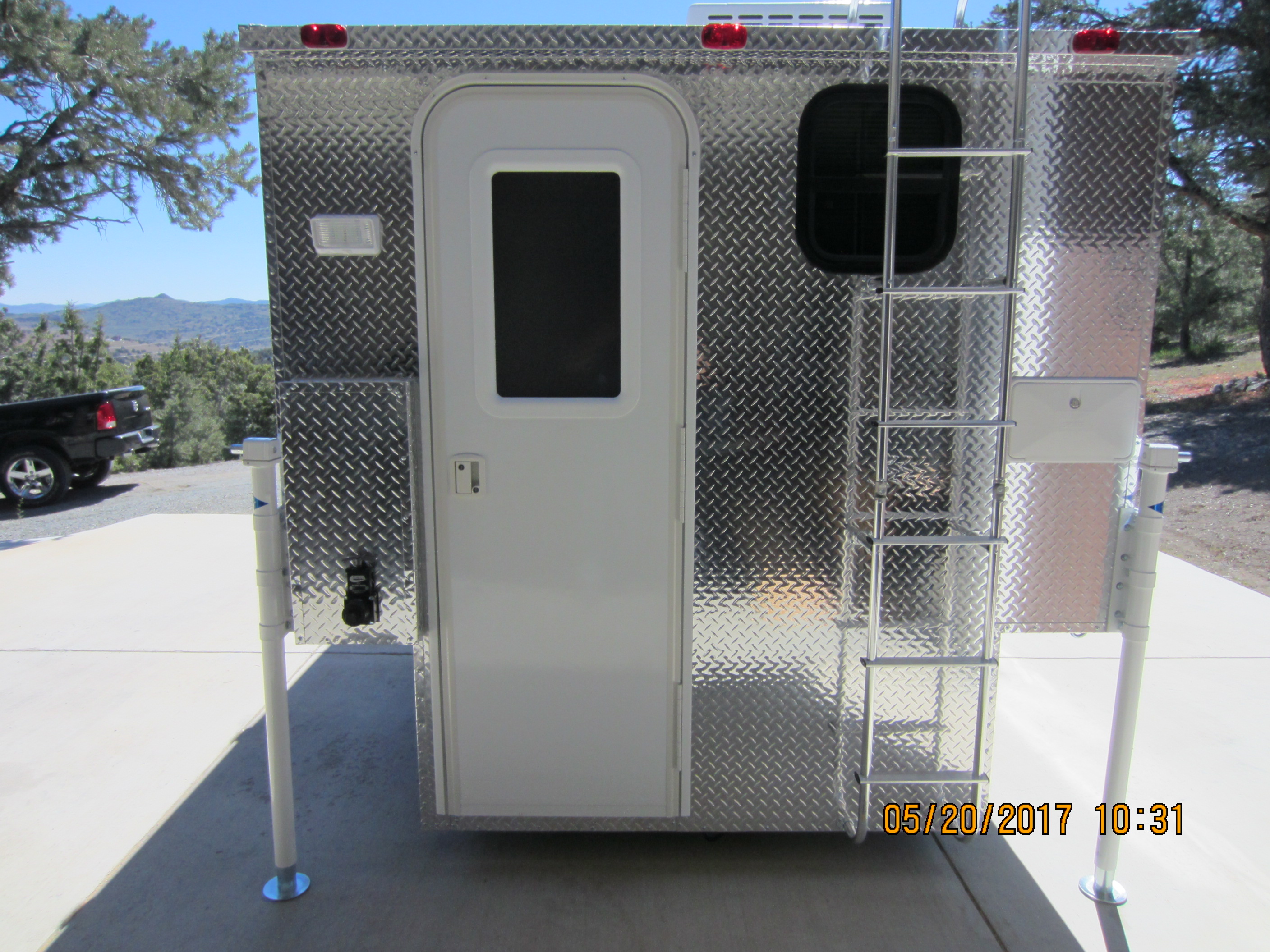

I thought you might be interested in my finished project. I ordered the Acapulco plans but modified them for a short bed truck as well as other features I desired. I have a construction / carpentry background so I framed the unit in a weekend but things slowed from there. Since I did lots of modifications to the original plans, it took lots of contemplation and work to fit in all of the appliances and features I wanted. The overall project took me about 6 months to complete. I finished in May 2017.
Acapulco built by Norm Stevens
This camper is fully self-contained including heat, AC, large refrigerator, microwave, stove top, sink, self-contained portable toilet with its own water supply reservoir and its own black water tank, outside shower and (4) Rieco Titan 2,000 lb each screw-type jacks.

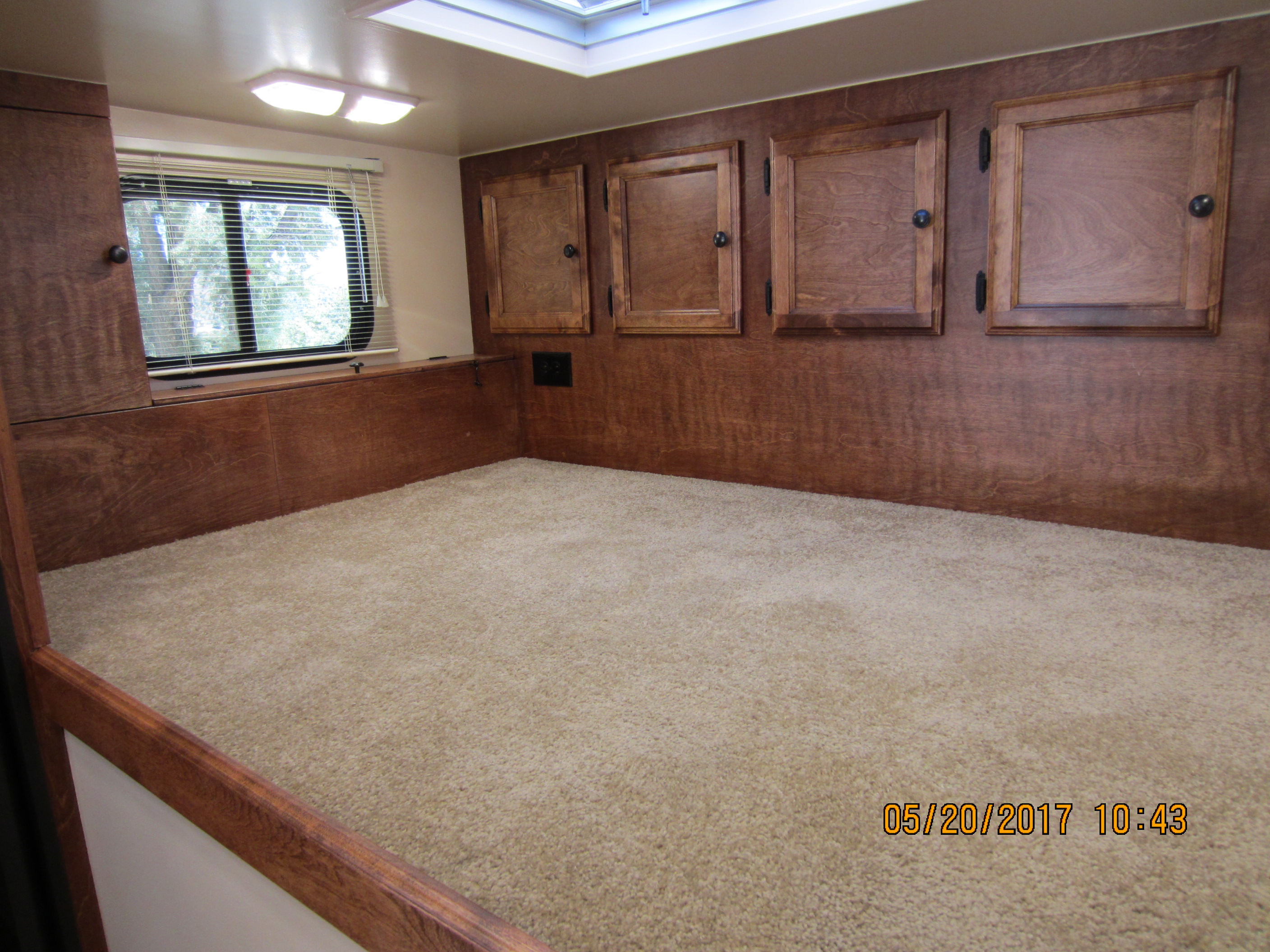

All framing was screwed and/or tapped and screwed depending on the application and various wood glues were used. This camper is super solid and built very very well. Much better than factory built units where they use nail guns, automation and fast paced production requirements. All of the interior wood is birch and/or birch veneer.
Walls are painted in a universal and pleasant beige, the cabinets were hand stained, the main floor is quality linoleum, and the steps and bed area are covered in carpet. The bench seat is professionally upholstered with a zipper so the covers can be removed and laundered.
The windows are black frames with tinted glass and custom built mini blinds for privacy. The walls, ceiling and floors are all insulated very well with quality hard board-type insulation. This unit maintains its desired temperature very well. Exterior siding is polished aluminum diamond plate over 1/4" exterior grade plywood for strength. Again, this camper is super solid and built very very well.

- Dometic RM2451 4CuFt 2-way Refrigerator (propane and electricity which the fridge will automatically pick depending upon availability and priority)
- Hamilton Beach 900 watt Built-in Microwave oven
- Camco Olympian Safety Wave 3 propane heater (designed for use at high elevation as well as sea level)
- Advent 13,500 BTU roof mounted AC unit.
- Atwood 6 gallon propane water heater--Manual light
- 10 gallon fresh water tank
- Water inlet with direct hook up or fill-and-go neck (two different options)
- 9 Gallon grey water tank with easy access discharge
- Dometic 970 series portable toilet with its own fresh water holding tank and black water tank
- Flowjet 4406 12v water pump
- Stainless steel bar sink with pivoting, tall neck faucet for easy access/use
- Suburban 2-burner propane stove top
- WFCO 30 amp electrical power and inverter system with three 15 amp breakers for plugs, lighting, charging. One 20 amp breaker for the AC unit. And (4) 12 volt fuse breakers for 12 volt system. 25 ft 30 amp power cord and adapters included
- High Quality Safety Detector (detects propane and smoke)
- Fire extinguisher
- Bed area has an emergency escape hatch which can also be used as a large roof vent
- Kitchen area has a roof vent with a 12v fan
- Screen door
- Custom mini blinds
- (3) exterior porch lights at the door and at the equipment locations
- 20lb propane tank
- Battery (charged by the inverter power center and by the truck when truck is running)
- Exterior shower (includes hot water)
- (4) Super heavy duty Rieco Titan 2,000 pound capacity (each) manual screw camper jacks
