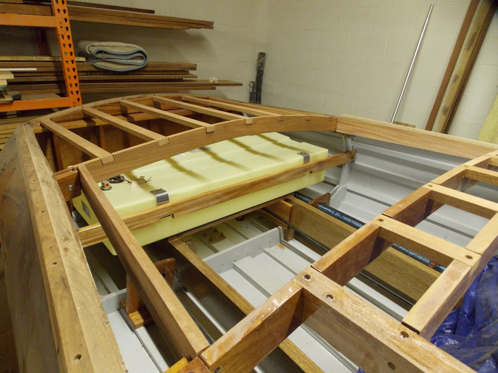

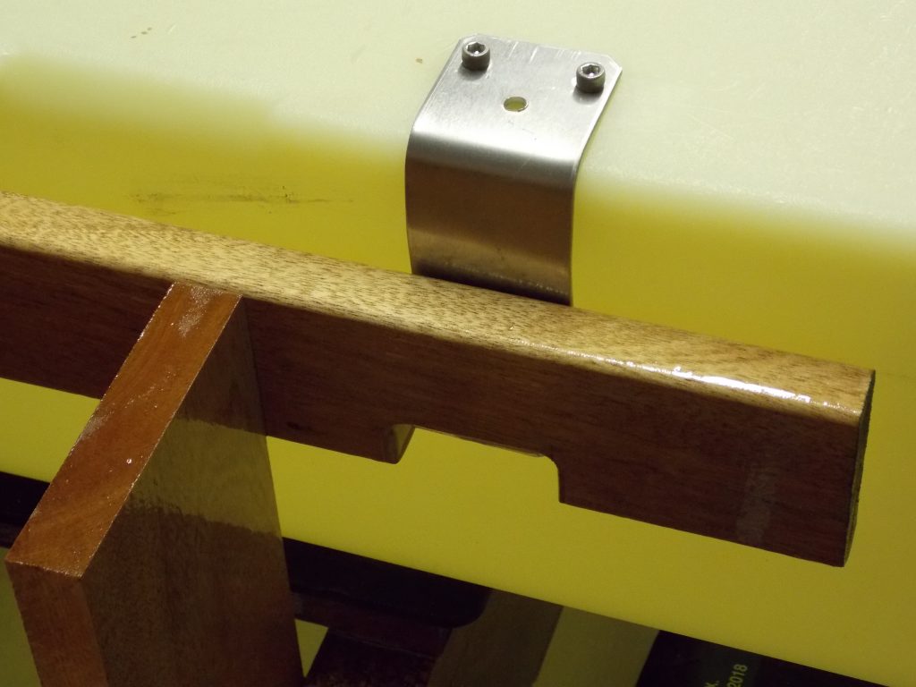

November 1 - November 30, 2019 - Started installing the gas tank. I ordered a Moeller 25 gallon inboard gas tank with the mounting clips. The clips secure the gas tank from moving but allow for expansion of the tank. I added tank supports to the motor stringers to support the tank. The tank mounting kit comes with adhesive rubber foam strips that were applied to the tank supports. Made a mahogany frame to secure the aft side of the tank mounting clips. The tank rear bracket was positioned to allow a straight mounting bracket to be used to secure the front side of the tank. The front tank bracket was bolted to the hull #2 hull frame. This will allow the bracket to be removed and allow removal of the tank if needed. All of this will be behind the rear seat which will also be designed to allow removal.

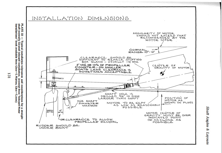

October 1 - October 30, 2019 - I ordered the propeller shaft from Glen-L. I used the drawing from their website to calculated and verify the length of the shaft. The shaft came well packaged in a wooden box. It was now the moment of truth to verify all the measurements. I slid the propeller shaft up thru the strut bearing to the motor. NOTE: Spraying the shaft with water helps slide the shaft thru the strut bearing. I also ordered the transmission coupling flange from Glen-L to mate the propeller shaft with the Borg Warner 71C transmission. The motor was located within an eighth of an inch of where it needs to be. I mounted the coupling flange to the propeller shaft and slid the shaft up the mating transmission flange. There is a pilot on the transmission flange and a recess on the propeller flange.
The motor I purchased came with the motor mounts attached. The mounts allowed for side to side adjustment of the motor as well as up and down. Each of the 4 mounts allowed side to side and up and down movement. I loosened up the mounts and moved the motor from side to side and up and down to allow the propeller shaft to engage the transmission pilot without moving the shaft significantly from side to side. Once the shaft flange pilot was engaged in the transmission flange but not fully seated, I used a feeler gauge to measure the gap between the propeller shaft flange and the transmission flange at 90 degree intervals. The gap measurements should be within .0015 of each other at each 90 degree interval. I moved the motor a little at a time until the flange gap measurements were within the .0015 measurement. This process took a few hours to complete. I then proceeded to lock down the motor mounts. One final check of the gap and it was good to go.

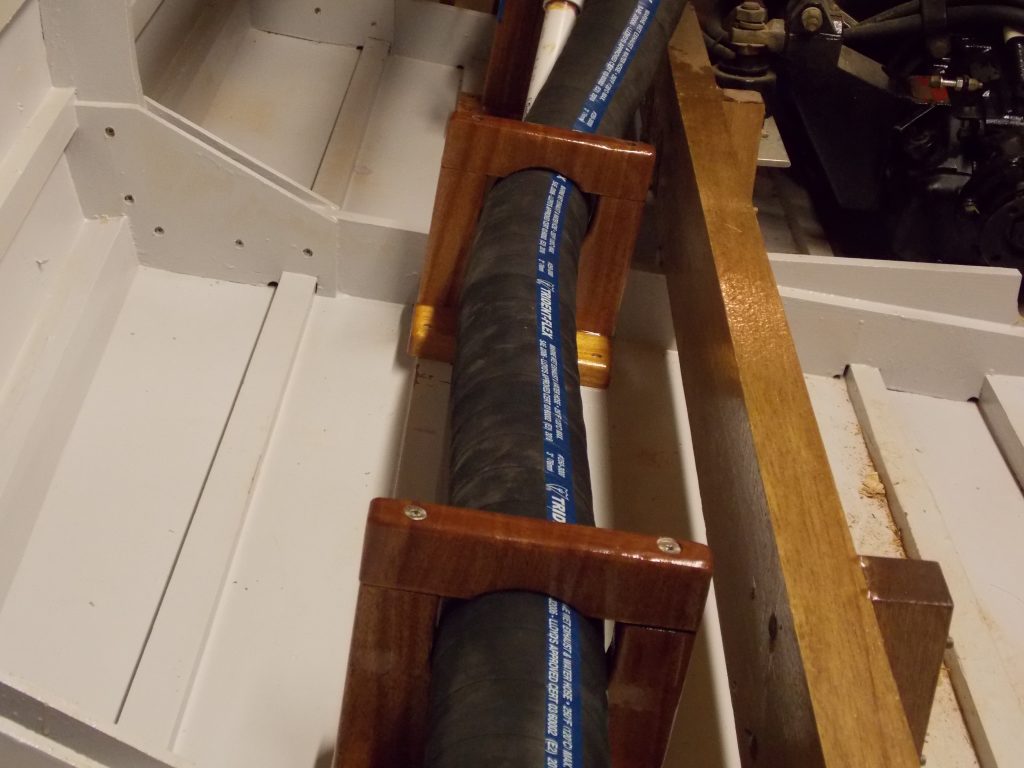

July 1 - August 30, 2019 - Ordered the exhaust hose and the exhaust thru hull fittings. I ordered the thru hull fitting from Buck Algonquin because the mounting flange is at an 8 degree angle which allows the exhaust inlet and outlet to be straight and not angled due to the curve of the transom. I used a 3-1/4 hole saw to drill the holes thru the transom. A lot of checking and double checking here before drilling. I located the exhaust fittings just above the water line (I hope) and opted not to use baffle mufflers (A boat like this should be heard :-)). The exhaust fittings are not permanently mounted yet, as I want to complete the final epoxy and varnishing of the hull before permanently mounting and caulking in place.
Made Mahogany exhaust hose supports. There is probably a better way to do it, but I like the look even though it won't be seen.
