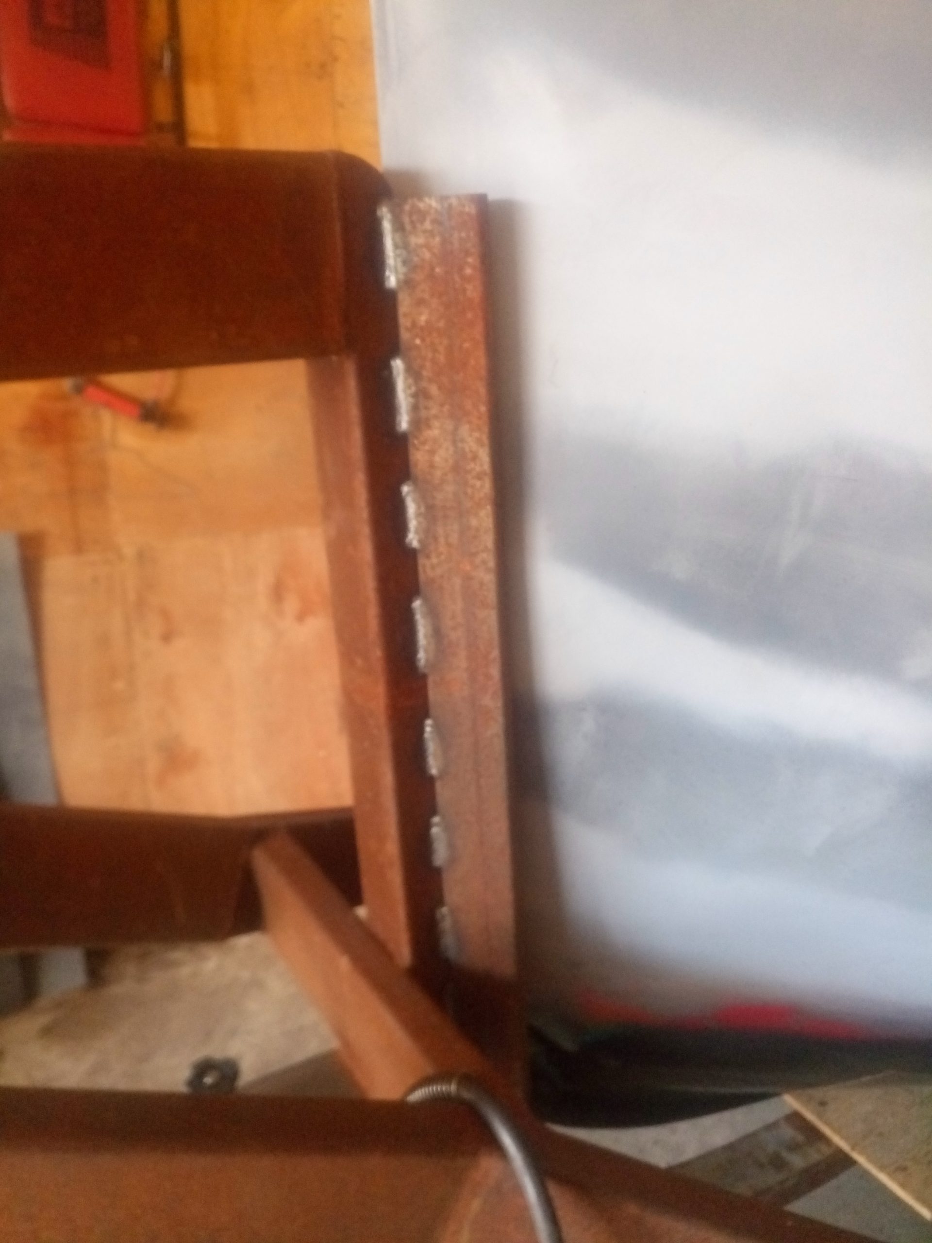

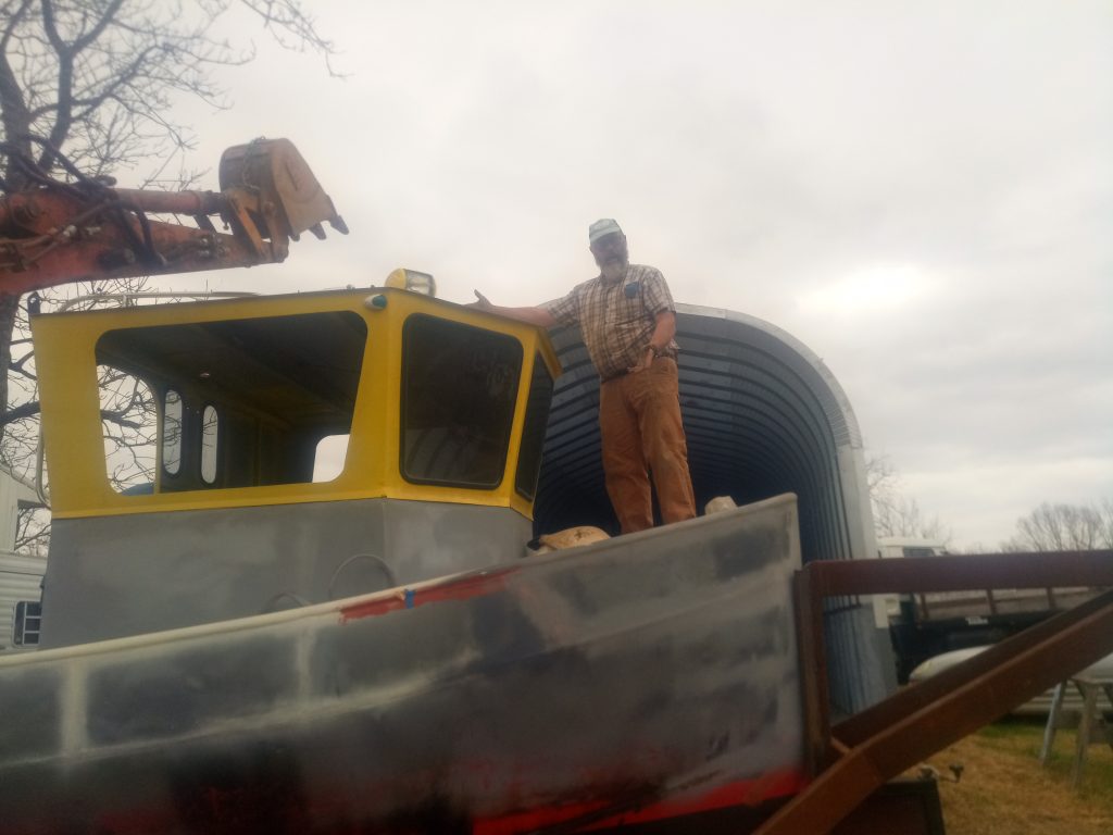

Checked the alignment from the original calculated points. There is sufficient flex in the frame to accommodate the difference, and there will be a 1" neoprene pad that goes between. After confirming the stem and bow alignment, I added 1"x 3" rectangular tubing for capture guides. They will get the neoprene pads after the trailer is sandblasted and painted.Almost done transferring from the stocks to the trailer. And I have to remove those exhaust stacks...Note: The lower units are removed during this process. It gave me a place to put chocking.Building bunk framing to fit the hull. Covers will get installed after painting.Alignment is close enough, I know the owner... and the keel-cover here will get installed after paintingThe "de-pyloned" wheelhouse structure ready to be set.Starting to extricate the tug-laden trailer from the little bay it has been built in...With the guiding assistance of my daughter "she" is half -way out.Fully clear of the internal obstacles. Note there is still a lot of finish work to be done.A friend stopped by to help guide the superstructure onto the wheelhouse base."I know I built this on a matching jig, I sure hope it is still in alignment...""See ma, I told you it would fit... What were you worried about?"
My little excavator was maxed out to reach up that high in the setting process.

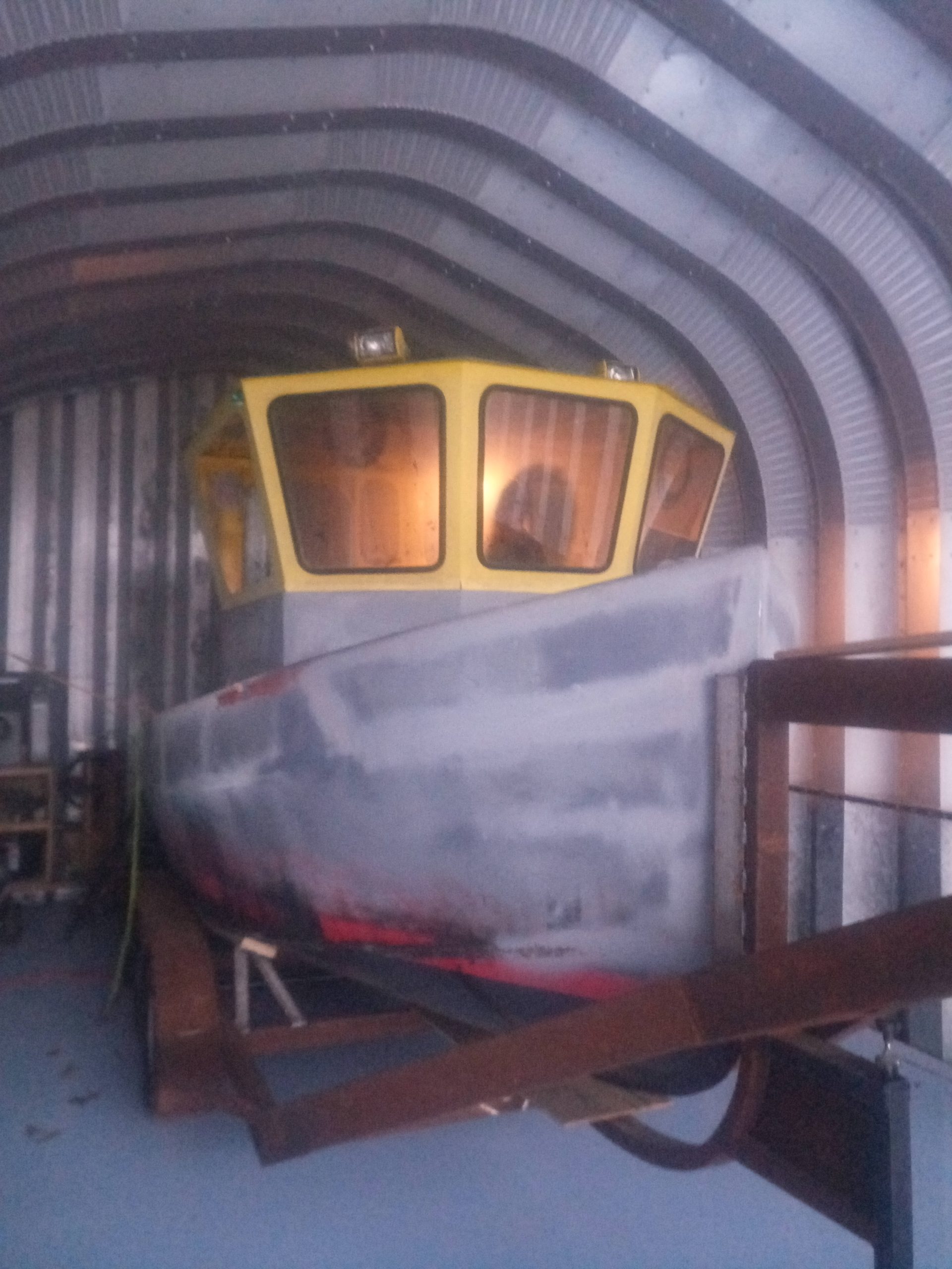

"Fun-photo" time- Is it a "selfie" if my wife takes it?"I am so happy since this is such a large transitional step for my creation.And I have to give credit to my dear daughter Faren. Even though she is a major stroke survivor, she was invaluable in guiding me out of Building 1C.And I just had to see for myself, I really am not able to budge 1 1/2 tons of boat even an inch...Ready to pivot 90°and back into the cathedral.I had to use my loader because I still have not finished the telescoping part of the hitch and the loader was more agile.At rest in the back of her new home.started rigging temp power, air and lighting to get back to work on her.And as all good things do, work went on into the night. Super structure brace cut out of the hatchway, and bolted down.
One of the next jobs will be to cut off the extra foot at the top of the pylon to make it more functional and aesthetically pleasing, (as well as make it able to fit in the cathedral). Then there will be the exhaust cover, etc.
The lower back part of the pylon also houses the dual genset exhaust stacks.
So, before I can make much more progress, I intend to hang shop lights in the cathedral and some of those clear vinyl strips for a flexible front door.
