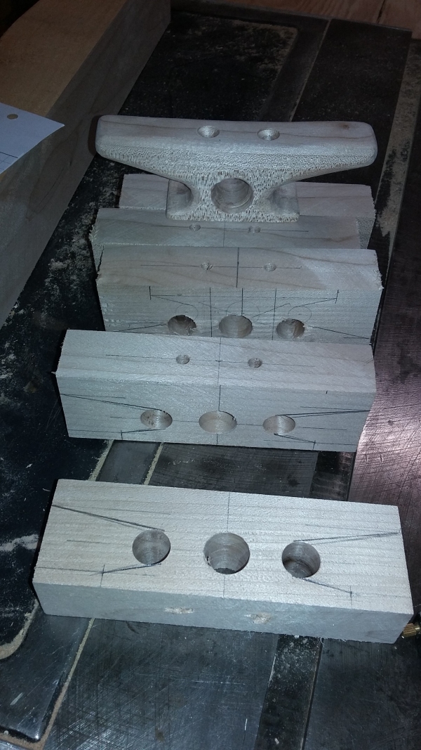

Using well seasoned or kiln dried wood, cut the cleat blocks to the Length, Width and Thickness desired for the rope being used. For best strength, the grain should be at right angles to the bolt holes.
Make a full scale template on graph paper of the side view and the top view. The only items you need are a base line, a center line, the overall length (A), the rope seat center and height (B & D), the safety hole height (M) to position all the holes in the correct position.

Position the template on your block(s) and using a sharp point, like the point on a drawing compass, transfer the drilling points to the wood. Drill the holes. For the bolt holes a brad point drill is recommended, and for the side holes, Forsner bits are recommended.
Layout the cut lines
Two cuts are needed on each end of the block, from the top of the rope seat hole to the bottom of the horn, and from the bottom of the rope seat to the top of the cleat sole. Scribe the lines and cut on the side nearest the middle to make a nice transition between the rope seat hole and the body of the cleat.
Rounding edges and shaping the horns
See Notes on Bending Radius of Rope
A rasp and a rat tail file are good, but a drill powerd rotary rasp roughs out the shape quickly and finishing with hand rasps, files then sandpaper fairly quickly. The rope seat needs to have a really good radius so the seat contact area is almost a semi circle from one side to the other.
The top sides of the horns can be planed down and radiused quite aggressively with about a 1/2" to 3/4" radius. The top center area can be dished to 1/8" to 3/16" so the horns have an upward shape. This will help lock the running part of the single hitch or a slippery hitch.
