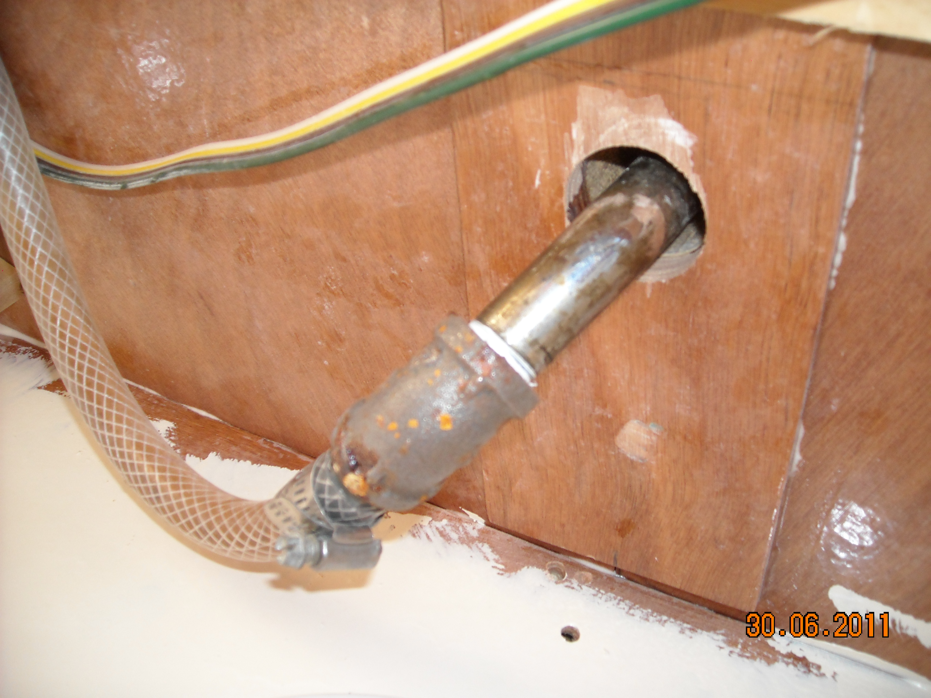

- Install a ½ inch through hull fitting inside the port seat in the forward centreline corner.
- Connect a long loop of plastic pipe from the through hull to a hose barb and then to a 45 degree strain relief. The idea of the long circular loop and 45 degree fitting is to create as large a radius as possible in the hose.

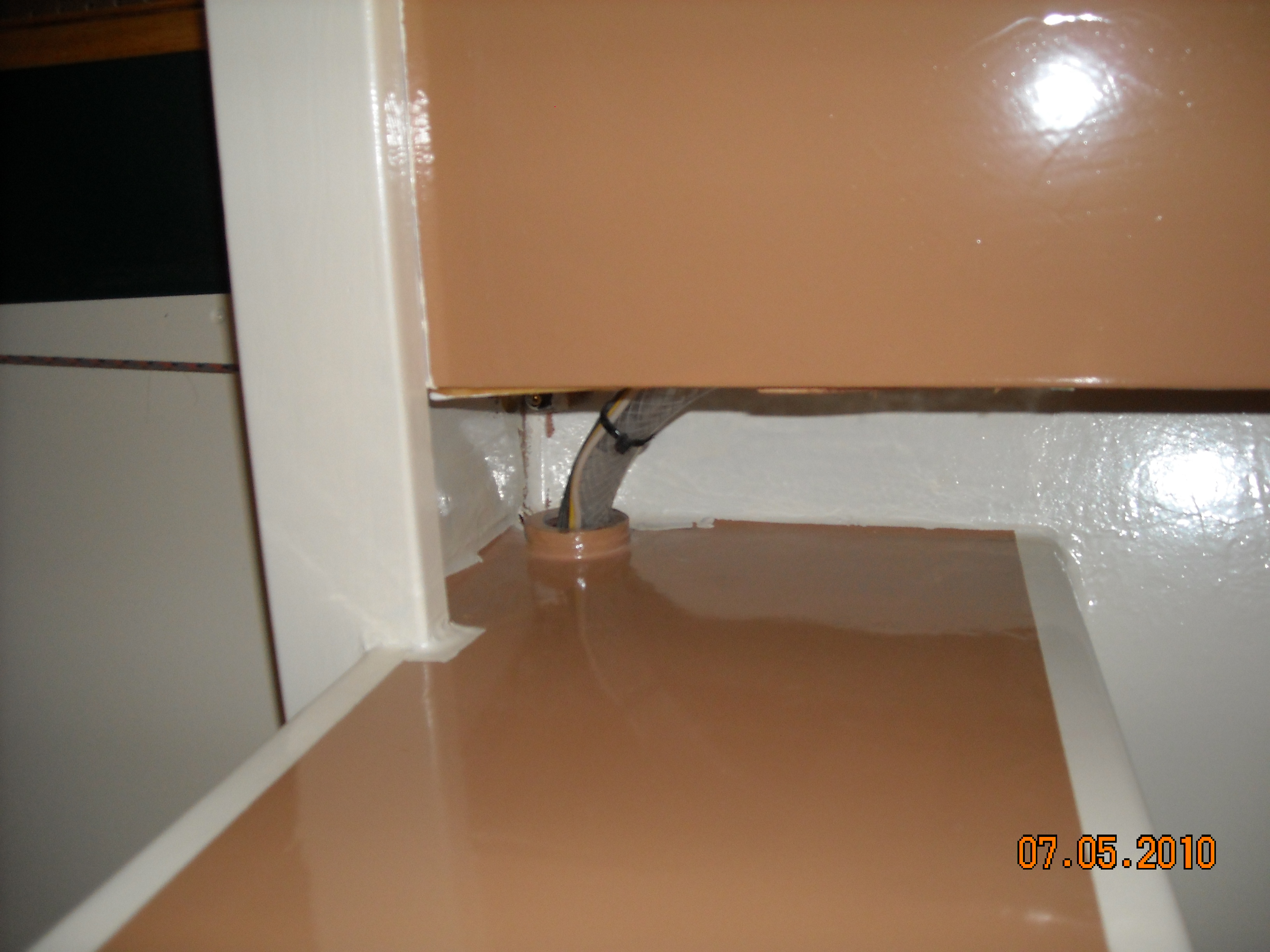

- To gain access to the seat for wiring and plumbing glue a ½ inch thick, 1 ½ inch diameter wooden washer to the top of the seat in the stern corner under the side deck and then drill a 1 inch hole through the washer. This arrangement will stop water from flowing into the seat, will keep the interior of the seat compartment dry and will allow easy installation of battery wiring and fire monitor plumbing.
- Thread the monitor hose through the seat top access hole and into the seat compartment

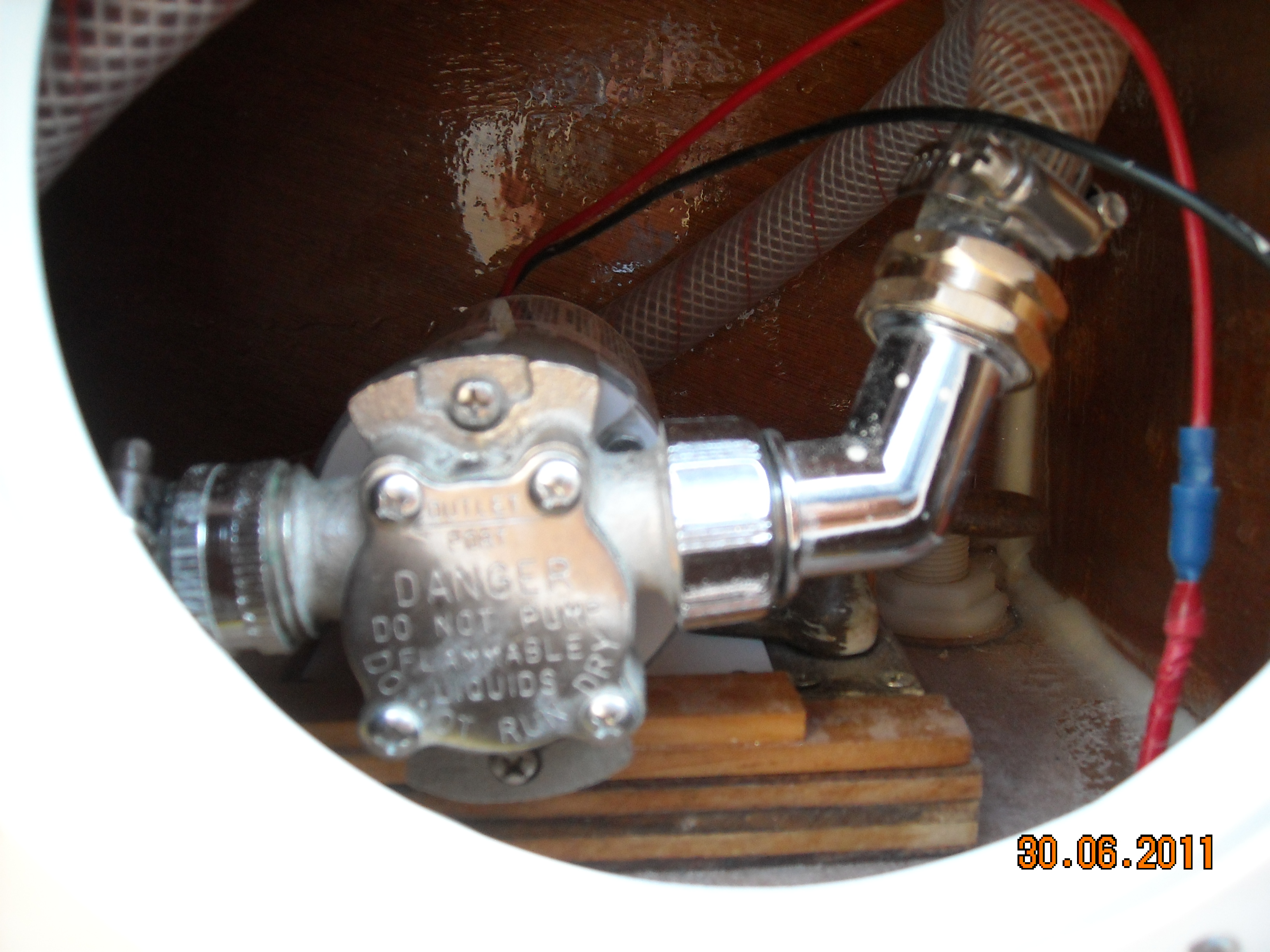

- Slip the pump into the seat
- Connect the suction and output hoses to the hose fittings on the pump

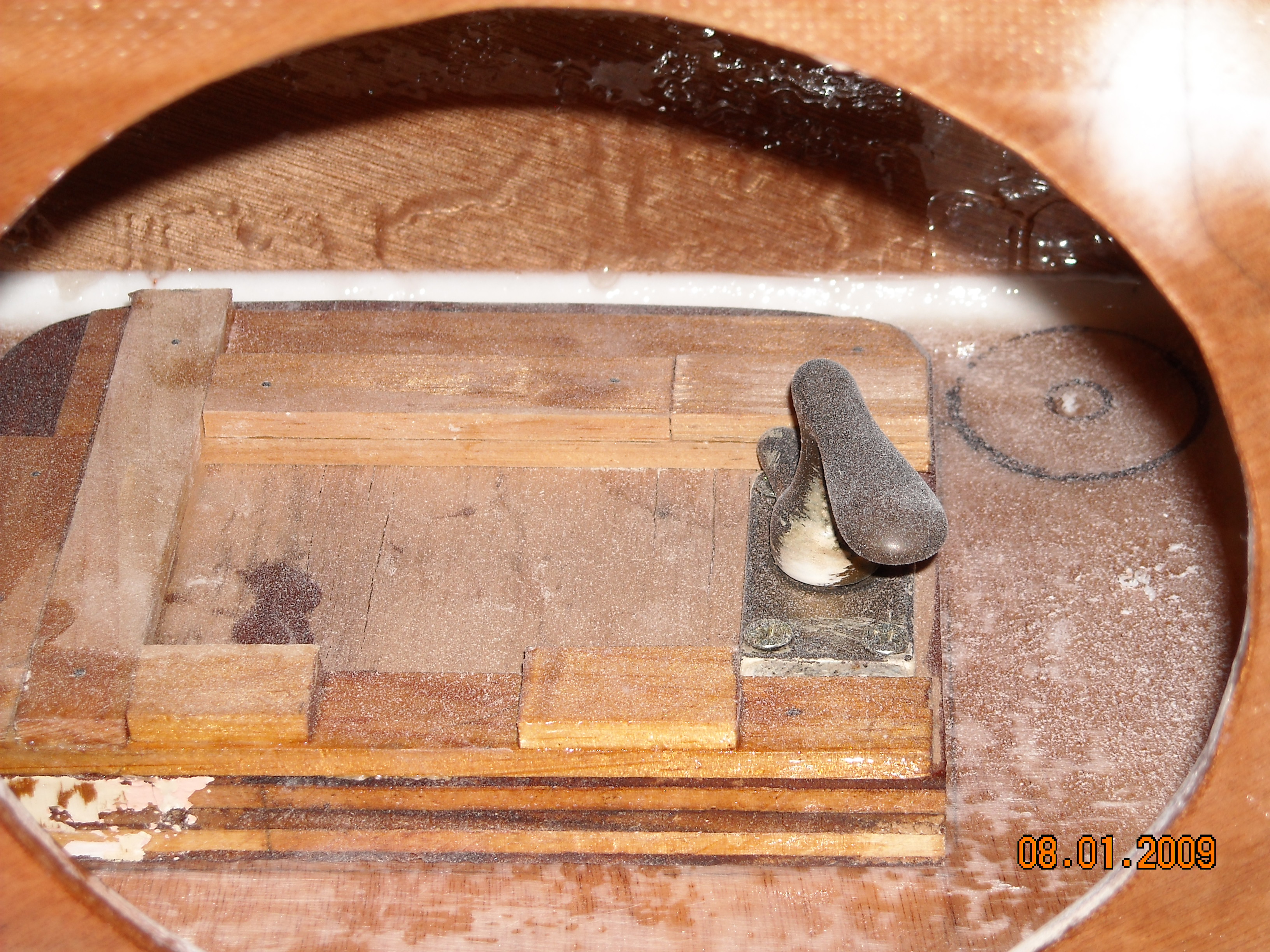

- It is desirable to cobble some sort of mounting system for the pump. Below is a photo of an old window catch used as an easy-to-use mounting.
