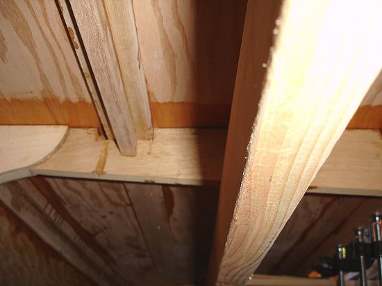

Mark Shipley added reinforcement to his bottom battens
There may be a void between the planking and the frames. You can fill that void by applying thickened epoxy to the edge of the frame to fit the contour of the planking. This will also provide protection to the exposed plywood edge. In addition, the frames should be coated with epoxy which will penetrate the wood and protect it from moisture.
